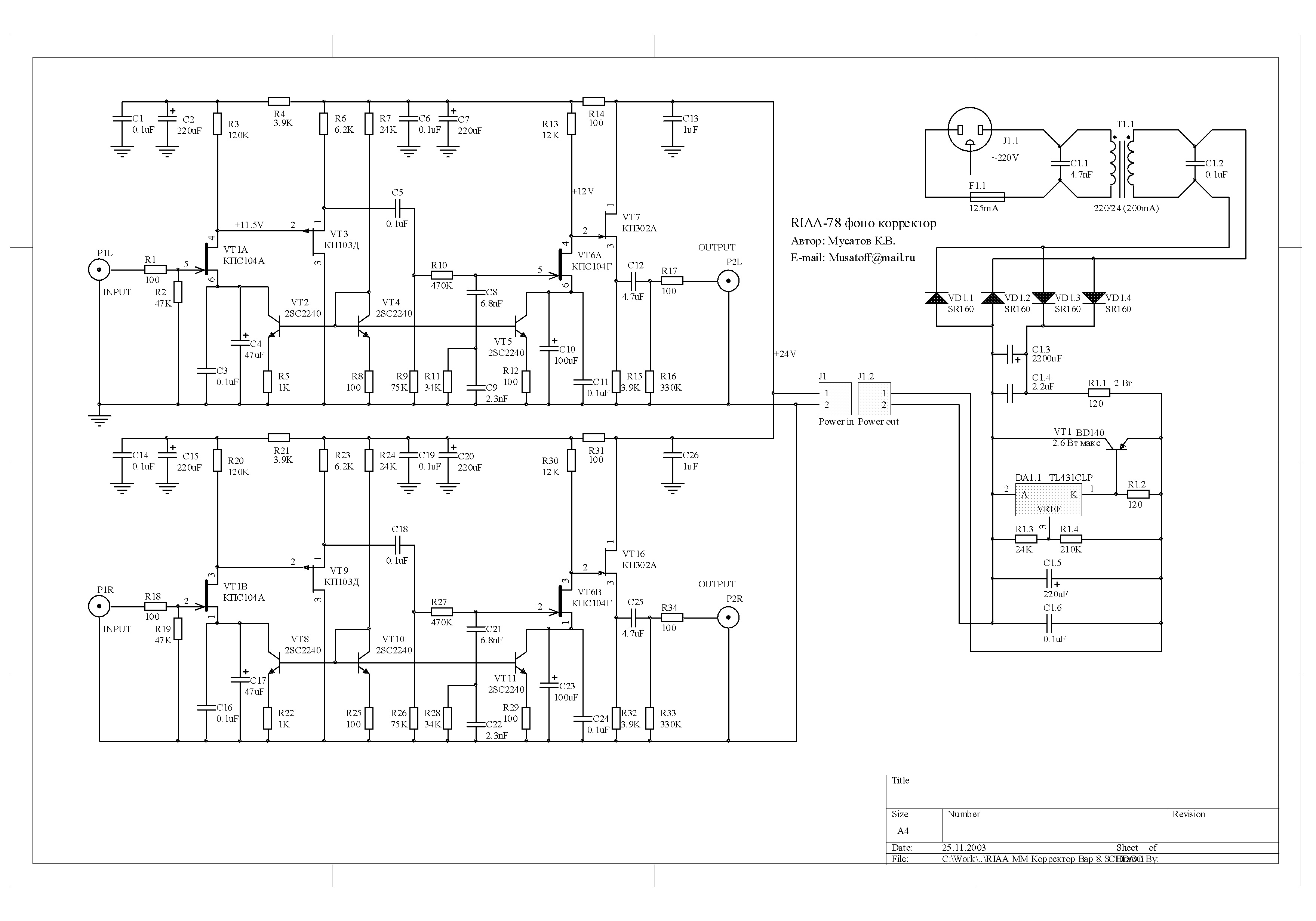

schematic:
I notice in the schematic that you have used:
* 20K Drain resistor leading into the RIAA section, and
* 2M2 shunt resistor on the 2nd stage Gate.
I have seen a slightly different version of this circuit which had:
* 240K Drain resistor leading into the RIAA, and
* 510K shunt resistor on the 2nd stage Gate.
Are you able to tell me what effect these values have on the circuit? IE.:
* is there a benefit in increasing the Drain res to 200K or 240K? 😕
(I can see this would probably reduce the signal level coming out of the RIAA - which is already low 🙂 ).
* is there a benefit in increasing the 2nd stage Gate resistor to 2M2?
Thanking you in advance,
Andy

schematic:
hi there Mad_K,
im very novice at building phono preamps and I want to try this circuit, what I find attractive about it is the simplicity, I do have a couple of questions however...
in one area, you have three capacitors paralleled and in another there are two, is there a specific reason you do this in terms of sound, or is it to keep the parts list simple?
also above the three paralleled capacitors, the resistor looks to be labelled "3k24" is this actually 3224 ohms or 3.2K ohms?
I was also looking to fit a simple valve buffer stage behind the circuit also, as I have a bit of a soft spot for them, however I believe that jfets have far lower noise than most valves... I was looking at a cathode follower, what is your opinion?
thanks for sharing this circuit!
mike
Hi Mike,
I probably can answer a few of your ?'s
3 cap's in parallel is to get a accurate value for the C, since the required value, is not a standard value that you can buy.
3K24 is 3240 ohms
A will leave opinions for using valves alone
Good luck building your jfet phono amp ckt.
3K24 is 3240 ohms
