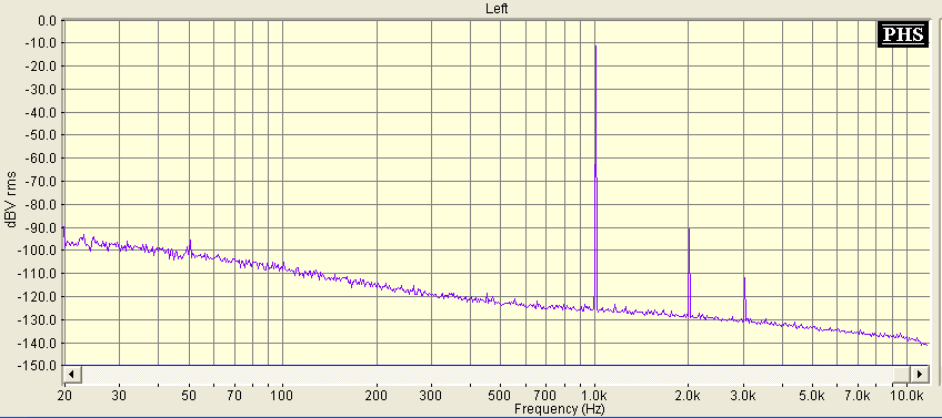

Now, how can I proceed? Trying a BC550C cascode to even lower the input cap or...
This is addictive and fun. 😛
Nice that you have found the FFT on view menu after clicking on analysis window and the proper input settings. Can't tell you how to better patch a Mad's Pacific, I never made any Maison's or Mad's Pacific. Your LT sim will let you try things I suppose. Its FFT looks optimistic at 0.25% 2ndH and suspiciously enough 3rdH VS 0.6% almost only 2ndH you measure non the less. Or you measure more 3rdH now too? As I wrote, the Simplistic gives repeatable results at 0.02% ballpark, or even 0.01% in my LowMC attached. You can look at my CCTs link I gave you before, for ideas.
1. Local feedback, gain control. 2. SE stands for single ended i.e. non symmetrical, not source to earth. 3. Weird circuit better don't make hit or miss changes. 4. Reduces bandwidth for some reason. Prone to oscillation with its BJT buffer drive could be.
