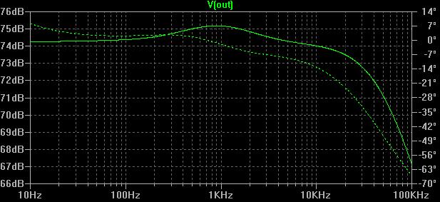

I used the values you gave me for the RIAA and as you can see, it is within 1dB but not very flat. You may want to tweak those values.
Ideally, I'd say you need to hit the 500mV mark at 1k with respect to gain. I'm using the peak values to calculate gain (salas, correct me if I'm wrong). Guess you preamp/amp will have to do more work.

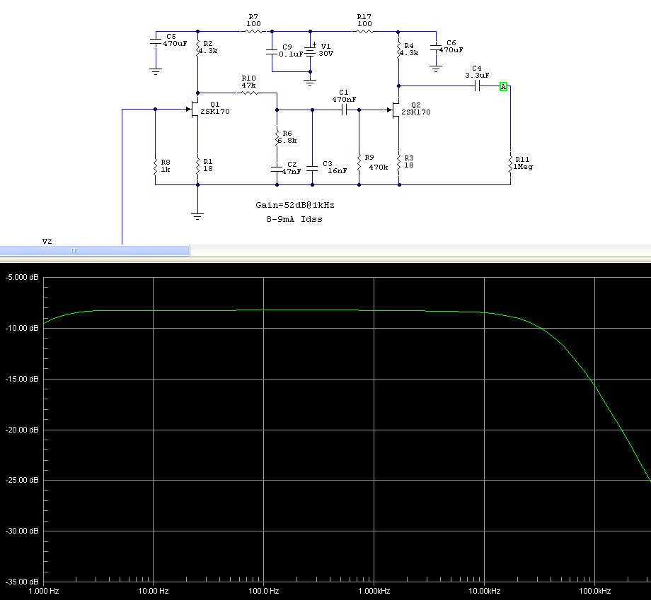

RMS is supposed when we talk AC, if not else stated. So you talk 353mV. Those Riaa values could work flatter if Ro 1st stage was included. In your example is the 4k drain load. And the ratio for driving is low, so it upsets the curve further.
Now try R4,R5,C2,C3= 47k 6.8k 47n 16n on 470k load instead of 100k R6 and run the curve again

Thanks for running the RIAA, i am surprised about the bump, those were meant to be tweaked values, i thought by sim, but maybe they were tweaked by ear.
Just do the MC version from that PDF but with 42V B+ so to work with your IDSS. What are your amp and speakers BTW?

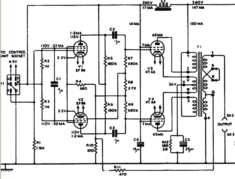

Quad II is rather insensitive as tube amps go, probably because its two stage. I would not push such a phono to do all the drive, since its second stage peaks THD the more it swings. Driving the Quad II with a B1 does not help either. Was there a mod that Quad tweakers were doing around EF86s cathode resistors, so to make it more sensitive?

Yes there is that mod, i will try that. 470R instead of 100R.
A long time ago i asked around, and the overwhelmign consensus was replace out of spec parts, and don't change anything, but i did not hear of that mod.
I have replace little on the amps over th years, just the cathode cap and resistor on the output tubes.
Odd. Maybe they use 47R?
you may be onto something, i read 470hm, but 47R would make more sense.

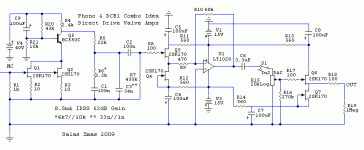

Maybe a typo. Anyway, if you can get the Quad II down to 0.7V RMS sensitivity with that mod, I simulated a phono + DCB1 combo idea that could drive most of valve amps directly when fed from a 0.5mV MC cart, with low THD second gain stage, and passive RIAA filter.

Any OpAmp could just work. There is both sides buffering and capacitive coupling for Vo offset in the CCT. It just depends on the noise density you can afford in a system, given the speaker's sensitivity, main amp's gain, your priorities etc. Although some parts can be very nice to your ears, here we need an inverting 43dB 2nd gain stage, and the 470 Ohm R9 is the interstage buffering 10xB1Ro limit for driving. Which isn't optimal for noise, but necessary in this case. With circa 1nVrtHz En OpAmps like LT1028A there is roughly a 2.9nVrtHz En reflection from the output contribution for chosen gain and resistors, calculating with datasheet En&In 1kHz, R9=2.74nV, R10 33nV, G=145. Now your proposition has 2.7nVrtHz natively, and goes 3.93nVrtHz in this configuration @ 1kHz. Check in your system for hiss VS tone and choose.🙂
