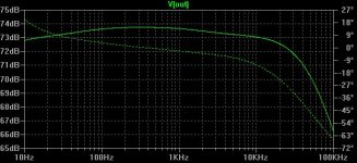

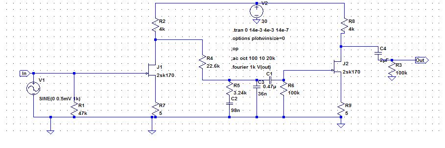

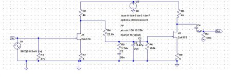

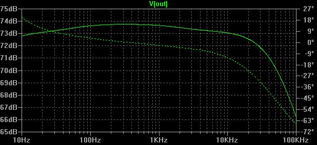

Here's what I got from some really preliminary calculations. Gives you about 54dB gain. Pretty low distortion - 0.075% at 1k and not clipping at 20 Hz. Don't lower the source resistors below 5R, coz it will start clipping in the low frequencies.
I used the values you gave me for the RIAA and as you can see, it is within 1dB but not very flat. You may want to tweak those values.
Ideally, I'd say you need to hit the 500mV mark at 1k with respect to gain. I'm using the peak values to calculate gain (salas, correct me if I'm wrong). Guess you preamp/amp will have to do more work.
hahaha... that worked out great... i did the above circuit without looking at your post salas. I just tried to squeeze as much as I could from the jfets.
This is assuming 8mA Idss jfets, ofcourse, studeb.
