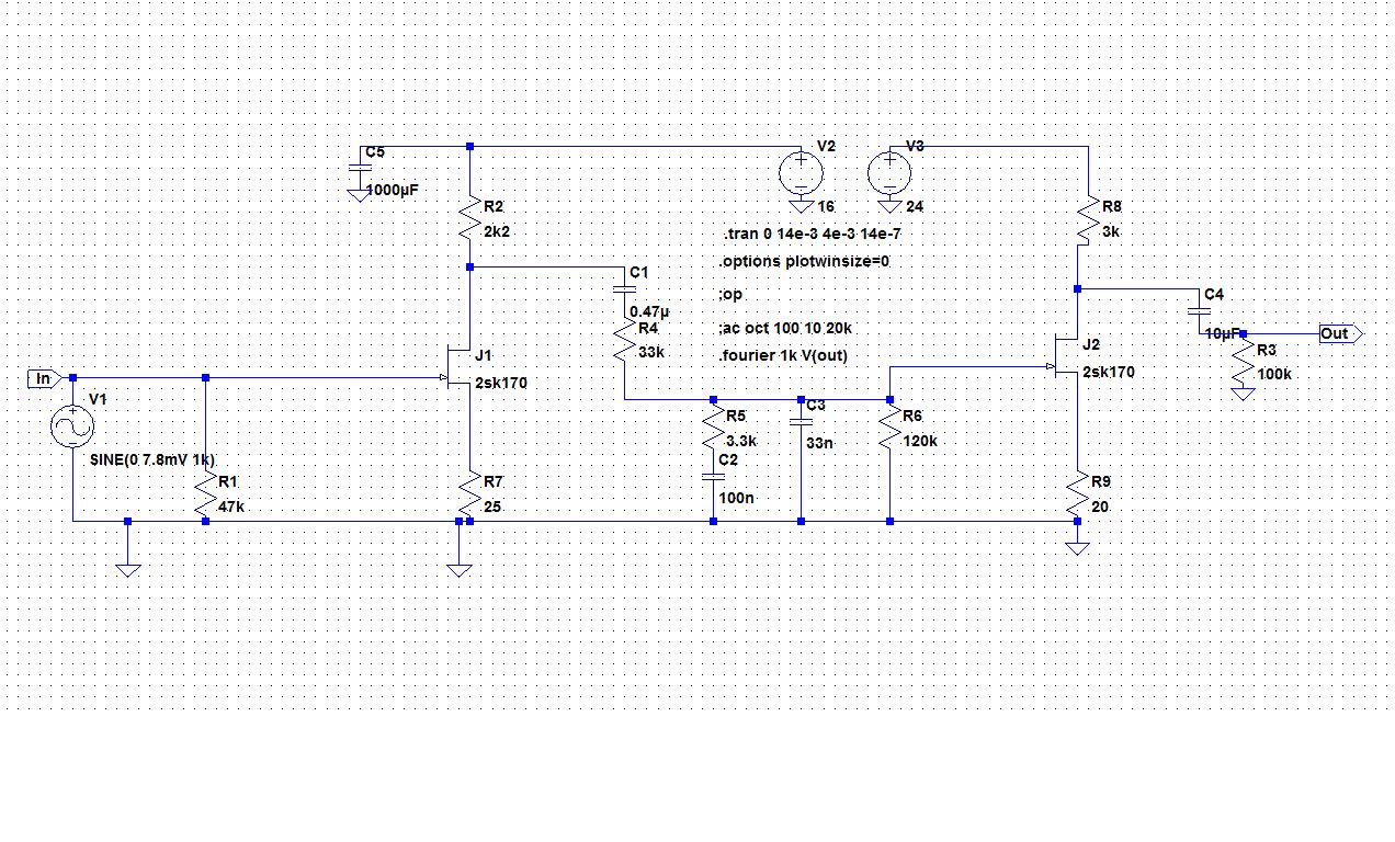

I was trying more configurations with the load resistors etc. I found one with 16V first stage and 24V second stage. The distortion dropped to 0.08%. I built it and it sounds better in every way except it has become very hot... in the sense that it is picking up the clicks and pops too strongly and there is some electrical noise as well. I put 520uF caps before the load resistors and ground and the noise went away for a while, but its back again now.
I tried changing the input resistor and it changes the sound, for good and bad depending on value, but i couldn't get rid of the noise. Apart from the noise, this is a winner. What gives?

The second stage is the main THD contributor in such a circuit because it handles some appreciable level. You gave it better swing and degeneration now. That is well. You have two floating psus (batteries) as I understand on it now? One 16V and one 24V? Use just the 24V one, put a large electrolytic across it, right on its poles. Then from the B+ node on the circuit use 2 resistors towards the stages drains. 100R for the second stage, 2k2 for the first stage. Leave the local drain to earth caps you used there. See that your 1st stage drain voltage is around 15-16V or change that 2k2 a little (you did not give me bias current data but it should be around 4mA?). That experiment may save the you the susceptibility problems, else its something else.

Yes the current draw per stage is about 5mA. About 20-22mA total for both channels.
