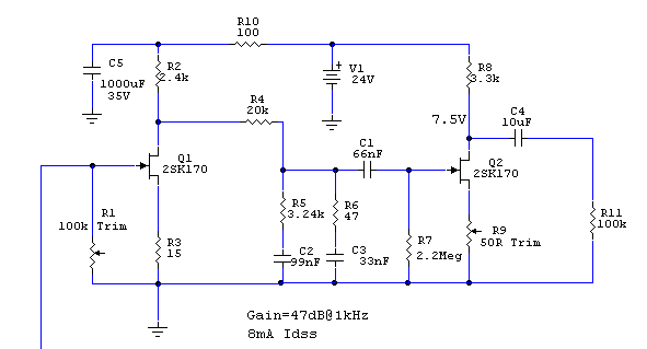

Hmm lets see. Right now you got 71dB system gain with 53dB phono and 18dB amp, you need 4.5V for 2.5W on 8 Ohm, 60dB would do with 5mV cart. Lets use 65dB to allow for peaks and quiter records. The changes in the attachment will get you there, will let THD calm down with the cart you have and help other matters too. Trimmer R9 to get 7.5V drain to ground. Trimmer R1 for the best sound you like in your system. You will not need output matching trimmers anymore.

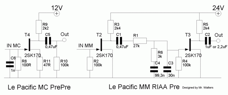

The circuit you are showing has a lot of differences from the one I am using.
I'm using the original circuit (attached).

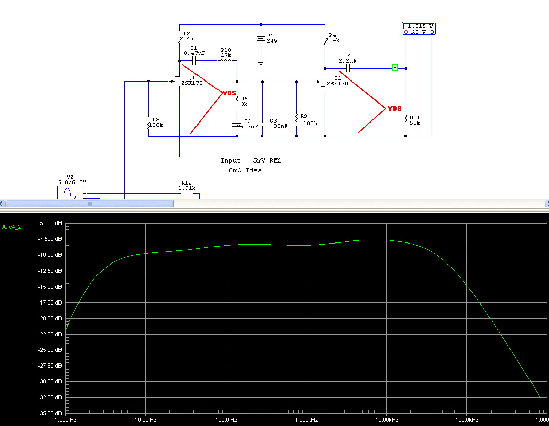

Btw, can you tell me how you measure Vds (simply stick the probes at the ends of the JFETS)? Also, what simulator are you using?

So, you don't use the Madk? You use the one in the last pic above? Wait, I think I have it too.🙂 CM2000 is the sim. I am pretty sure about the models the betas etc I use for your circuit because I have ironed them out and comppared in practice for the many simplistics. Stay tuned.

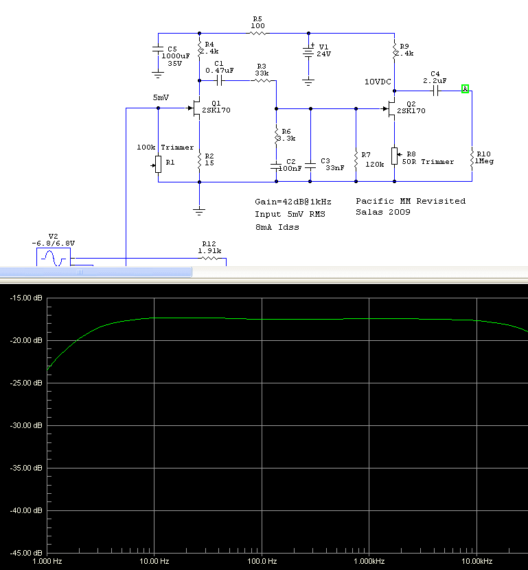

What you got right now is 51.2dB gain and about 1.8VRMS with 5mV average input. Too much for your amp, too much for a non degenerated Njfet second stage regarding THD. The MadK has better Riaa when fed by an accurate reverse Riaa model, yours is ''doctored''. It may be livening up your MM cart though. You must be having 4-5V Vds DC right now with 8mA Idss. Please check. Will see if we can soup up the one you use for your system. More in a while...
I'll try yours and report back.
This one is based to what you got. I have used easy, standard values.
Much more compatible gain and output with 8mA Idss and MM, less thd, way to set the Vd to earth DC of your second stage between channels via R8 (also to match ACmV out), along some little Rs degeneration to bring it under control. Stage psu decoupling. Much better Riaa, better it not be doctored as in the original, use your input 100k trmmer load to find your preferable tone with MM carts. Its drastic and handy.

Yes, you look for 10VDC from that point I show and ground. If you have one channel still somewhat quiter, you can play with its R8 trimmer until it matches output to the other channel. In that case, the quiter channel may show less than 10VDC after you trim it.

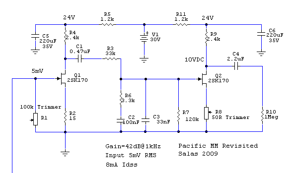

I got new Nimh batteries.... now I got close to 30V from the battery. How do I drop the 6V?
I want to put a resistor in series with the battery, but I don't know what value unless I know how much current is flowing.
For some reason, I can't measure the current in my existing circuit.

Ohm's law. 1k2 drops 6V for 5mA that each stage will roughly use. 1k-1k2 will get you there depending on your batteries top voltage and how much around 5mA each of your fets really draws in practice. The 220uF caps make a long enough RC time constant with the given resistor ballpark value so to bypass even under 10Hz. Your first stage especially needs that because batteries have enough impedance to pass modulation from the stronger swinging 2nd stage. So you do two good things with one needed Vdrop move.
