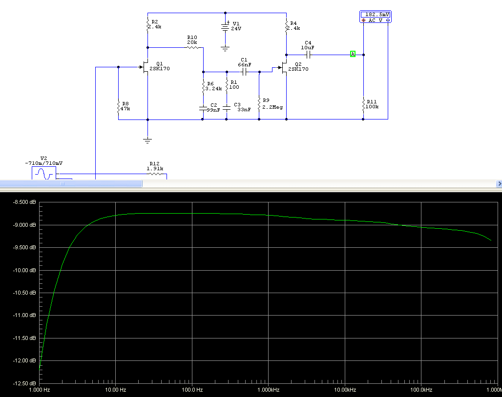

Spencer says he has matched 6.8mA idss 2SK170-BL. What effect could I expect with those jfets? More gain overall, or would other anomalies be introduced?
Many thanks
Lucas
You can expect 7.6V at the drains, 51dB gain, and the curve in the attachment. The 6.8mA matched look pretty OK in this circuit. I used 30m beta in the sim for them. 51dB is good for 1mV cartridge.

I haven't made the MadK but I am pretty sure that the simulator goes OK for what it shows. The other one you show its first time I see. Its a fully bjt cascoded and bjt cascode followed 2 stage jfet base cct with passive Riaa. Seeing the B+ and RLcollector values I should expect it to have the space for 0.8mA Idss more than the author gives as top ballpark value of 6mA. Again expect some more gain than stated if with 6.8mA which is obviously more than the 5mA average recommended on that cct. In case the collector voltages drop too much, you can always control the current and a bit of gain by rising R15 & R18 degeneration resistors. I would use 50R trimmers there instead of fixed resistors if in your boots, so to control it and match it easily for voltages between channels when with the stronger jfets.
