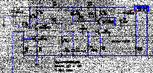

The simulator shows that you can try 7mA BL with no source resistor and 24V B+, 2K4 Rd. I did it because I know that people will not find GR as easy as BL, and the latter averages 7-8mA Idss. Use no higher!
The lower the Idss the more Vds on a given resistor, you can increase the Rd a little and go 11V as in the original, when using 4mA GR.
You can fine tune by ear, many options, depends on system and taste.
Also the nF value caps need measuring so to know their real value. Broad 1dB lifts or cuts are very audible.
Those things refer to the original Pacific.

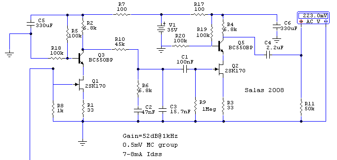

I simulated 2 cascoded versions. One 40dB for circa 2mV high MCs like Denon and the like, and one 52dB for the large normal MC group of 0.4mV to 0.6mV. What do you think that it must be done differently in your experience?

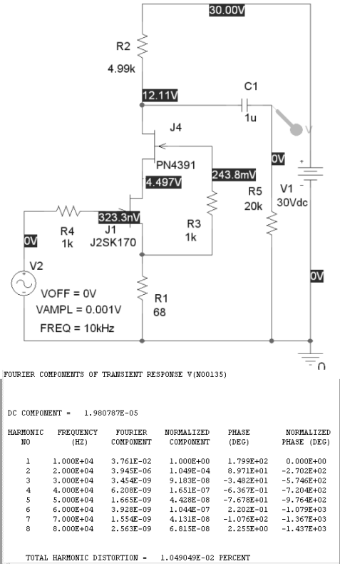

For grins, I did a simulation of a simple cascoded common source stage using a 2SK170 set up for a gain of about 40X, what I would use as the front end for a MM preamp. I tried a JFET cascode and a bipolar cascode, making sure that the drain voltages for the 2sK170 were similar for the two cases. The results are interesting. THD is about the same, but the harmonic distributions are different. Attached are the JFET cascode results:
Next is the bipolar simulation. One could quibble all day long about the validity of the precise values for the harmonic spectrum and come out no wiser. I find it interesting that the two results were different, and wonder if there is any real-world impact. I've also been doing some simulations lately with Werner's folded cascode circuit, and found that it was important to allow proper breathing room (read sufficient VDS) for the input JFET. When properly implemented, the results go from a lackluster 0.4% THD to 0.002%. Maybe that's the lesson here, as well.
Nice sims wrenchone.

wrenchone said:and found that it was important to allow proper breathing room (read sufficient VDS) for the input JFET. When properly implemented, the results go from a lackluster 0.4% THD to 0.002%. Maybe that's the lesson here, as well.
In my two circuits posted above, I have allowed just a touch lower than 8V VDS for the 2SKs. Just ok for them I have concluded by experience. Enough working frame, & steady operation just before their drain gate leakage onset. Can use high input impedance for the second stage that way with a highish Riaa impedance so there is no appreciable strain that leads to buffers usage. I keep it simple.
It may be very tempting to patch everything up to best measures on the sim, but in real life I could clearly hear just one 100 Ohm gate stopper on first stage damping the dynamics of a low Z, low out Ortofon MC, in my Riaa. Its just a stopper? Arguably no, if it dwarfs the tiny Z of the source. In a tube line stage is innocuous by comparison. Such Riaa circuits must be made tight and with lowest part count possible, judged step by step by ear IMHO.
