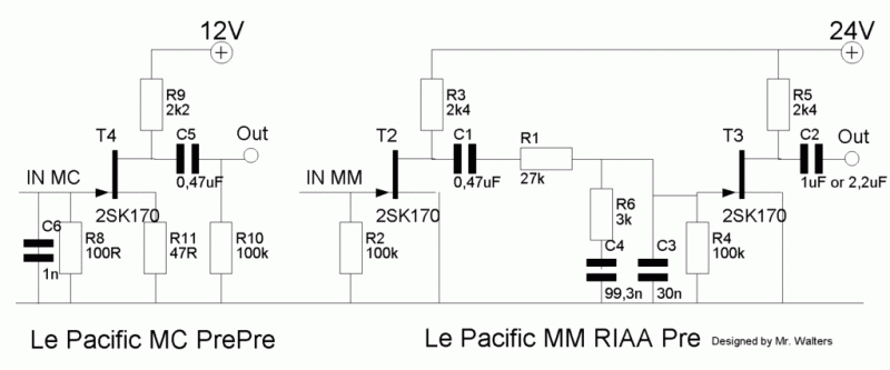

Hi folks.
Have some SK170GR's arriving this week, so I can get started on this project at last 🙂
I have a Denon MC 103R but I don't think the gain in this circuit is enough to do it justice - anyone tried an MC with this pre? I might have to use my MM Goldring G1042 instead.
Just a little confused which schematic to use: Mad Ks, the original Pacific, or the Pacific with Tschrama's fine tuned RIAA? Which design - on paper at least - offers the closest adherence to the RIAA specification?
Many thanks,
- John
Many thanks,
- John

Johnm with 103 you must use Salsas jfet ! for correct gain
the goldring have too much output 6,5mv saturate the jfet !
aka pacific work well with 1,6-3,5 mv HIMO
PS BL in pacific with 33r on surce lowered the 2HD a lot ,but I like it!

tschrama said:
2] Each JFET has a gain of about 30dB, that's 60dB in total, but you loose 20dB in the RIAA nrework.. so expect a 1KHz gain of about 40dB, that would mean 5mV in, 500mV out.
I think 500mV would be too high, as the output JFET starts distortion to much beyond 300mV. Maybe you can get rid of some gain to keep the output below 300mV. Exchabnge the first 2.4K resisro with 1.2K, and put another 1.2K in series. This will halve the gain.
Thijs
this riaa have 300pf input ,not report here but have plus 100pf cable you think that is a MM stage ?
for me is a HO MC ,I use for dl-160 2mv
you can tray with 103 if amp+ speaker have gain......
If I remember well you for1042 you can play with rload...
Yeah it definately seems better suited to HO MC's I think. Thanks for the quote by Tschrama - I think I'll try halving the gain like he suggets.
I'll try the Denon 103R anyway - I already have the parts for the Pacific which is why I'm keen to make it work 🙂
- John

you must match the jfet for idss 4-6ma at 0,1%ma
+10v>meter(ma)>Drain
surce&gate to -
for 5minuti
surce&gate to -
for 5minuti

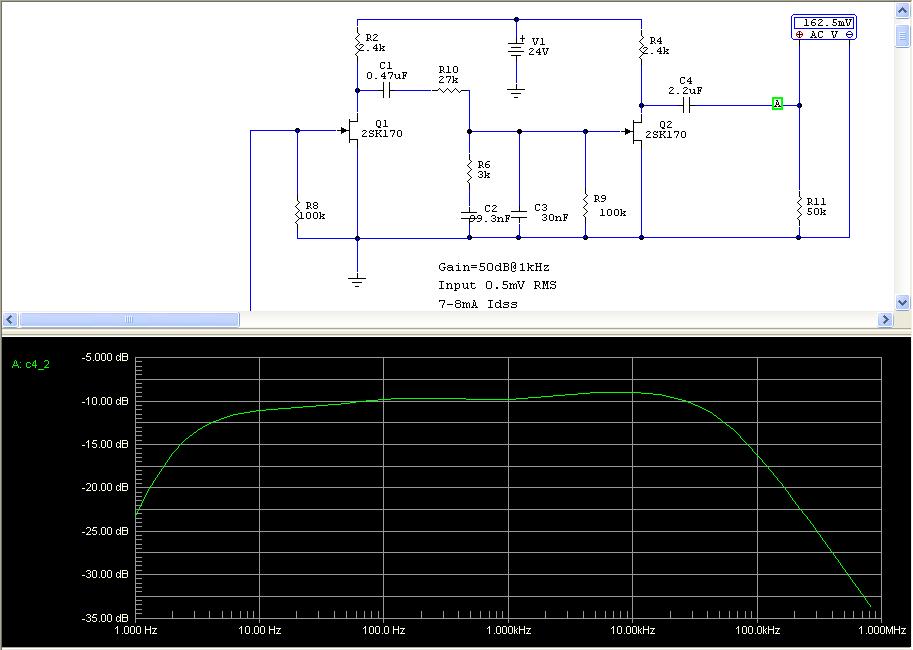

I run a simulation and I see that 2SK170BL 7.5mA Idss IS usable, and to my opinion preferable. Because it gives 50dB instead of the 45dB with GRs, and keeps the Vds under 8V which is much better for the drain to gate leakage, else escalating at 11V that the GRs produce.
I would not change the original wiggly, somewhat brightening the mix RIAA, because without R source degeneration and no local Rd filtering surely it will sound thick with a flat RIAA. I am sure that it is finely tuned by ear and I can see the reasons. Of course I don't see the real reason why not making it as I did in my version with less THD, more gain, more headroom (7mv max input@20Hz), and accurate RIAA. Listening to the original and comparing for system tone matching and then converting it again to something updated if needed, is enough reason in DIY I guess. Nice to know.
