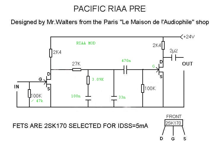

sure...from the orgininal Pacific RIAA:
1] moved the coupling cap between stage 1 and two, to just before stage 2..
2] put a resistor parrallel to the resistor to ground in the RIAA filter, to make it 3.09K
3] used a 100nF cap, not 98nF
4] used 2x15nF + 2.2nF + 1nF
chrzz,
Thijs

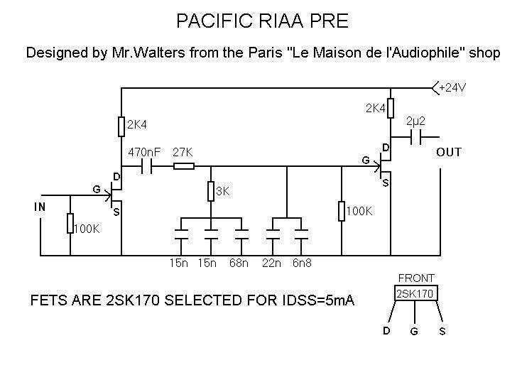

Hello Thijs, JohnM, others,
Thijs, is it correct that you refer to the original design as designed by mr. Walters from La Maison de L’Audiophile in Paris as in the attachment? I use this original design already for many years now and feel invited to try this update. Thanks Thijs.
Is it correct that I can read your modifications as follows:
1] moved the coupling cap between stage 1 and two, to just before stage 2. The 470nF is now between the upper node of the 100k resistor and the Gate of the second fet
2] put a resistor parallel to the resistor to ground in the RIAA filter, to make it 3.09K. Is this parallel to the 100k resistor? Then a (composed) value of 3.190 ohm (3k19) would do I guess?
3] used a 100nF cap, not 98nF. This would be instead of the (15n + 15n + 68n )
4] used 2x15nF + 2.2nF + 1nF. Is this instead of the (22n + 6n8) ?
With this modifications it would be interesting to compare this modified original design with the redesign of Thorsten Loesch as applied by Mad K in this thread.
Best, Arjen.

Hi av-trouvaille,
Thanks for posting the schematic. Indeed, those are precisely the modification I have done.
I used a inverse-RIAA network to fine tune the transfer function, trying a few capacitors of the same value, untill I got it right..

HI
the tschrama riaa mod is correct ?
jfet----27k-------------------------470nf--------jfet
...............3k..........33n.......3.09k
..............100n........|...........|
------------------------------------------------gnd--
the point are only for correct image
drain----27k-----------------470nf--------jfet
.......................3.09k....33n.......100K
......................100n........|...........|
you have to check the RIAA curve with a inverse-RIAA filter, scope and sine generator.. switch individual capacitors for species of equal value, till you get it right... or start adding 1nF and 470pF values to tweak it..

1] I use polypropylene. I mixed mathed untill I get a flat transfer function thrue a Inverse-RIAA network. As shown, you can expect about 0.5-to 1.0 dB deviation.
I think polysterene would be the preferred alternative.
2] Each JFET has a gain of about 30dB, that's 60dB in total, but you loose 20dB in the RIAA nrework.. so expect a 1KHz gain of about 40dB, that would mean 5mV in, 500mV out.
I think 500mV would be too high, as the output JFET starts distortion to much beyond 300mV. Maybe you can get rid of some gain to keep the output below 300mV. Exchabnge the first 2.4K resisro with 1.2K, and put another 1.2K in series. This will halve the gain.
3] Power supply must be extremely good. I use 2x 9V NiMh battery with 2200uF and local bypass. I wouldn't dare to use a AC-based power supply. Power supply rejection is allmost non-excistant. Optimum voltage on my build was very low, about 15(?) volt.. 24Volt is too high.
By lowering the voltage, you can effectively cancle the second harmonics of the last JFET stage. Optimum voltage is depended on the Idss of the JFET. I use Idss 9mA, I think...
You can adjust it by carefully look for assymetric distortion of a sine wave, and see at what voltage the assymetry flips.. somewhere in the middle would be close to the optimum.
goodluck,
Thijs

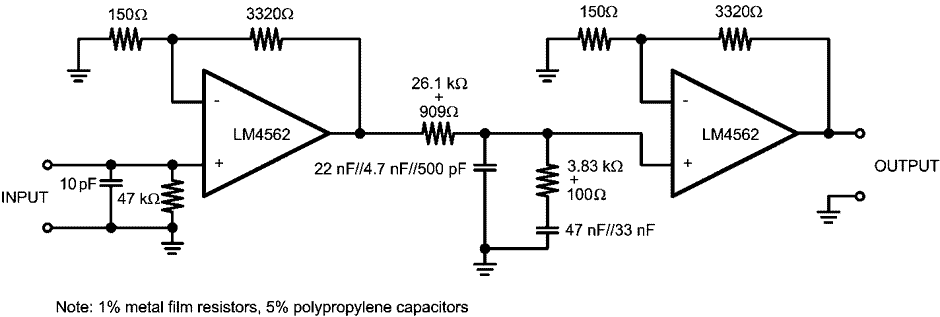

Here is a schematic from our buddies at National Semiconductor with a similar approach. Just using an LM4562 opamp instead.
