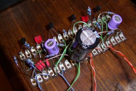

Hi Gliding Dutchman!
Would you mind sharing your layout? I happen to have exactly the same strip board lying around and I'd love to build this to try out on my Denon 103R and Garrard 401.
Many thanks 🙂
- John

John
I just soldered the parts onto the tag strip in a "random" fashion with no "propper" layout (ofcoarse according to the design!).
A friend of mine and I am working on a higher gain stage in a similar fashion to MAD K's - I'll send you the details of that circuit as I believe it would be a better match for your Denon 103R.
The above circuit works well with low output MC cartridges but higher gain would be a benifit.
Also checking out the circuit to run from 12vdc (incl IC regulators etc).
Cheers
Dewald the GD
Hi GlidingDutchman,
nice building, I am on half way building this too.
What kind PS you use, battery or regulated?
Thees violet el caps are on output?
Zigis.
Zigis.

Hi Zigis - currently I am running it from a Pb Acid battery (2x 12vdc) but I am looking into doing a IC regulated PSU.
The violet caps are the outputs yes - will be replaced by some plastic film types in due course.
D
