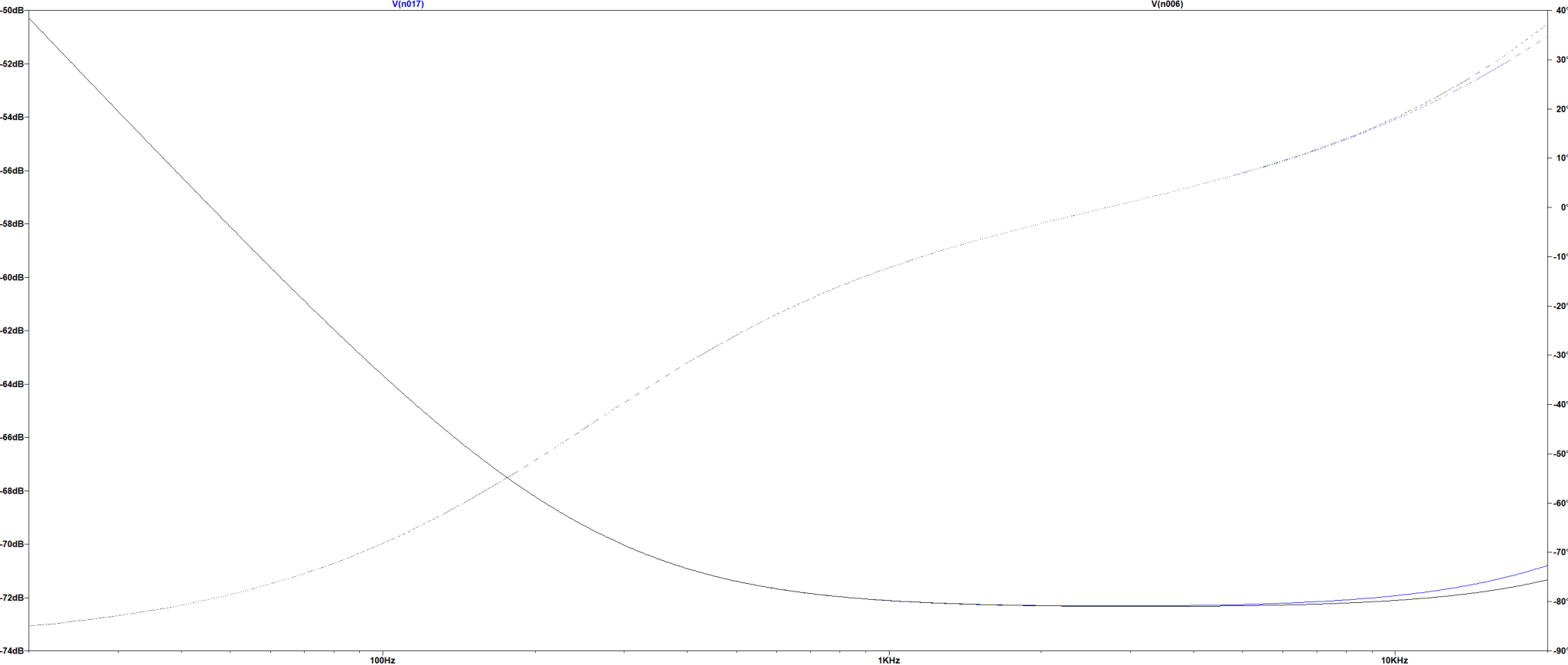

Here are the PSRR numbers vs frequency for the buffer in MC mode with 2N3904s and ZTX851s, measured at the output port.
The two cases almost overlap for the positive supply. And for the negative...
This is for a gain of 46dB.

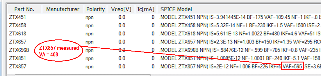

It's yet another reminder that SPICE simulations aren't "measurements" and SPICE transistor models often don't reflect reality.
When I extract the slopes from the measured electrical data in #240 I find that at Ice=12mA, 2N3904 has an ro of 5500 ohms, corresponding to VA=66. I also find that at Ice=12mA, ZTX857 has an ro of 34K ohms, corresponding to VA=408. The ratio of these two Early voltages is 6.2 in the real (non SPICE) world. At least for the sample devices laying on my bench.
Curve tracer measurements have corrected faulty human intuition; the faults were caused by SPICE models not matching reality.

Fine, but that makes little practical difference in this case., and there is no way to realistically incorporate this understanding in the present simulation environment.
In case you didn't know I spent considerable time at ADI working with the CAD group on the modelling (and device optimization) of complementary bipolar devices, including obscure issues such as quasi saturation, and later on in deep sub micron cmos where sub threshold issues were of extreme importance.
I am aware of the limitations of models, but I also know that prototyping (or silicon) is the ultimate arbiter and in the absence of a modelling group at my beck and call all I can do is use what is available and try to design around the limitations that LTspice imposes.
That's why I do prototypes. That's why I characterize them extensively. However, I will say that the avoidance of obvious errors is more important than being overly anxious about what often turn out to be second or third order effects.
I tell you what, I'll edit the models to reflect, at least to a first order, the VAF that you specify and see what happens....

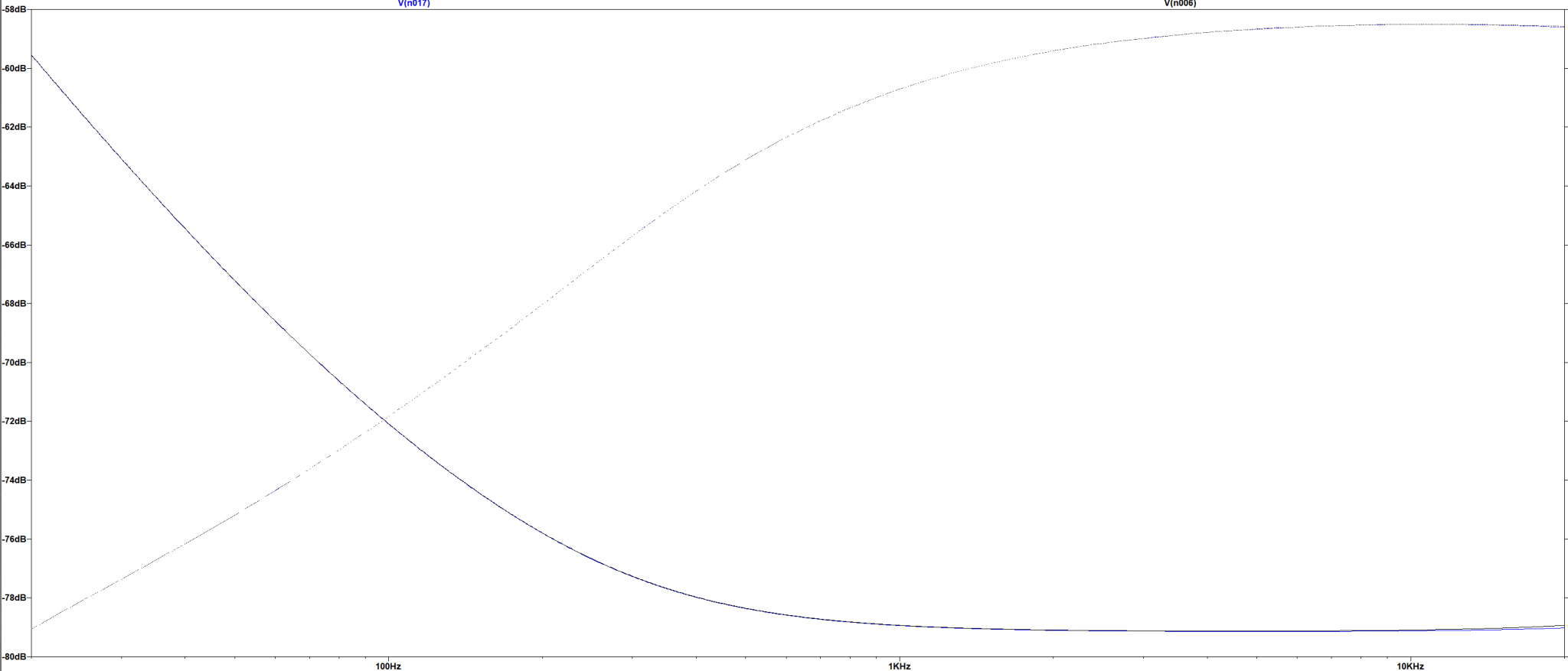

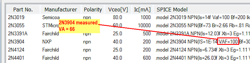

So, the 3904 has a VAF of 66 and the ZTX851 has a VAF of 400. The end result is that the max positive PSRR dropped by 3dB for the 3904 and increased by 10dB for the ZTX851. The negative was essentially unchanged.
These changes occurred at frequencies of 300Hz and above, and in fact the negative PSRR still dominates.
I've returned the models to their original state and will retain the choice of device that I made, mostly because of inventory and cost issues.

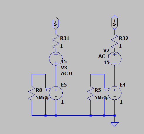

In case anyone is interested here is the approach I take to model the effect of the PSRR relative to the +/-15v regulators.
The published nominal rms noise at the output of an LM7815 is 90uv over a bandwidth 0f 10Hz-100kHz.
A 5meg R produces 91uv over a 10-100k bandwidth.
So, a source is added to the supplies that injects that noise. I then simulate the noise at the output of the block of interest and compare against the noise without the noise source.
With the present design the 20-20kHz output noise degrades by approximately 1dB when the supply noise, on both supplies, is increased by a factor of 850.
I consider this to be adequate margin.

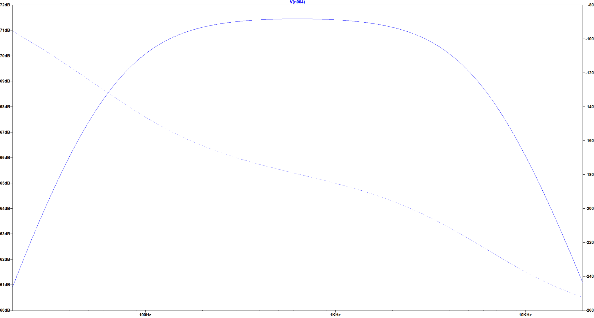

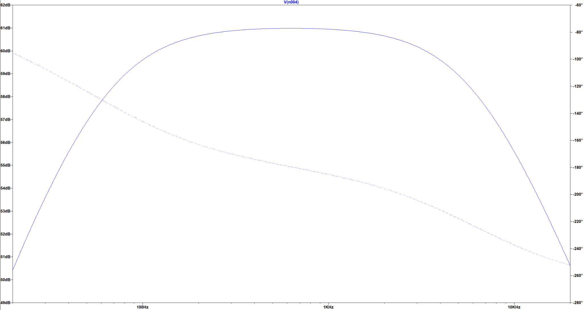

Some simulated results for the buffer/RIAA stage.
Nominal RIAA compliance 20Hz-20kHz. 5mdB p-p. 100mdB p-p max with 1% caps and 0.1% Rs in the RIAA stage.

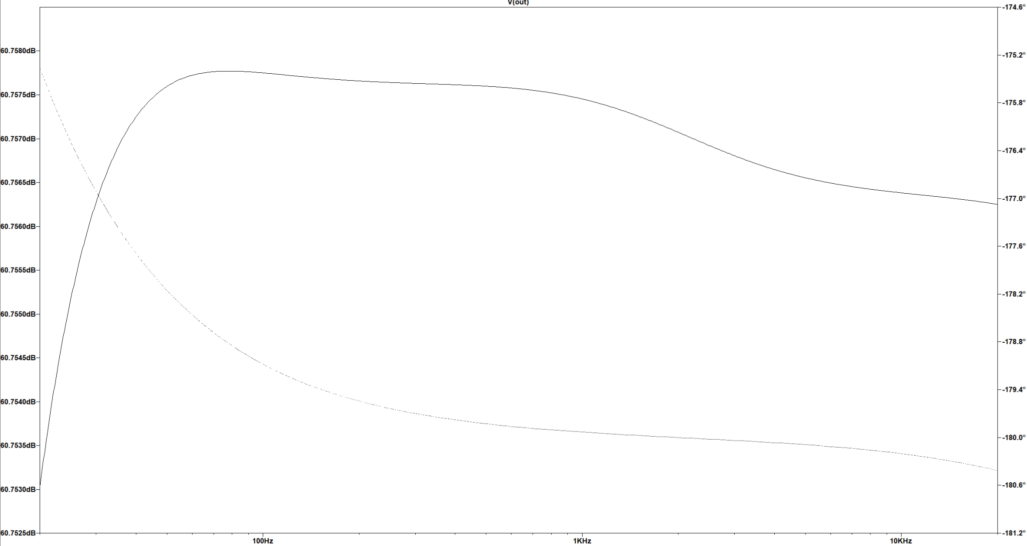

Buffer Feedback factor for a 46dB (MC mode) closed loop gain - not open loop gain. This is the gain that is applied for correction.
As above, but with 26dB gain- MM mode.

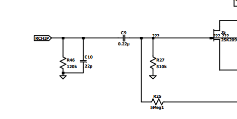

Unlike its predecessor it's not immediately usable as a line stage as well as a stand alone phono stage., even if it does have limited balance (+/-3.4dB) and mono functions. It can be used in 2dB gain increments from 35dB to 73 dB, but the relationship is not straight forward.
In the case of an MC cart, if the input coupling C is 0.22uF, the impedance (real part) seen from the FET gate will be 510kΩ dominant in the low range, and noise will increase. I think it need at least a few tens of uF.
Thank you for the question and the interest.
Yes, the "1/f noise" (yes, I know it's not actually 1/f) will increase. However, the effect on the A weighted noise is minimal.
The small cap is beneficial because of the dynamics of the calibration loop. The resistors and the cap can be scaled, but no more than about a factor of 5 as the input impedance that I actually would prefer is c. 100k at 1kHz, due to the MM cartridge needs.
The unweighted 20-20kHz output noise after the RIAA stage is 445.6uv simulated, while the A weighted value is 40.7uv. The total gain is 61dB at 1kHz.
However, perhaps somewhat counter intuitively, depending on your intuition, if I do scale the impedances to 100k/500k with a 1u cap then the simulated integrated A-weighted noise actually worsens to 42.8uv- 0.4dB worse!

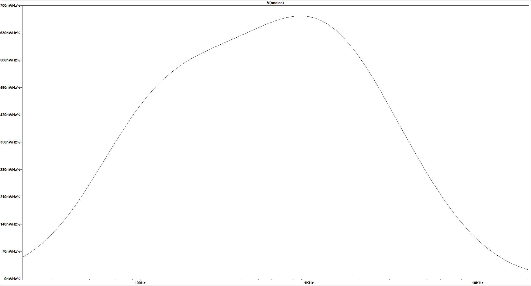

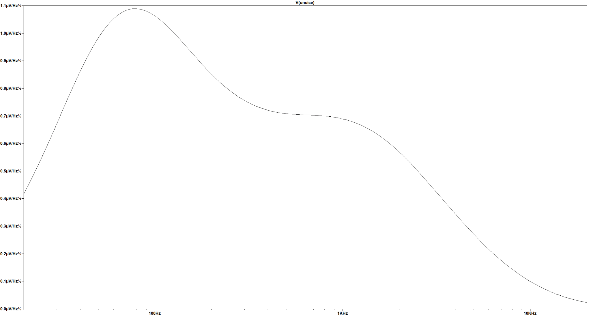

Below is the original circuit output A weighted noise.

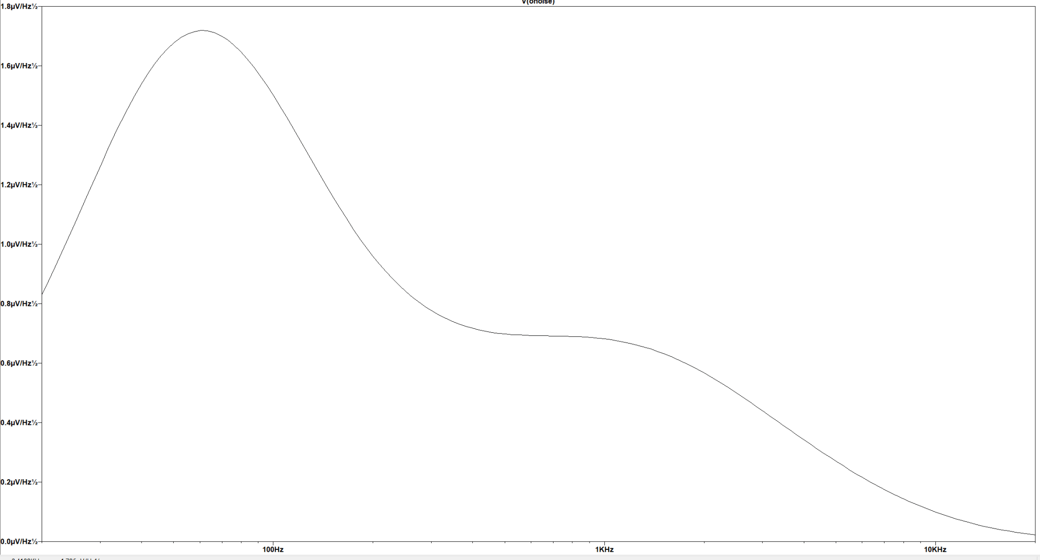

Below is with the Cx5 and the Rs/5.
Note the increased LF "hump".
Just for interest sake- let's keep the Rs constant and increase the cap to 10uF. Something that is, well, impractical in this architecture because of the very slow rate at which the input calibration loop settles and the effect it has on the rest of the DC coupled amplifier stages.
The A-weighted output noise decreases to 37.9uv, a 0.6dB improvement!
Overall, I believe that the tradeoffs are, from an acoustic perspective, quite reasonable.
