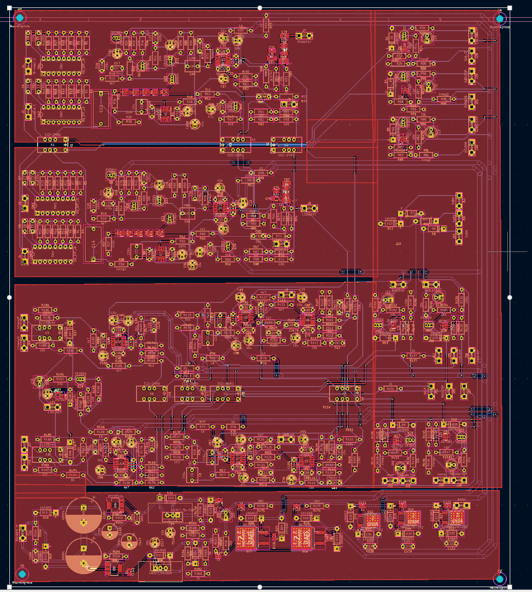

The layout is still progressing, although slowly. It's a tricky one compared to the past efforts. The OPA1678s in the cal loop are now OPA202s which are single superbeta input opamps in a SOIC-8 package.

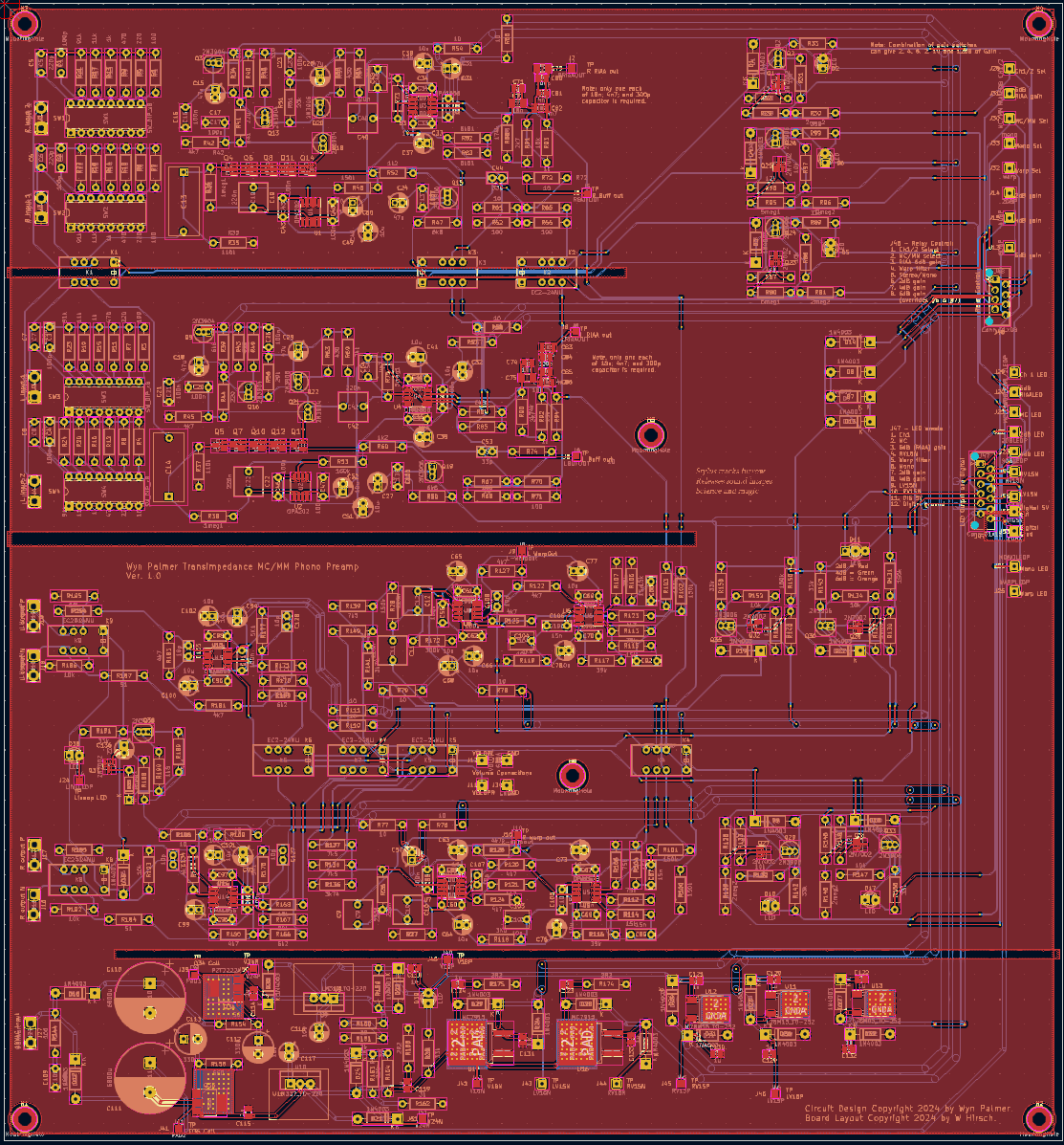

Layout progressing.
Inputs at the top left, outputs at the middle left, AC input from the wall wart at the bottom left. Board c. 290mm x 250mm. Still a few changes to be made.
The "test" boards (see above), which are the, hopefully, fully functional design, have been ordered, as will be the Mouser cart (today). The boards are c. $10 each plus shipping in quantities of 5.
Provisions have been added for the projected IR remote control/front panel board, but that is not essential for operation.
The Mouser cart (all except case/sockets/wall wart) is $124 including shipping.
My collaborator, Bill Hirsch, who did the layout, will be assembling the board and I'll test/debug it and post the results.

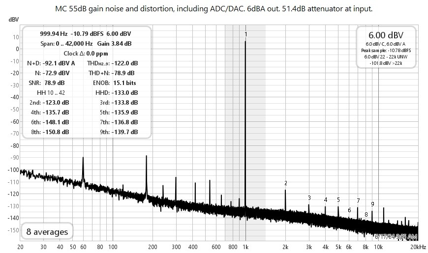

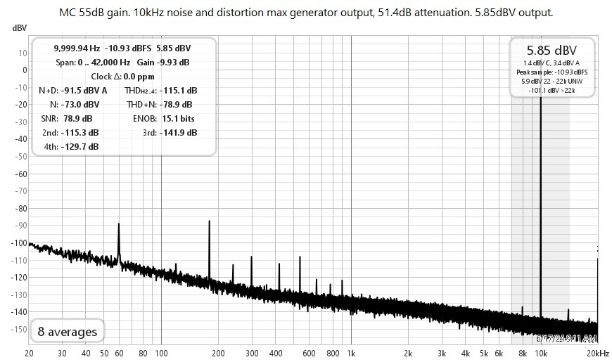

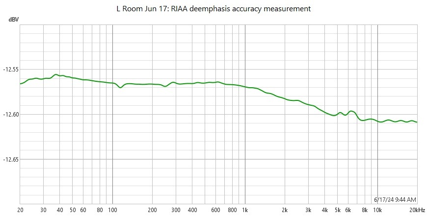

I (finally) have some measurement results. The unit is not in a box, but some attempt has been made to shield it to get the mains hum components down. Those darn input FETs.
The results include the "loop back" distortion of the RME ADC/DAC.
c. 50mdB p-p RIAA accuracy 20Hz-20kHz.
Noise floor with 10 ohm source impedance.
The 10kHz distortion has degraded a tad due to the increase in "compensation" capacitance for the transimpedance cell.
Everything works as expected.
At some point I'll measure the results with the other gain settings, but I'm done for now.
