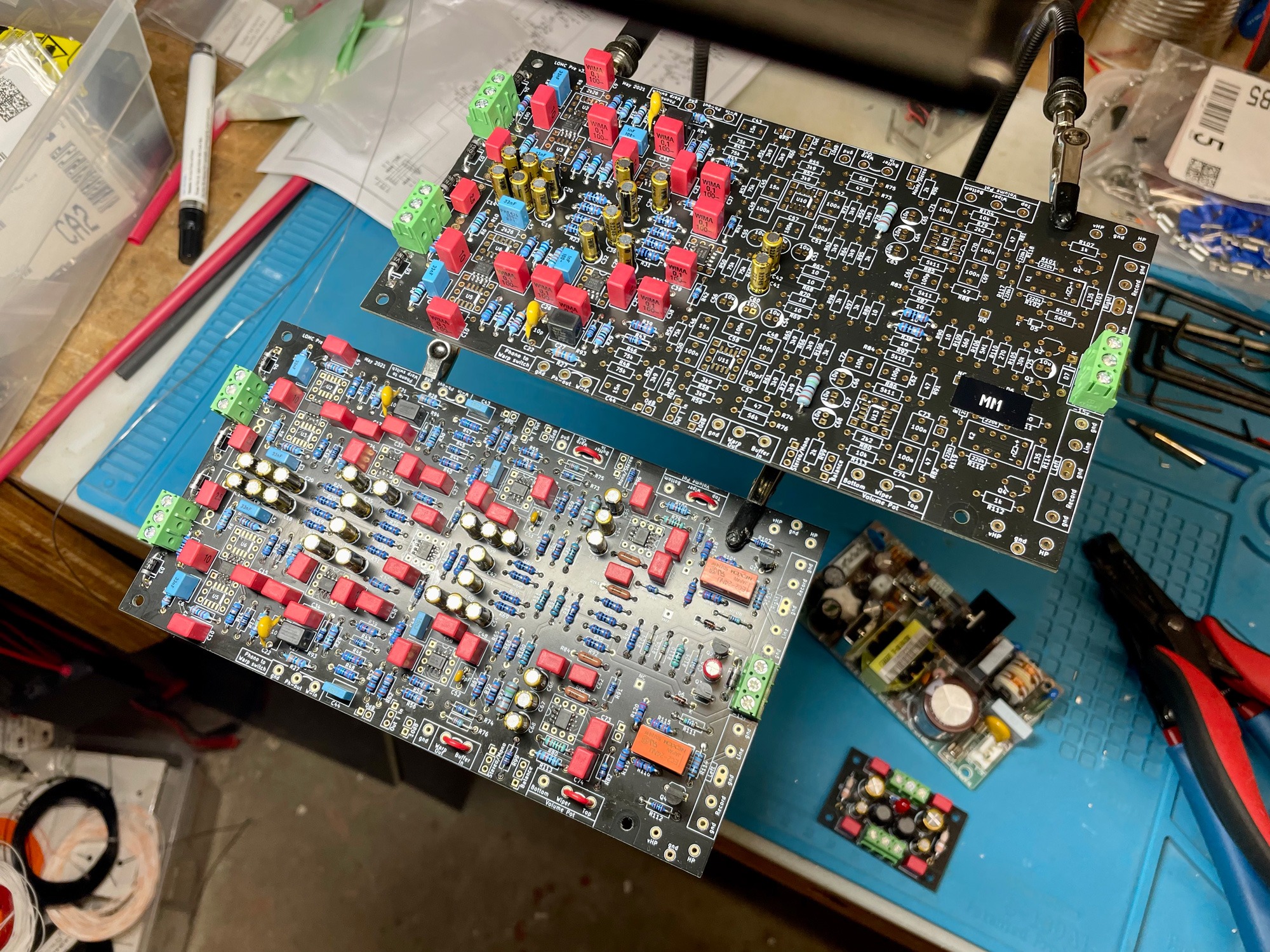

@6L6 dropped this phono project on me because he probably knows I'll build it immediately. V3.2 boards are ordered (file says 3.2, gerbers say 3.1—they are not in hand yet). There will be 6 available (need 2 if you want to build MM plus MC)—actual PCB cost + shipping + envelopes + first come first serve — up for grabs with a PM...
Mine have been running perfectly for 2 years + now, this is a great phonostage.
If I remember correctly 3.2 and 3.1 are identical except a silk screen error that I missed on 3.1 was corrected in 3.2. It exchanged the values/IDs of two resistors.

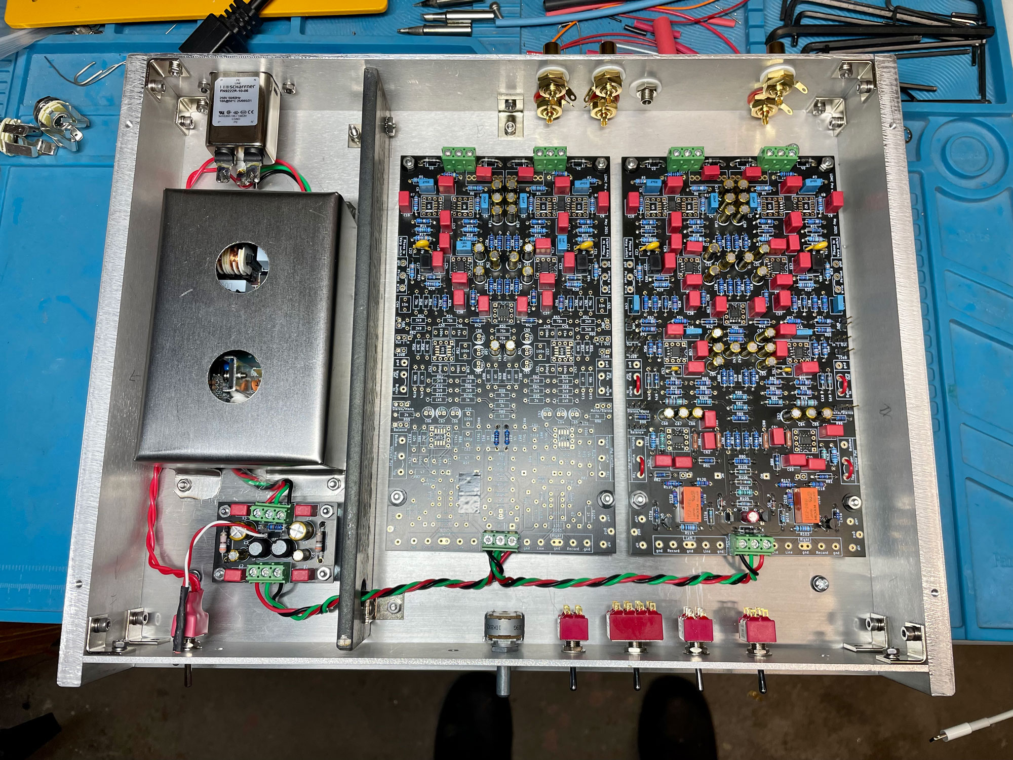

Wyn, I do get the impression that you are over and done with any kind of DIY forum support (totally okay IMO, no complaints)—BUT—😎—I came across a little confusion (for me) with implementing the balance control on pot and stereo/mono on a switch you added in v3 when building 2x boards for MM and MC—I didn't see my question covered in any of the docs or threads—or I missed it. My instinct tells me I need to populate the balance and stereo/mono parts on BOTH boards? And then perhaps join leads from each board at the pot in the case of balance control or switch as detailed in v3 addendum for stereo/mono....I'm basically building for all options, except Mute and Volume (one of the things that makes your design so cool), but only as a phono pre in my case, no source switching, no headphones.
Thanks!
Thanks!
No, only one line section including balance/mono needs to be populated. This function occurs after the RIAA stage selection is made.
Yes, I am stepping back from "support" of the DIY stages. I'm doing a fair bit of "support" for Sota and that's enough to use up the spare time I have to allocate to this area.

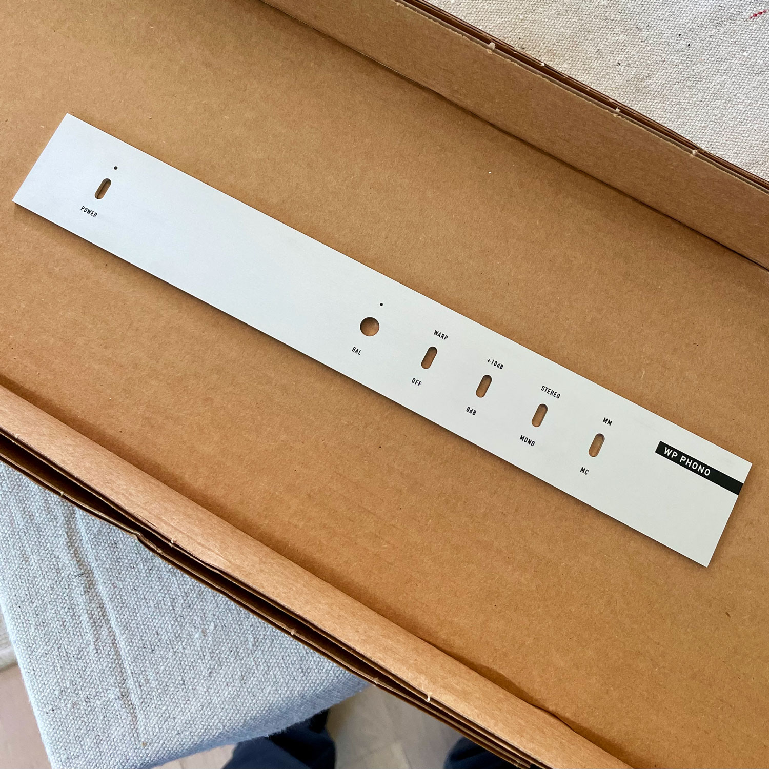

Okay! Of course that makes perfect sense. Thanks for getting back to me. Designing a chassis now…

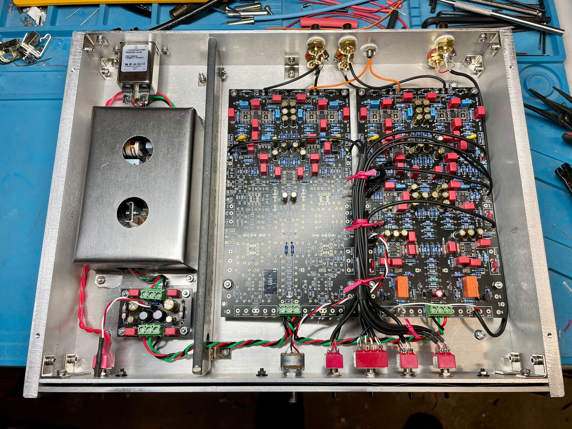

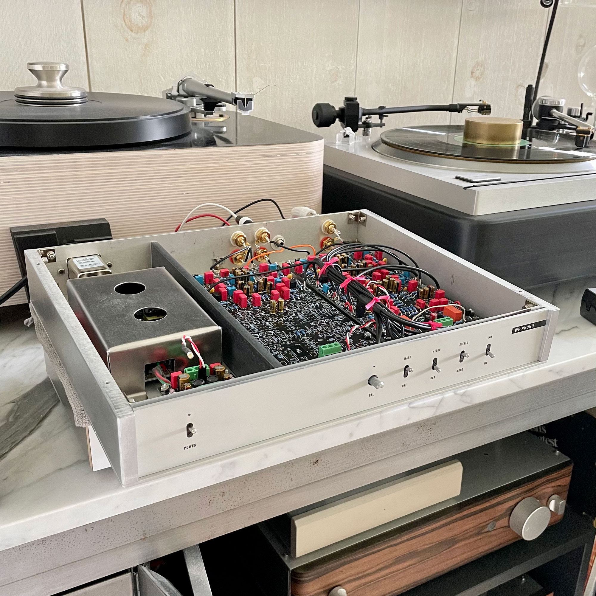

Powers up—voltages correct, relays click click. Lots of shielded cable coming up...
Front panel solution, check... need to add some vent holes and finish lid ...
GOR-geous!
Cowabunga, shazam, O.M.G., and J.F.C.
keep up the good work

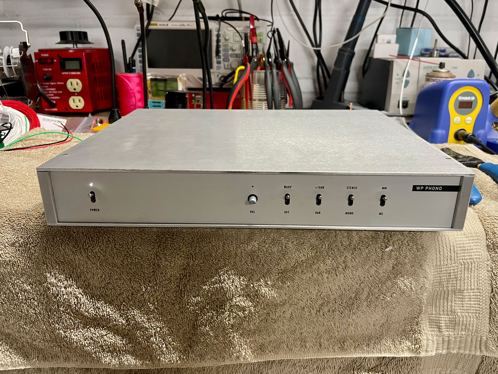

Cross posting with the "official" build thread here. Works great, first try! You can read my full comments on the other thread—I'll finish up the lid and sort out some bizarre LED blowing issues—I think I might have a bad batch—not sure if that is a thing or not—first time using 3mm LEDs. I'm just gently poking them into a 3.4mm hole in the aluminum and they seem to object to that....
