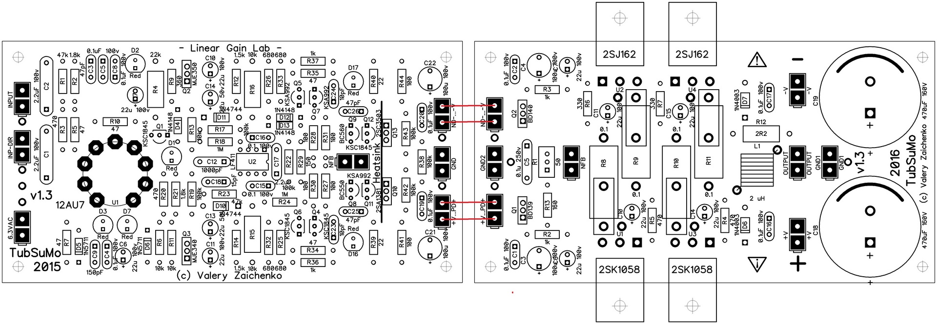

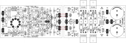

What voltage range is recommended for the IPS power rails?
I was thinking of running the LatFET OPS at 50 -60V and usually the front end likes a few Volts more when powered separately.

Hi Rich,
My build runs at +/-50V rails, although initial prototype was tested at +/-70V.
So, anything in the range you suggest (50-60V) will be fine.
A few volts more for the front-end makes sense only if you really care about energy efficiency. Otherwise, you can connect the front-end rails right to the cap multipliers, located on the OPS board - see red lines on the picture.

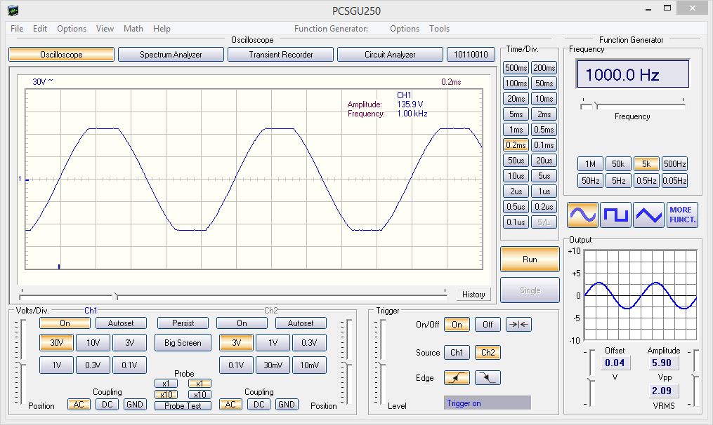

Clipping is perfect due to the special VAS topology (combination of Baxandal's super pair and Hawksford's cascode) - clean cut, no rail sticking whatsoever (picture is live measurement with +/-70V rails - digital oscilloscope). It clipped at 136V amplitude, meaning VAS took 2V on each side. Nothing to worry about.
