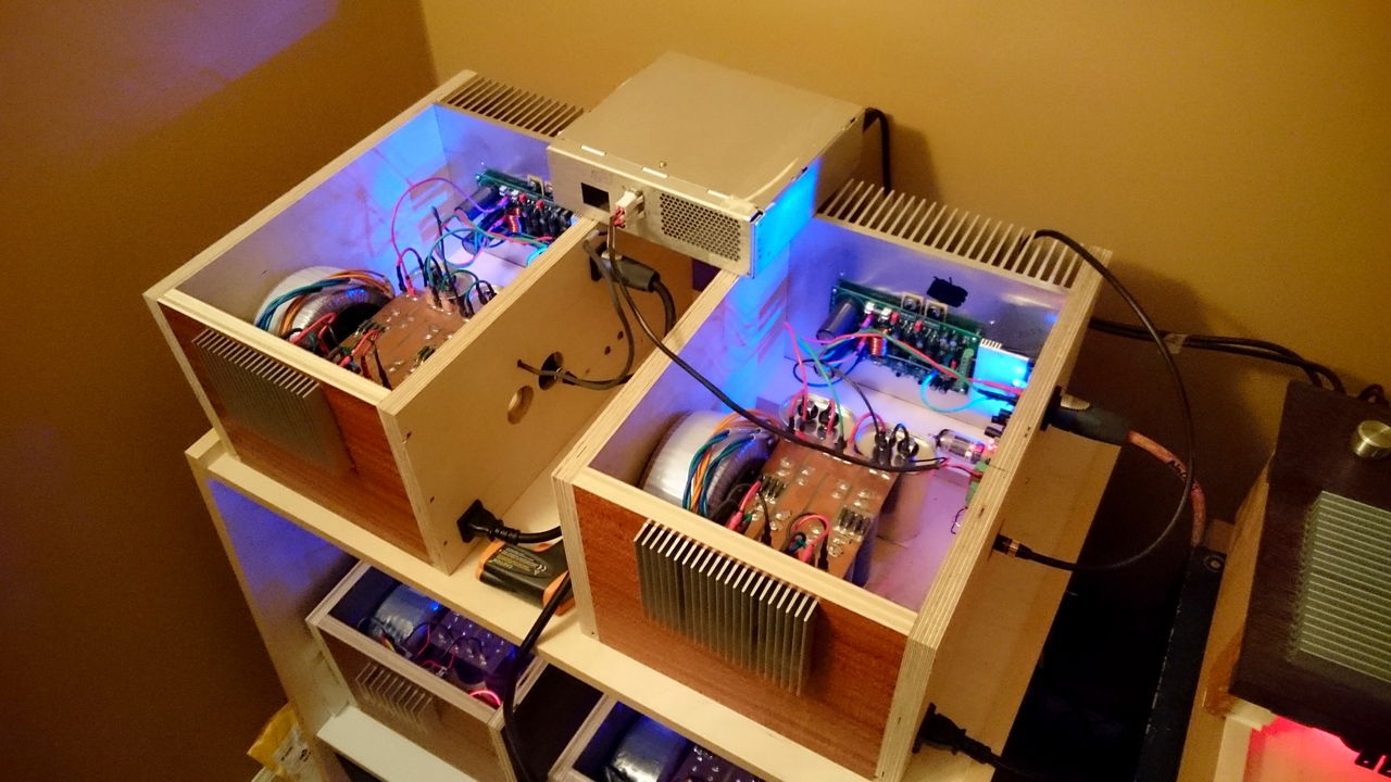

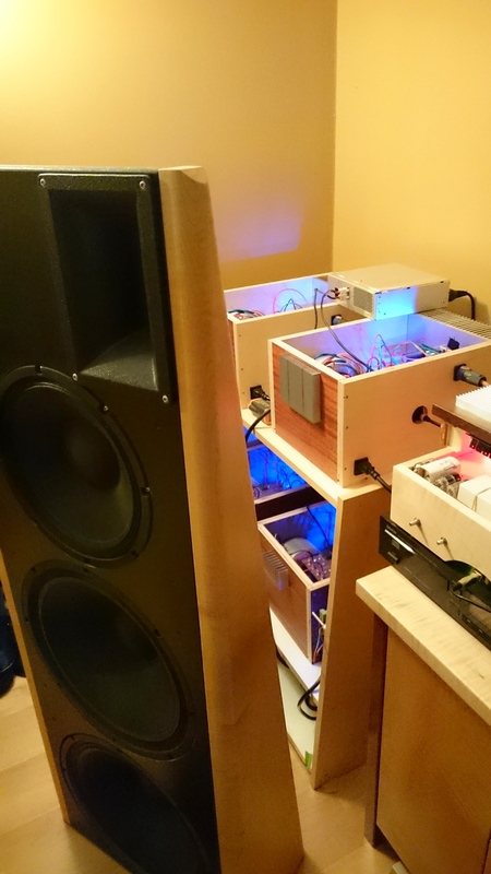

On Thursday last week I have visited Evan (member evanc) at the coast of New Jersey and saw and heard his build of TubSuMo (mids and highs) in combination with SlewMasters (bass section). Cool hand-made wooden compartments, excellent speakers with REAL woofers, the room is just the right size. Everything fits 🙂 The whole thing sounds delicious - extremely natural and detailed, with sound sources all over the room.
Audio paradise
I wish every system would sound like this one
Congratulations Evan and thank you for the cold Hoegaarden, all your hospitality and a quick excursion to the beach
Valery
Audio paradise
Valery
Valery...You are too kind. The pleasure was mine. It is a treat for me to meet one of the very talented and kind people that make up this forum. Any of my successes here are due to the help of folks like you.

Your new avatar, Pink Floyd?
OS..Masterpieces is a bit of a stretch....more like plywood boxes. The real art is in your guys excellent designs. Me thinks you and I may have a few things to share if our paths ever cross.
Evan
Evan
Evan
What I meant was there are so few craftsmen left. Everything is cheap and
mass produced.
I built hundreds of ported isobaric sub boxes decades ago , the learning
curve on that is one step beyond just simulation and layout of an
amp circuit.
With the amps , me and Val get it right pretty much all the time. Making
speakers and cabinetry needs extended skills. Some think just a pure
technical creation requires a superior skillset . A physical creation requires
different but equally sophisticated "gifts".
PS- It was MUCH harder for me to build an amp than to design one !
I was literally "pulling hair" .
OS

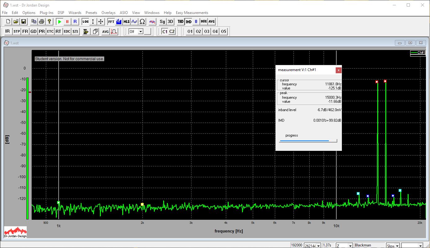

Is this review from you from Jfet input or Valve input stage?Here are the spectrums together with measurements in the following order:
1) THD 1KHz 4.2V RMS - NO OPS
2) THD 1KHz 4.2V RMS - with OPS
3) THD 10KHz 4.2V RMS - NO OPS
4) THD 10KHz 4.2V RMS - with OPS
5) THD 20KHz 4.2V RMS - NO OPS
6) THD 20KHz 4.2V RMS - with OPS
7) IMD 14KHz + 15 KHz 4V RMS - with OPS
Listening - delicious, high resolution, dynamic, natural sound. Excellent elastic low-distortion bass. In fact, very close to the other OPS with 3-5 pairs of IRFPs and EF drivers, based on SlewMonster - well, pretty much ensured by IPS.
Waiting for ksc1845/ksa992 transistors for testing the new IPS...
The new one has got extra 6db of loop gain, plus at least twice as much of VAS current. Will be interesting 😉
Valery

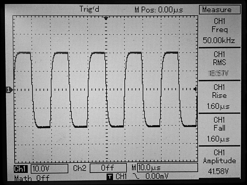

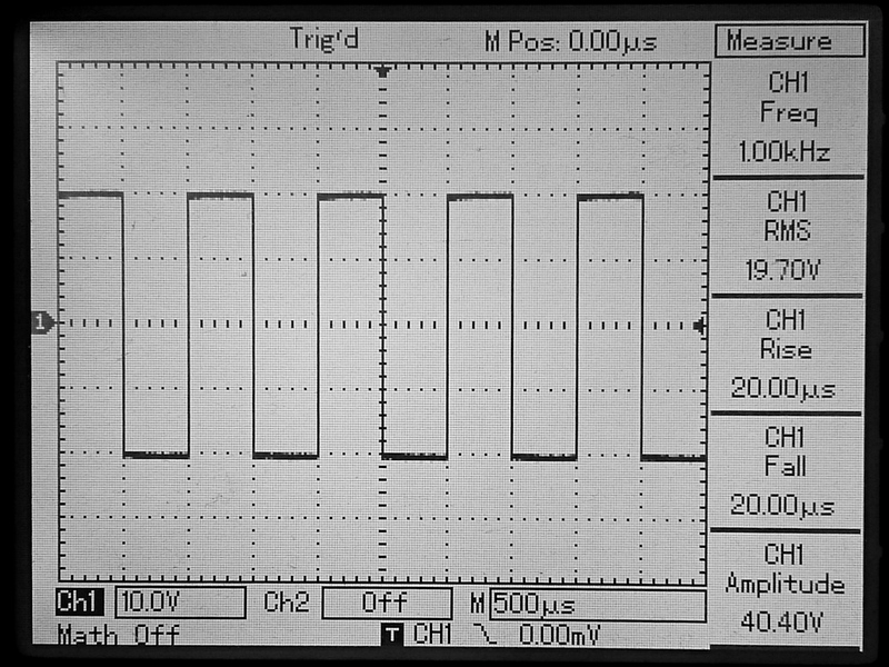

Adapted to +/-50V rails and measured at 50W (20V RMS @ 8 ohm)
Square waves are measured at 40V p-p amplitude.

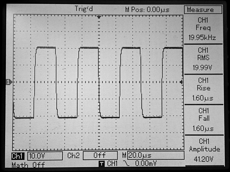

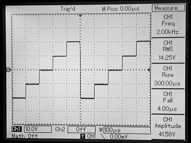

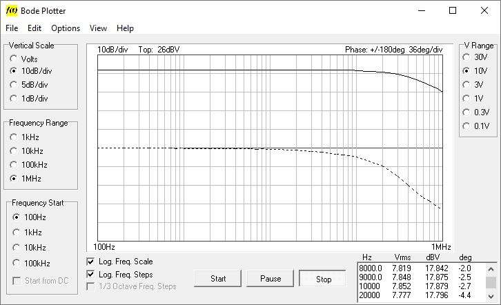

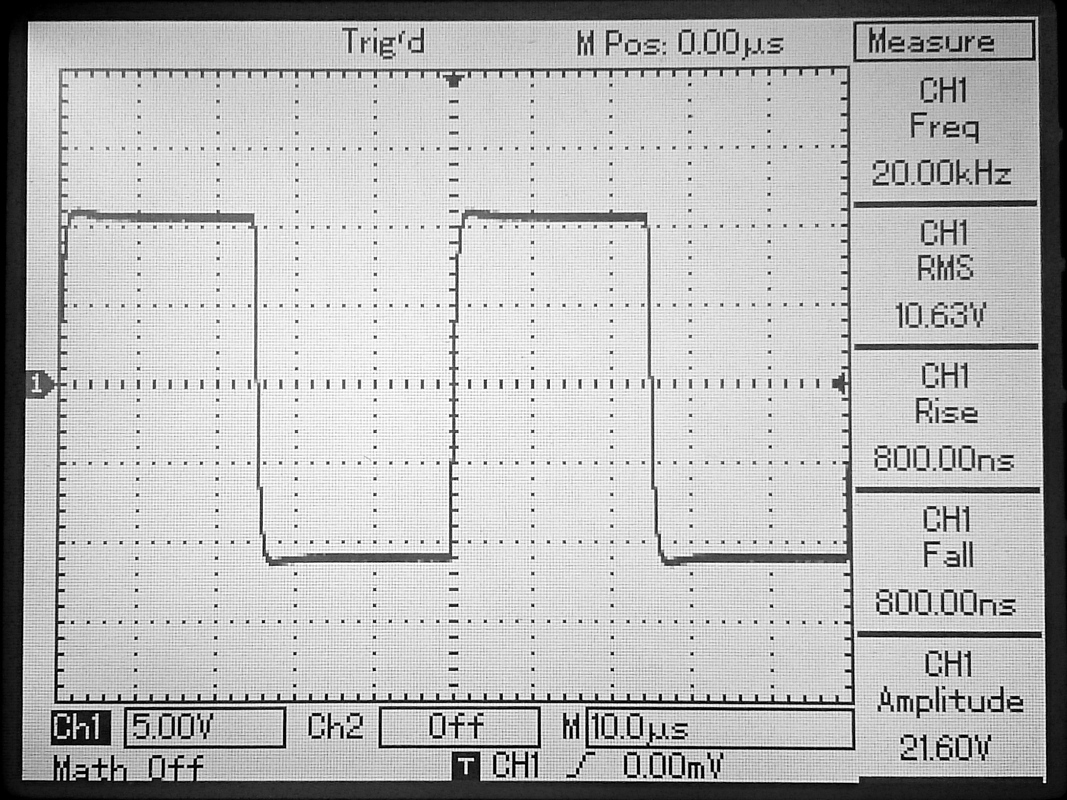

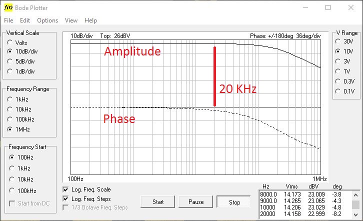

OK, some measurements on IPS alone (~20Kohm resistive load).
I deliberately ran the square waves at high swing - that's where some artifacts normally appear.
Good points - only 3.6 degrees phase shift @ 20KHz, nice clipping, very good square wave response, THD / IMD - no comments.
Pretty fast VFA. Well, OPS will slow it down - we'll see, to what extent...
Checked with a pair of blue LEDs in VAS offset circuit as well as with the double-red pairs. No difference in noise floor. Just not at all. Nothing. Left double-reds for now, but either can be used.
So far so good... Next test - with OPS attached.
Valery

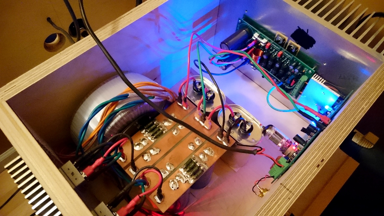

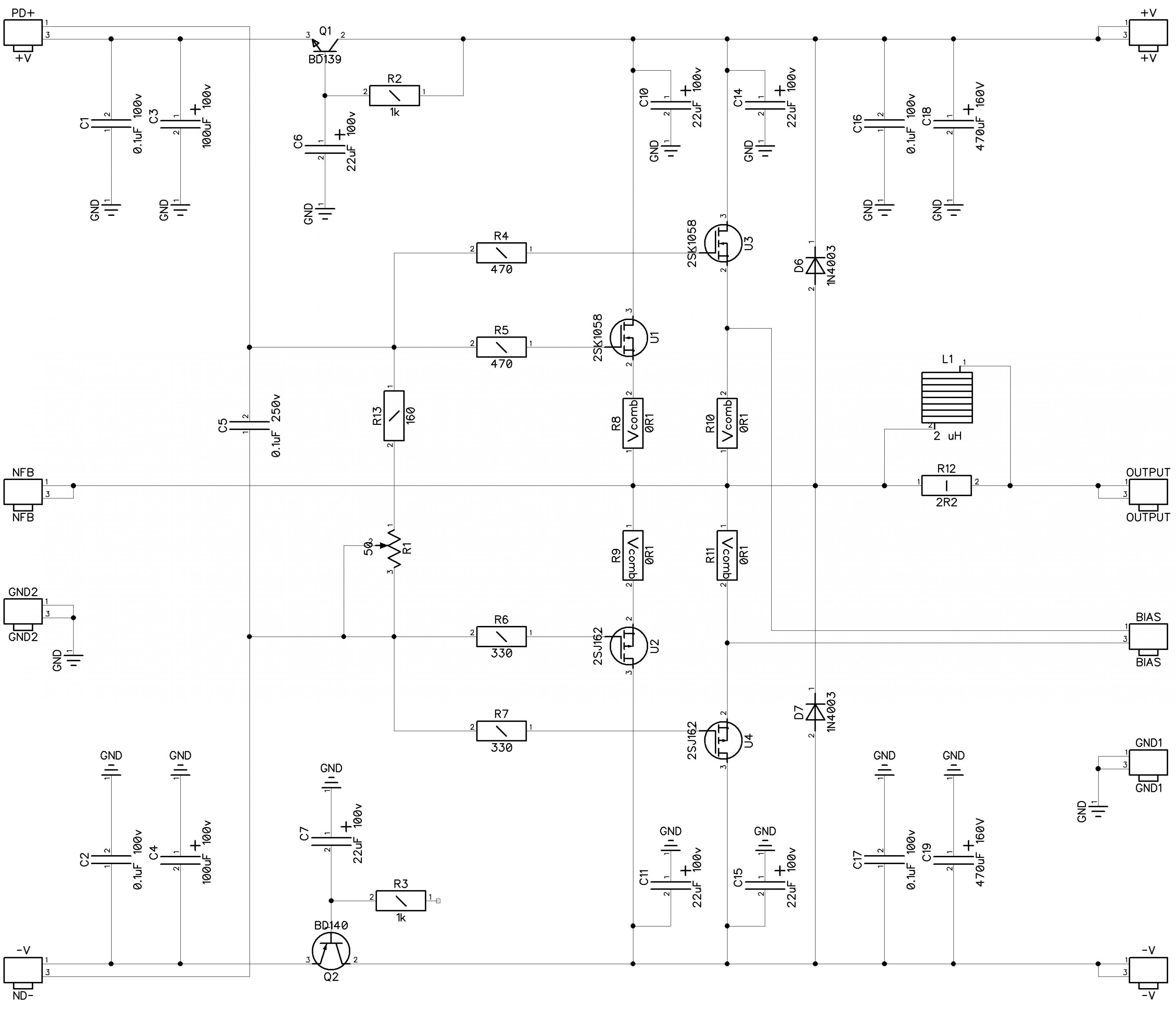

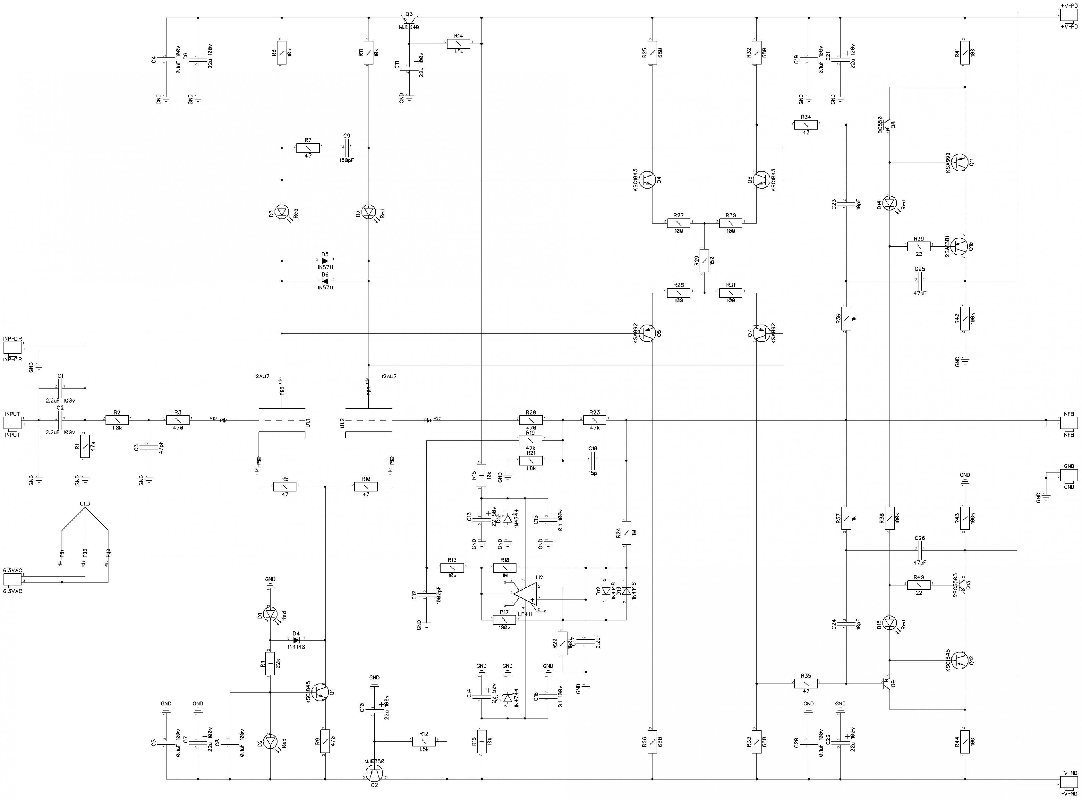

Hi Valery,
I'm at the point where I want to finish off some amps with cases. This is one of the ones I want to do. Are there some changes that I should incorporate in this final build? I plan to do the Vertical with the Non-switching OPS so if you can would you please post a final as-built here for the Tubsumo IPS and OPS?
Thanks, Terry
Thanks, Terry

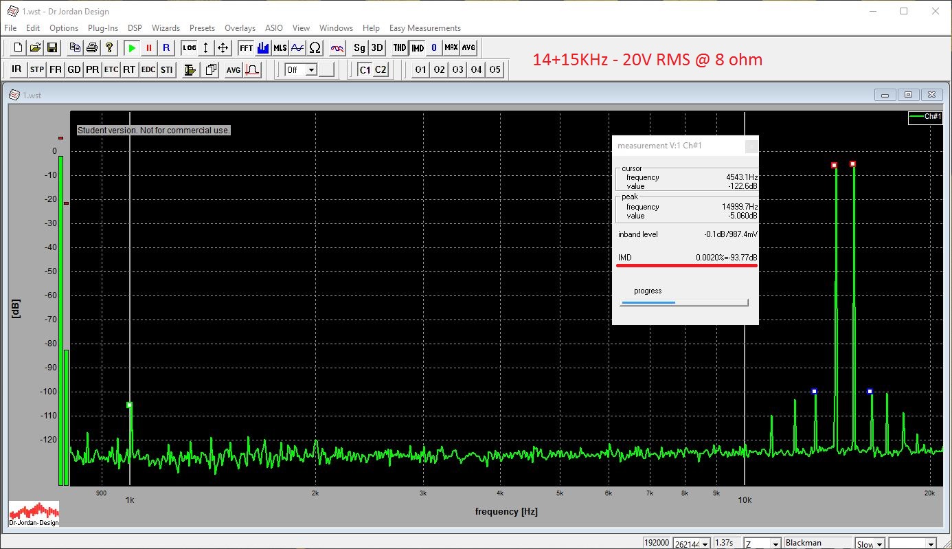

Hi Terry,
Are you reading my thoughts? 😀
Your post came in right at the time, when I was re-measuring TubSuMo with original LatFET OPS after some final amendments (to the OPS, but anyway) 😛
Original combination is still excellent - so I publish the whole thing here for those who may be interested.
However, TubSuMo IPS + NS-OPS is really the top performer - great candidate for the case build. In this case, just see the IPS part.
Key changes, comparing to the initial version (the one you've got, I believe):
R6, R11 = 10K
R27, R28, R30, R31 = 100R
R29 = 150R
D14, D15 - only one Red LED on each side (instead of two)
D8, D9 - 63V Zeners are removed
Still no need to cut traces, just solder the jumpers over two removed Red LEDs.
I run the whole thing with +/-52V rails now. More than enough power (up to 120W @ 8 ohm) at lower temperatures. Q10, Q13 have smaller heatsinks now - barely warm.
This one came to the state of a very mature design now - in terms of quality, stability and repeat-ability 😉
Despite its rather high-impedance feedback network, this is still a CFA-fast VFA 😎

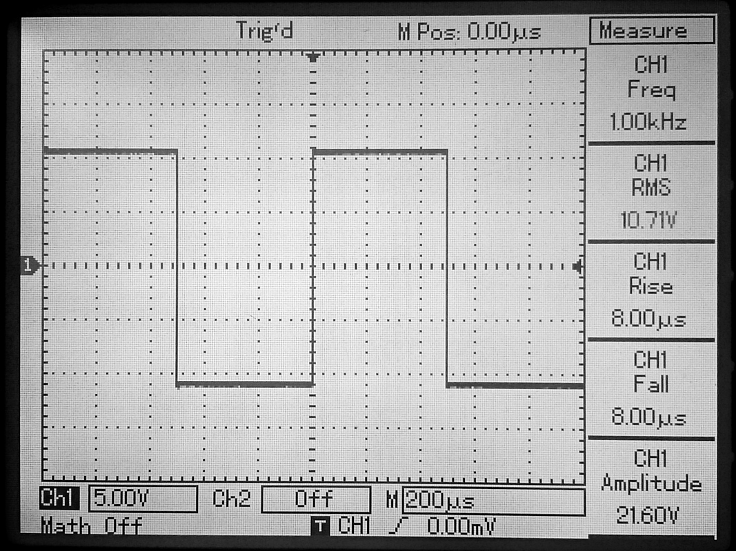

Spectrums presented are taken at 50W power @ 8 ohm load.
Wquare waves - around 20V p-p @ 8 ohm load.
Valery

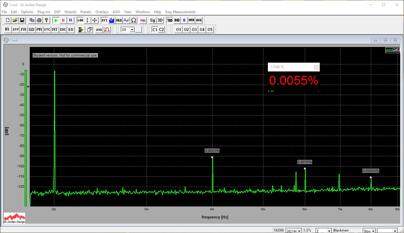

TubSuMo with LatFETs

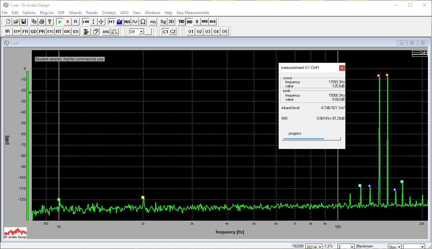

Here are the spectrums for the same configuration, but with 10W output @ 8ohm load.
