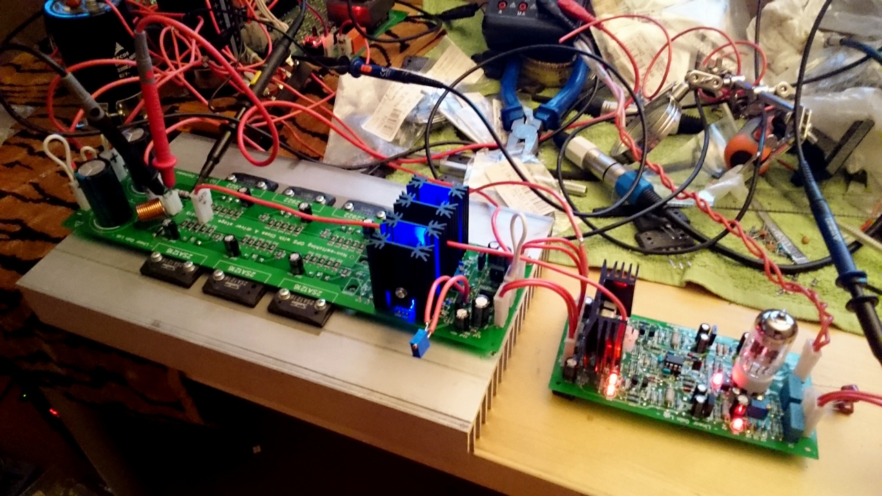

My non-switching output stage is already in place - here is exactly the combination of TubSuMo front-end with NS-OPS:
TubSuMo IPS + NS-OPS test
Both options are excellent - the one with Lateral FETs is much simpler, the one with NS-OPS is even less distortion 😉 Although, with the LatFETs distortion is also very low (but it runs hotter for that).

Lateral FETs show optimum performance at 120mA per pair quiescent current.
Non-switching runs great at 55-75mA per pair. That's the main reason - at lowish power, non-switching is barely warm, but lateral FETs are pretty hot (they like to run hot 🙂). Footprint - yes, LatFET OPS is rather compact. And simple 😎
As you can see, in the latest version I use different values for the gate stoppers in N and P shoulders, and don't use the gate-to-drain capacitors. Together with the changed R27-R31 in the IPS section, this setup gives the best performance and stability (comparing to the initial one).
