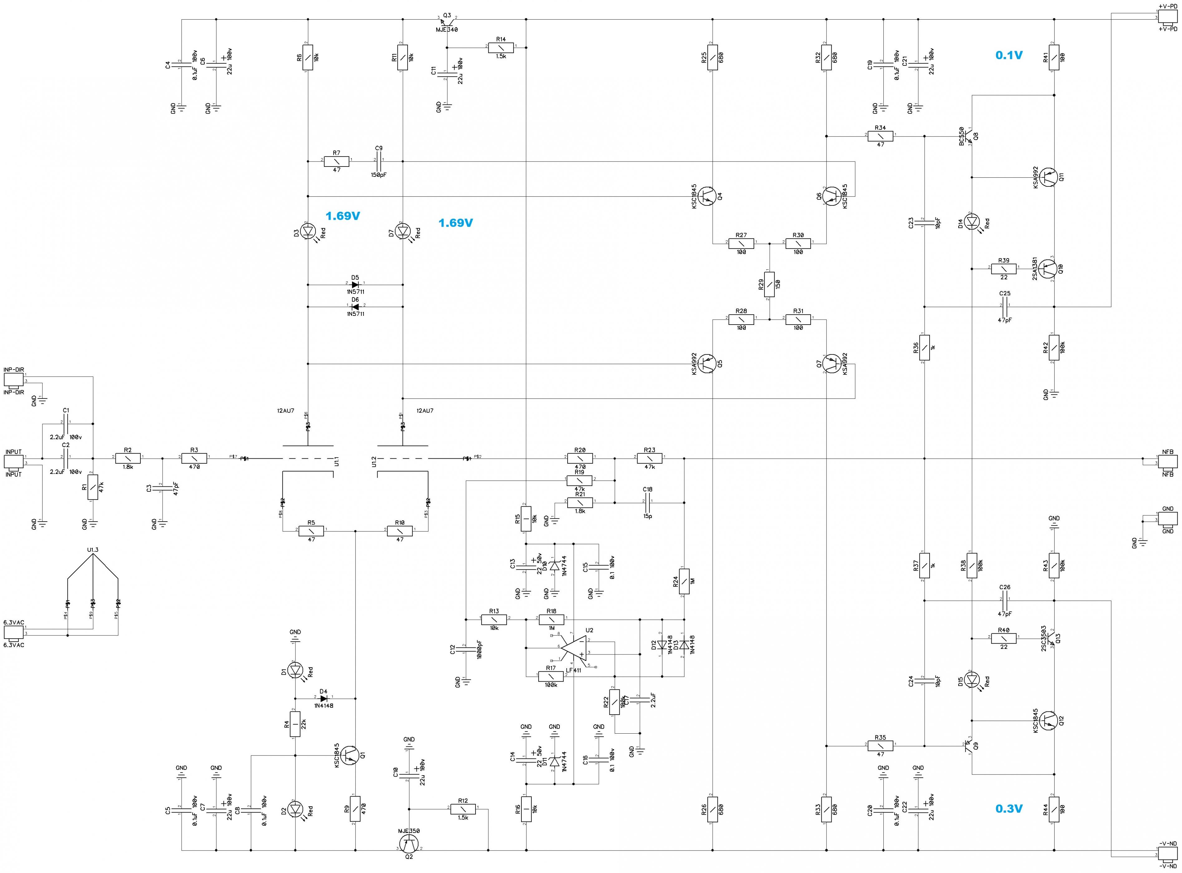

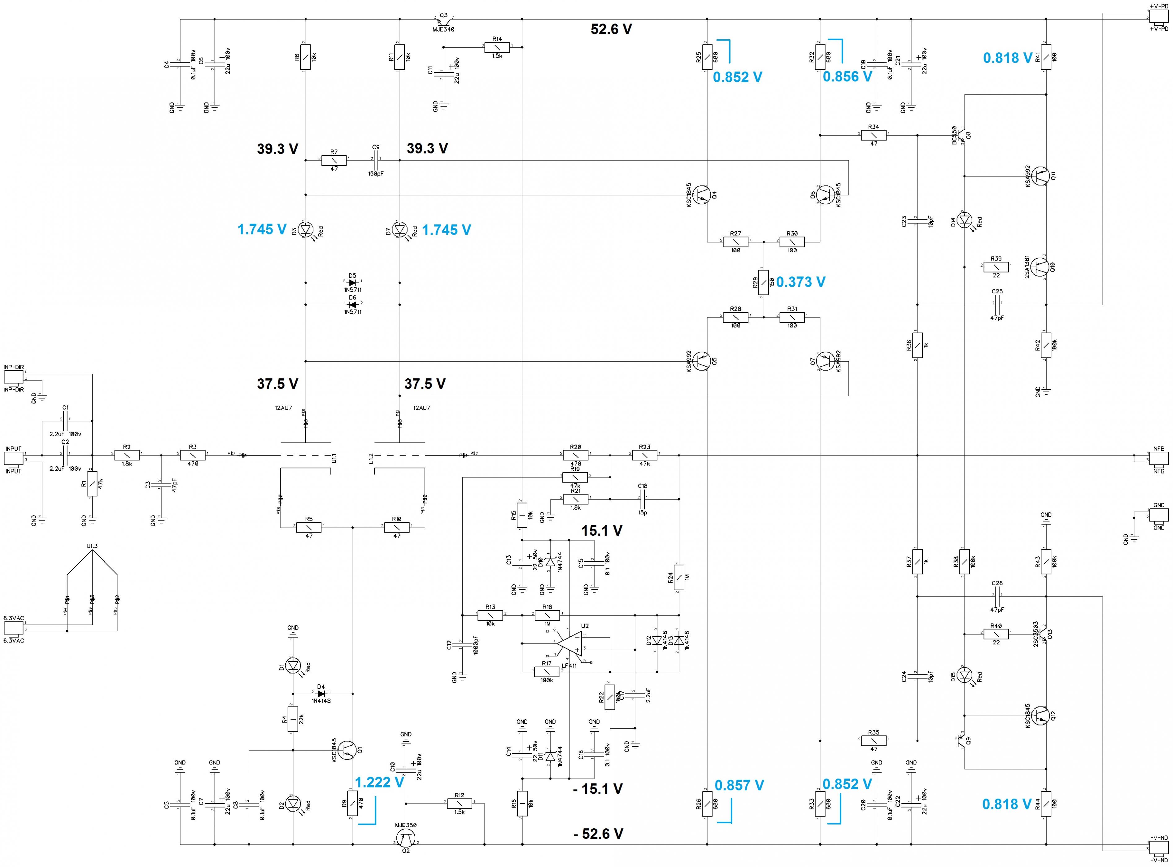

Test measurements on diagram below. I forgot to measure across D3 and D7 before changing R29.
R29 is 100R. D14, D15 LEDs are removed and shorted with wire.
Negative VAS LED still doesn't light up unfortunately unless I short NFB to GND. It stays dark through the whole start up, before, it would light then fade. Interestingly D3/D7 light immediately now whereas before they would begin after a few seconds.
if the voltage across R44 is greater does this mean the negative VAS rail is sinking less current? R41 = 113mV and R44 = 304mV. Both boards are identical in measurements and behaviour. So possibly I have made the same resistor value error on both?
Could try two LED's on the neg VAS?

Hmm ))
It looks like either there is some mistake with the value(s) or your LEDs are a little bit "non-standard". Please try to solder one more 100K resistor in parallel with R38. Keep NFB, PD+ and ND- connected all together and measure DC voltage at that point referenced to ground. Also measure the voltage across R29, R25, R26, R32, R33.

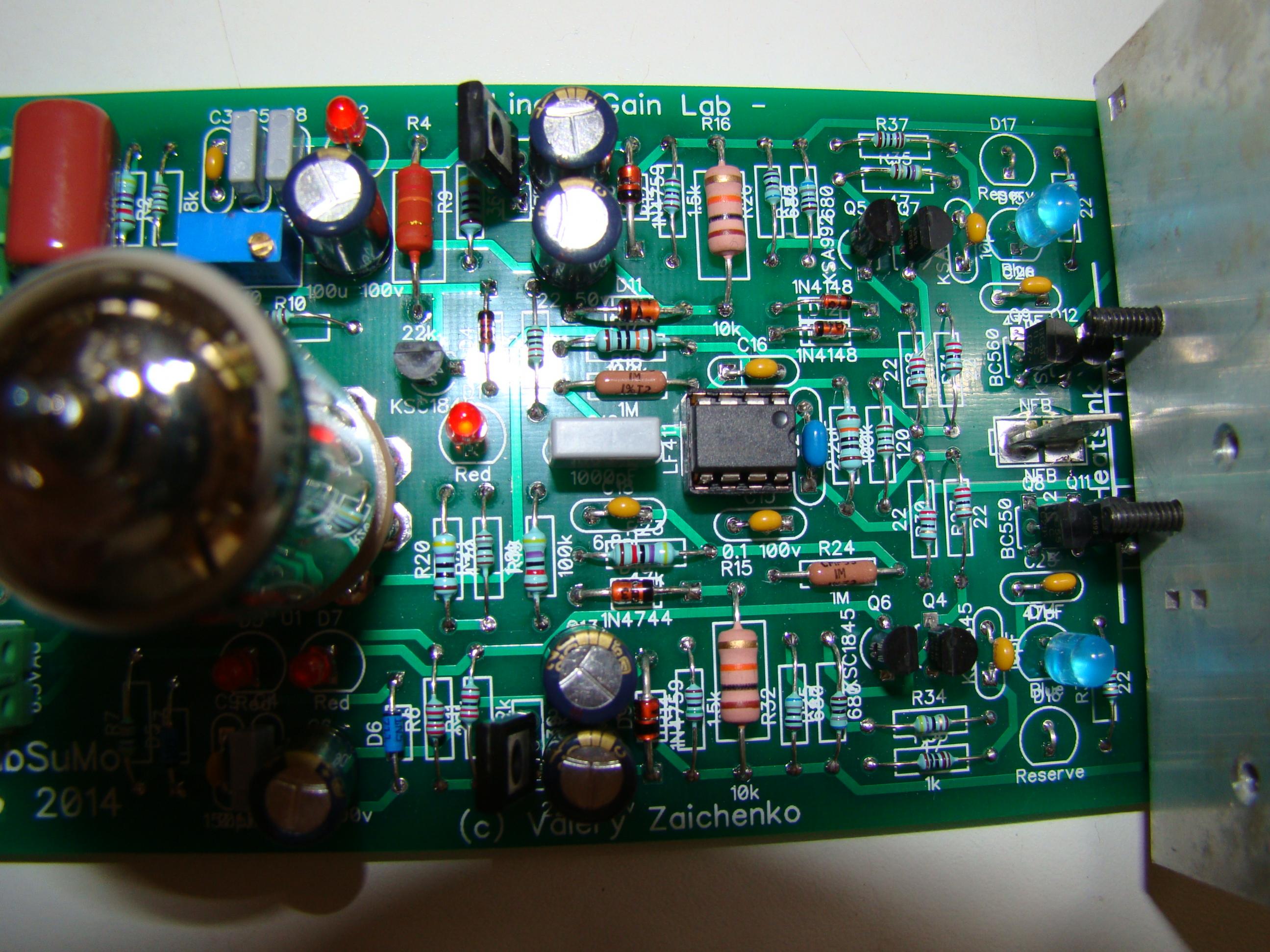

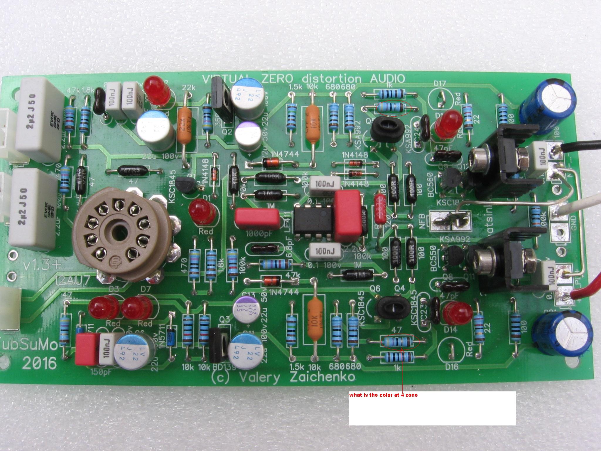

Can you snap a well lit, high definition picture of your board? The one you posted is too dark to see the color rings. If you can, I don't mind investing some time to look things over.

Thimios - the 4th band is gold my friend.
yellow, violet, black, gold, brown

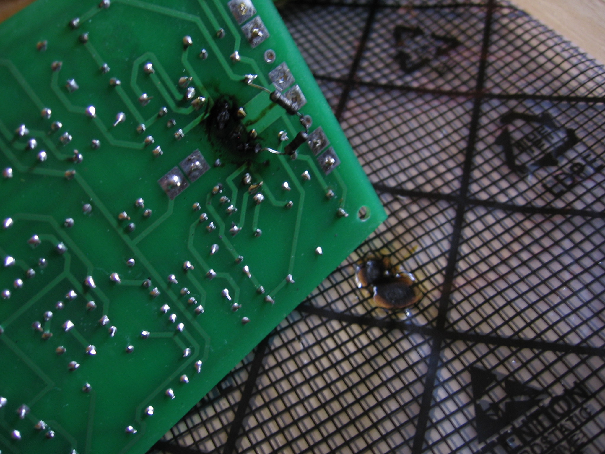

Well, good and bad.
R29 was replaced with 120R. R38 was paralleled with 2 x 500R in series.
The two 500R across R38 (under the board) fried after about 10 seconds. They melted a hole right through a non conductive sheet and into the wood below. They were shunting serious current. I did not have time to take measurements. Damaged the lovely PCB's a bit dammit.
Good news - all LED's lit up immediately including the neg VAS. So we're on to something there.

Connecting two 500R resistors in series will give you 1k. R38 should have an extra 100k paralleled, making it 50k.

2 x 500R in series, paralleled with 100K for R38 was definitely a bad idea. 1K in parallel with 100K. Way too much current. Please be careful - I give you precise values for troubleshooting 😉

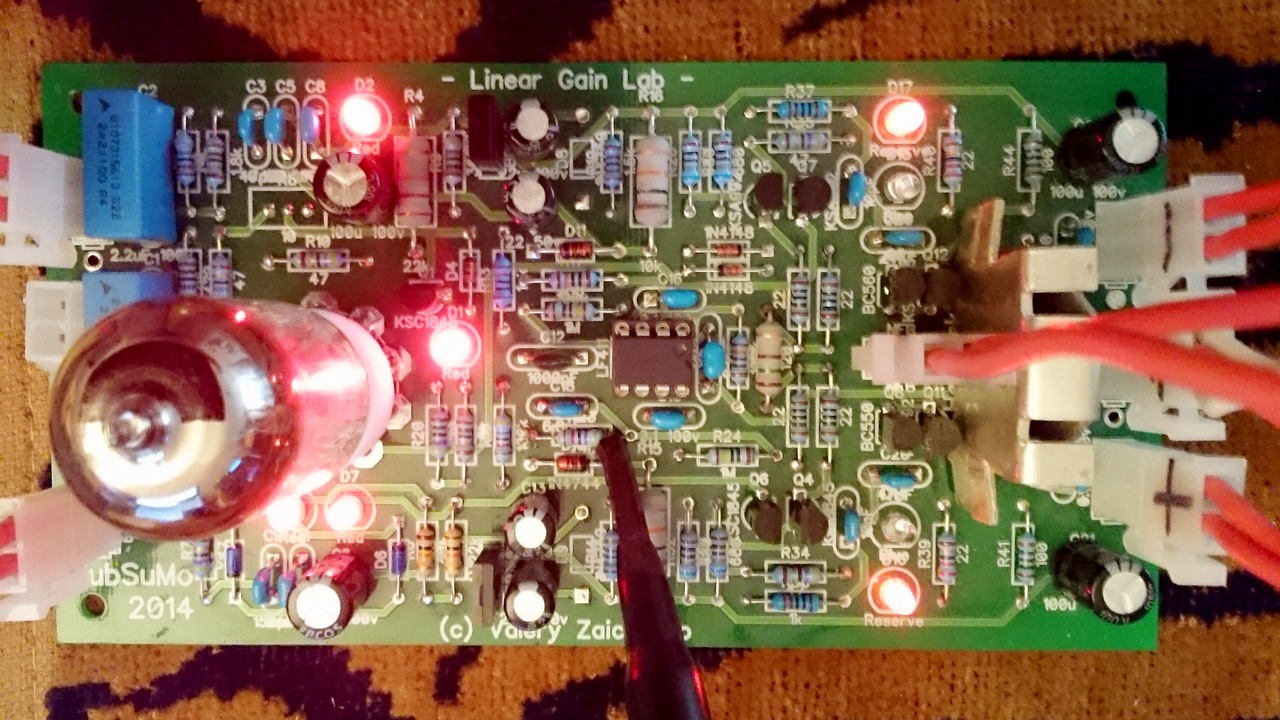

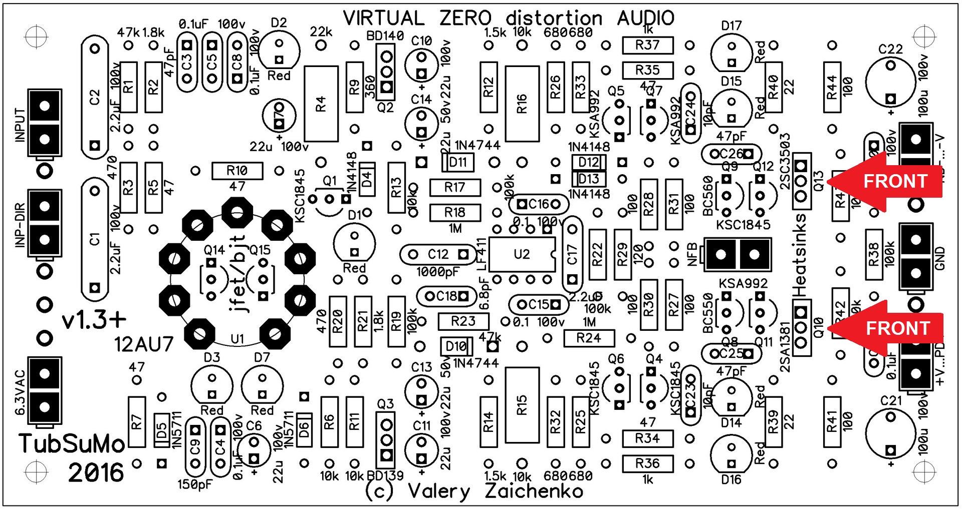

Basic measurements
OK, here are my measurements along with some pictures.
Don't pay attention to the silk screen - this is an early prototype board.
All the values are exactly as shown on the schematic (V1.3).
Red LEDs are 3mm in diameter.
Rich, first thing you need to check again - voltage over R29.
Then - R25, R26, R32, R33. Unless you get 0.85V here - makes no sense going further.
Valery
Valery

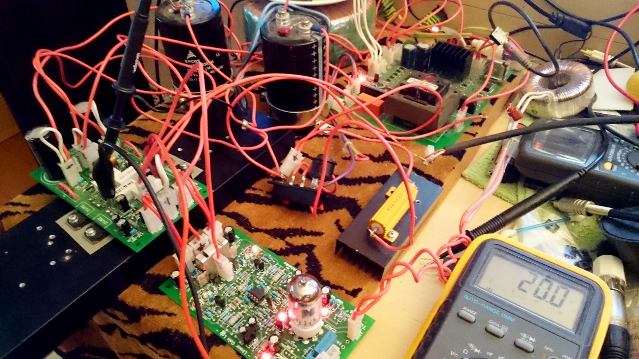

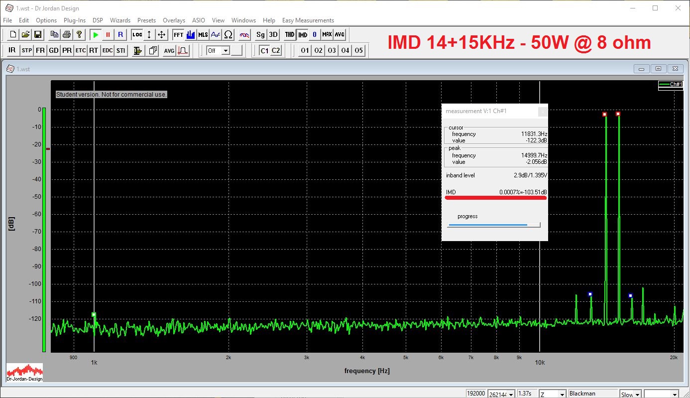

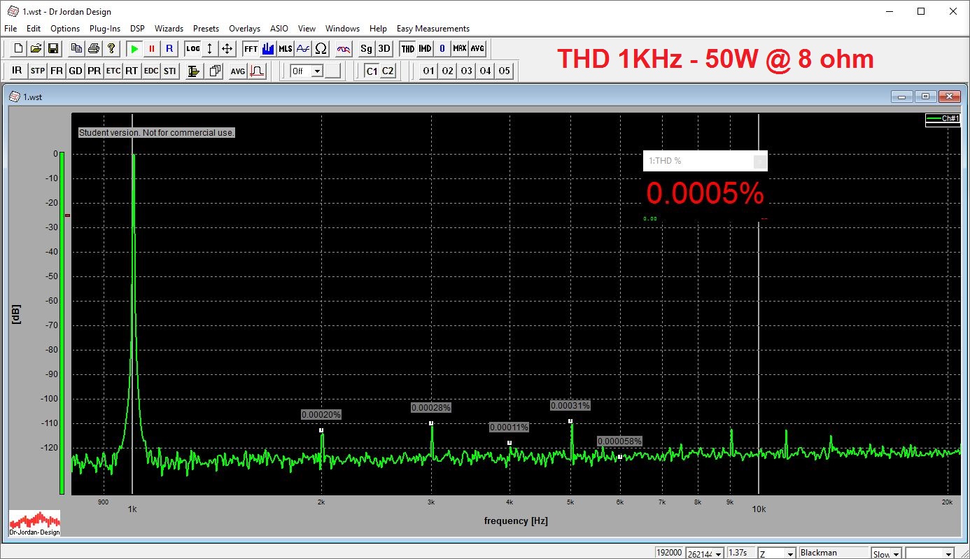

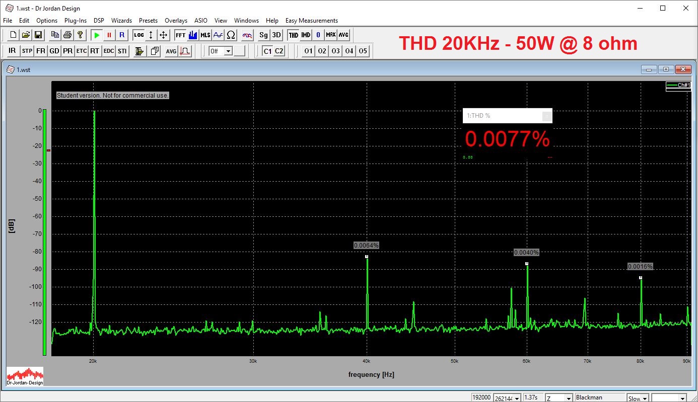

Full amp with 8 ohm dummy load
The amp with OPS and 8 ohm load.
Working perfectly. Bias is set to 100mA per output pair - you can see 20mV on DMM, measured over 2 x 0R1 resistors.
Just re-measured the spectrums for fun 😉

OK. Good enough, but unbalanced. Let's return the values to the initial ones:
R29 = 150R
R38 = 100K (no additional resistor in parallel)

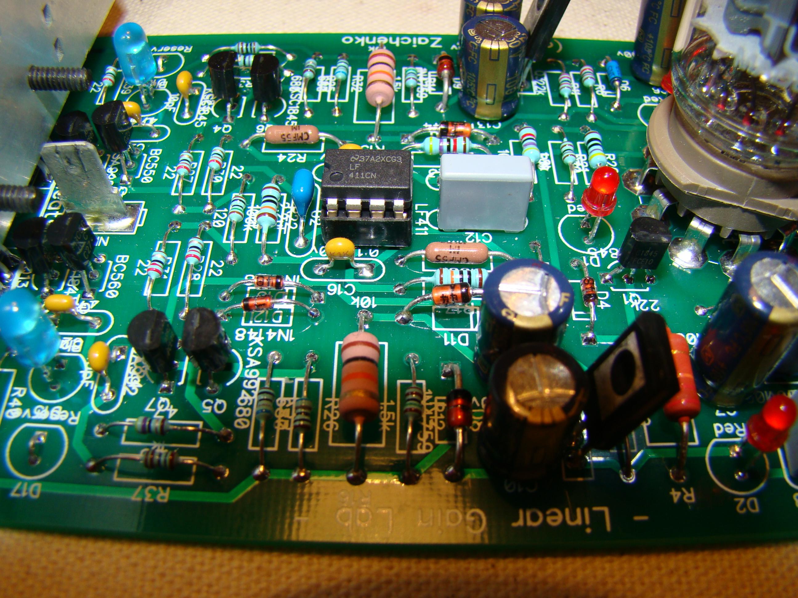

Matching is fine - something else is wrong.
Is orientation of Q10, Q13 correct? The front side with markings has to be on the right (see attached). The base lead hole is marked with a square.
