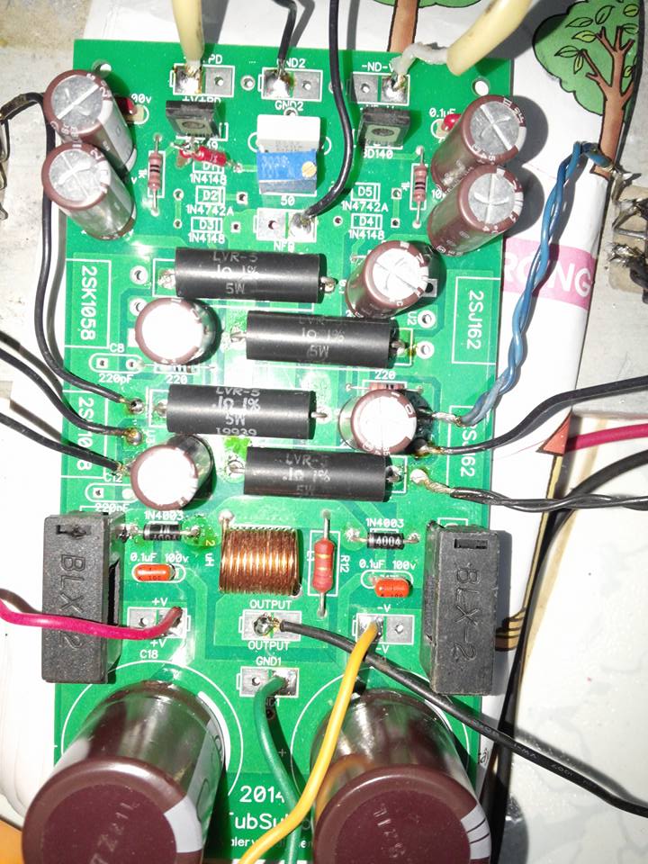

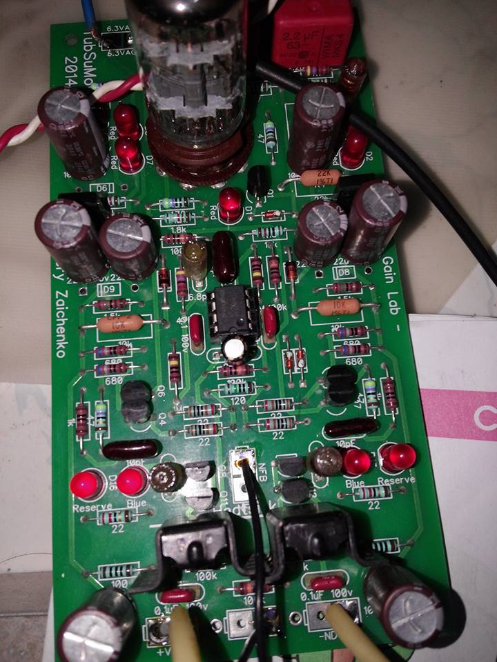

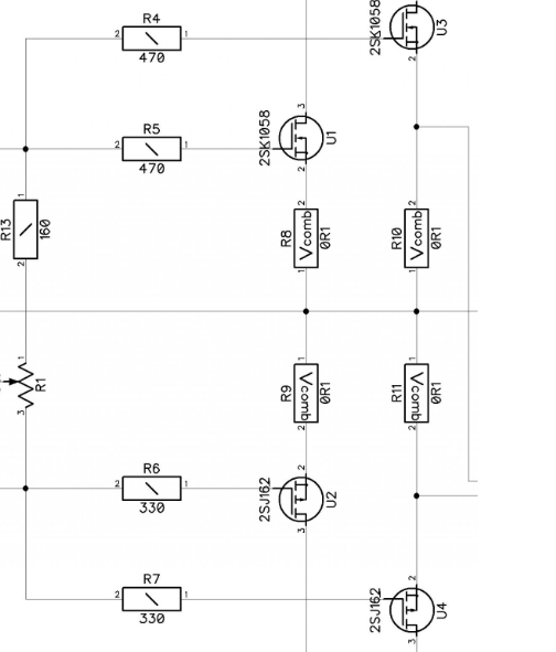

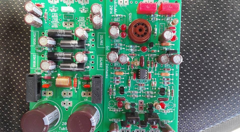

Hi, attached are the schematics and the silk screens of the latest versions. I'm running them with +/-52V rails. D8 and D9 zeners are removed.

why r4, r5 unbalanced r6, r7 sir vzaichenko
