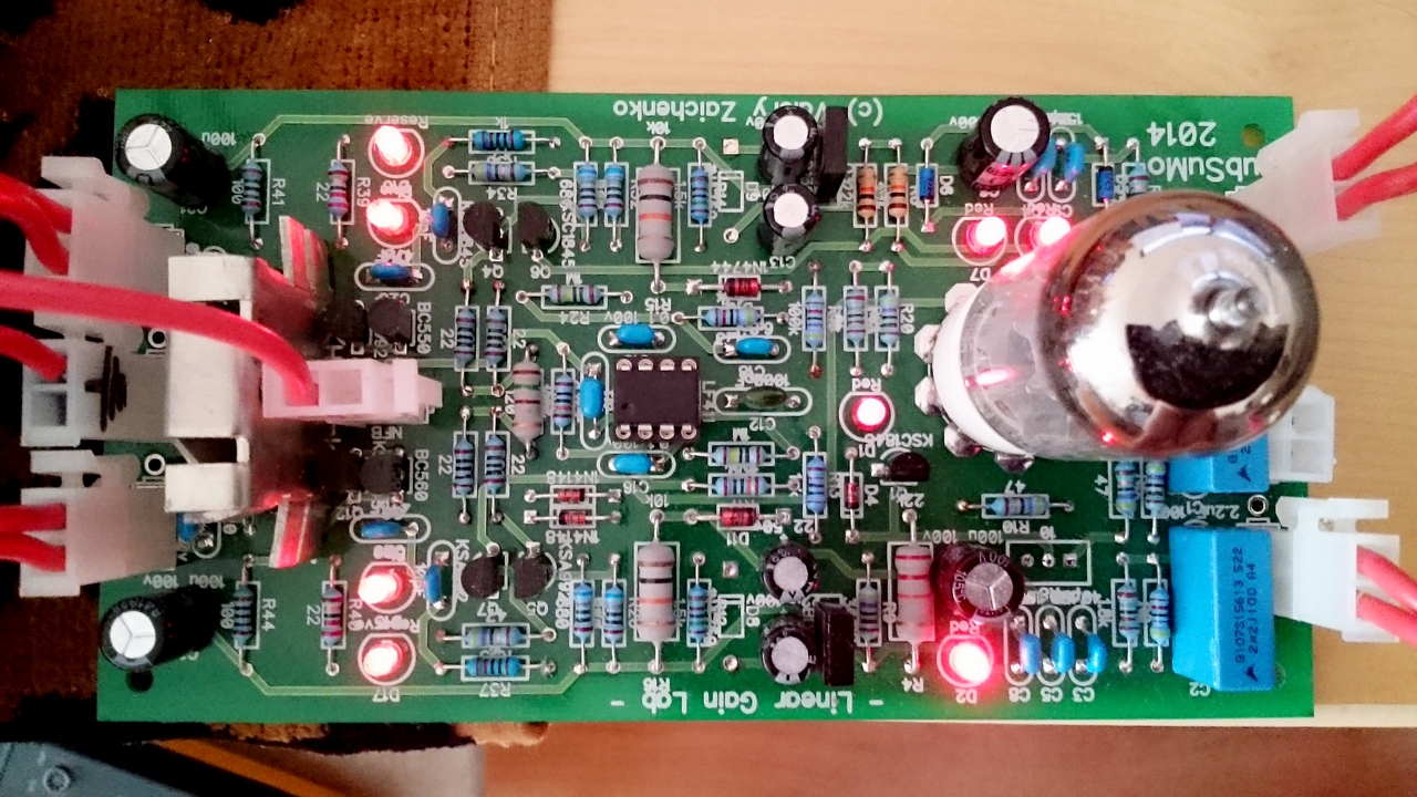

Can you please measure the voltages over R41, R44.
And then - voltage at NFB terminal, referenced to ground.

Let's also see the voltage over R9.
And the voltage at the point where R5 and R10 are connected, referenced to ground.

OK, let's do more measurements around the tube - looks like the problem is somewhere here.
First of all - just to make sure - 6.3V AC is in place and it's really 6.3V AC.
Each tube consumes 600mA, both of them together will take 1.2A. So, the transformer must be powerful enough. You can measure AC voltage on the terminal. Also, the tube's heaters are glowing with orange, as usual, right?
If that's all ok, please measure the voltages:
- across R6, R11;
- across D3, D7;
- each anode and cathode of D3 and D7, referenced to ground (the points where you see 39.3V and 37.5V respectively in post #754.
- the point where R5 and R10 are connected (collector of Q1), referenced to ground.
OK for now - let's see.
Just tried to "abuse" the circuit, powering on with the heater off (no 6.3V AC).
It's showing around -200mV DC offset (not that bad) and almost no bias (VAS current is low). As soon as the heater is on and warmed-up, the output DC trips to -47V and back to zero in about 1 second, and then settles at less than 10mV (output transistors'quiescent current starts from 50mA and reaches 100mA in about a minute or so).

Getting 6.7VAC each tube at the heater trafo terminals. Both tubes are glowing nicely. The Mullards start softer than the Siemens interestingly.
R6 = 11.8V / R11 = 12.2V
D3 = 1.69V / D7 = 1.68V
D3An = 37.5V / D3Ca = 35.8V
D7An = 37.0V / D7Ca = 35.3V
R5 and R10 are connected = -1.8V.
The above on matched but not technically balanced mullard tubes. I could do again with a balanced set.
There is a glow in the neg VAS but very faint, didn't spot it in daylight. Both VAS are quite faint.

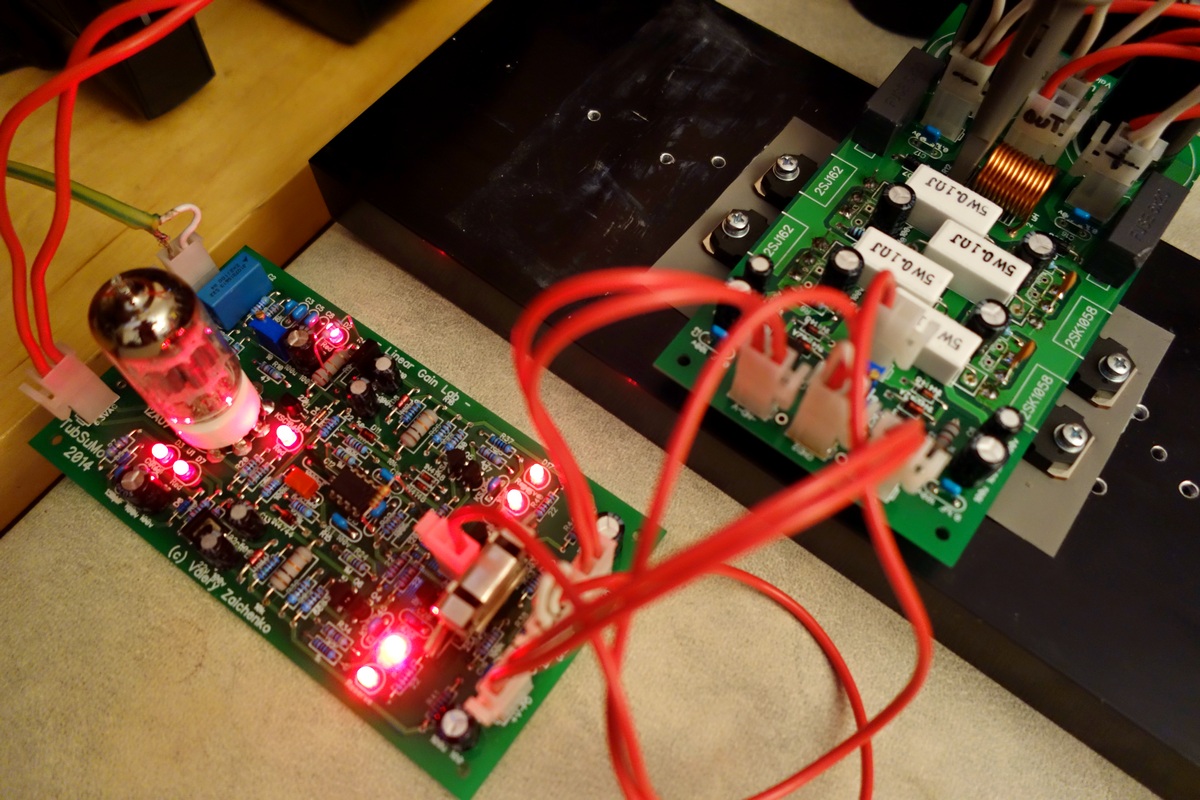

Hello All,
I have finally tested the option with 2 x BC550C at the input.
It requires increased degeneration for maintaining stability, all the rest is the same.
For the test, I have plugged the BJTs into the tube socket and fixed the leads with the wooden tooth sticks 🙂
Solid performance - next post will show the live spectrums with the lateral FETS and NS-OPS.
Valery

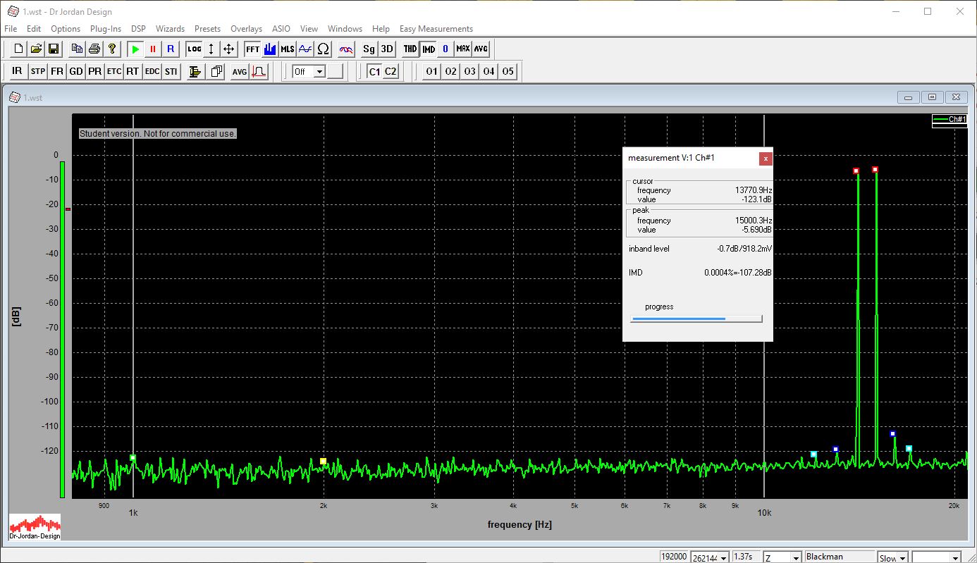

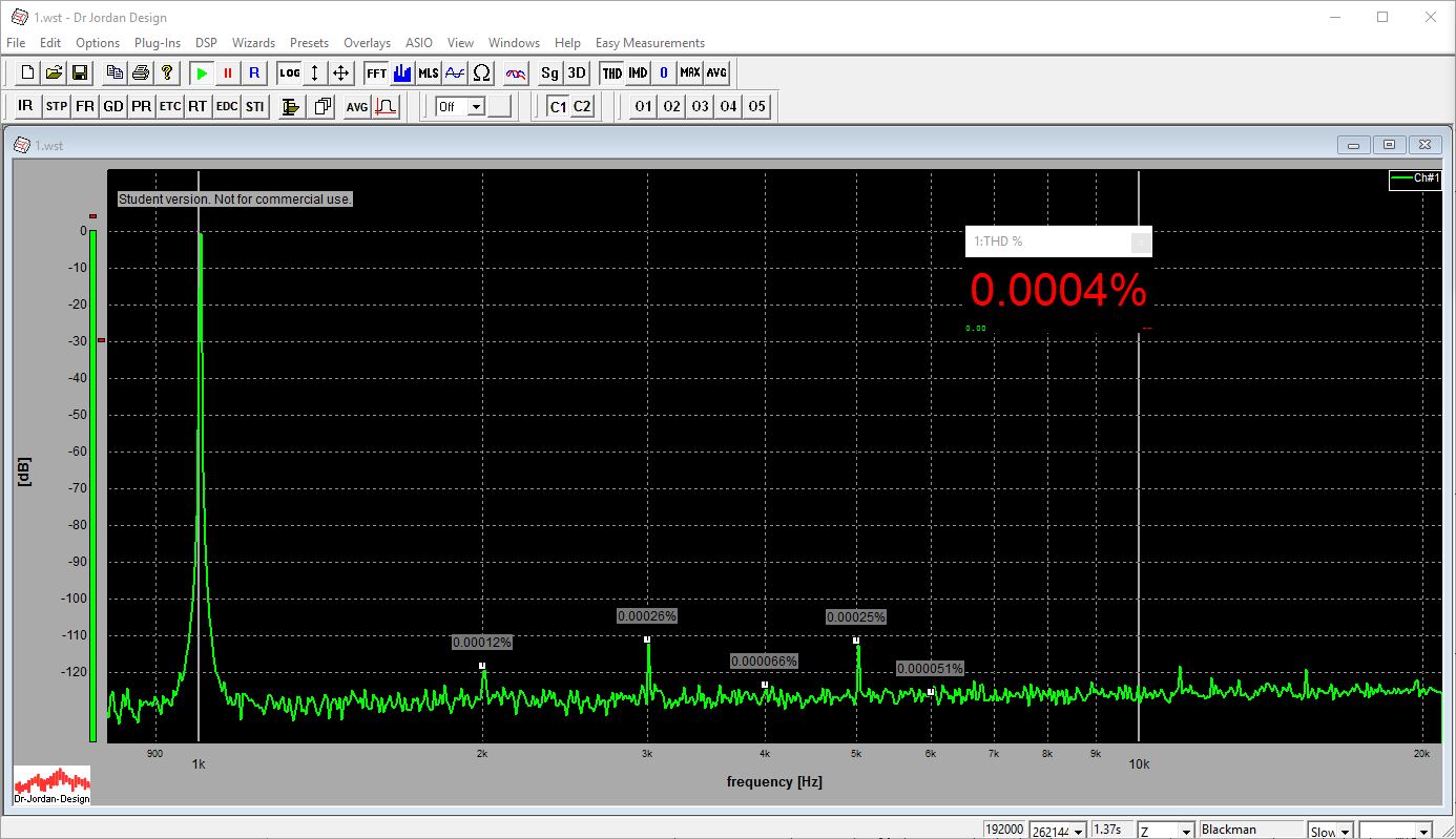

BipSuMo - THD, IMD measurements (50W @ 8 ohm)
Here are the spectrums with very simple OPS - just 4 lateral FETs, and much more complex non-switching OPS.
Both perform really well, non-switching one shows lower distortion - no surprise - however the lateral MOSFETs attract with simplicity, still showing excellent performance.
Interesting observation - this is not the first time, when I see the harmonics at 20 KHz lower than the ones at 10KHz... I don't have any reliable explanation so far... non-switching specialty 🙄
All measurements are performed at 20V RMS at the output (50W @ 8 ohm load).

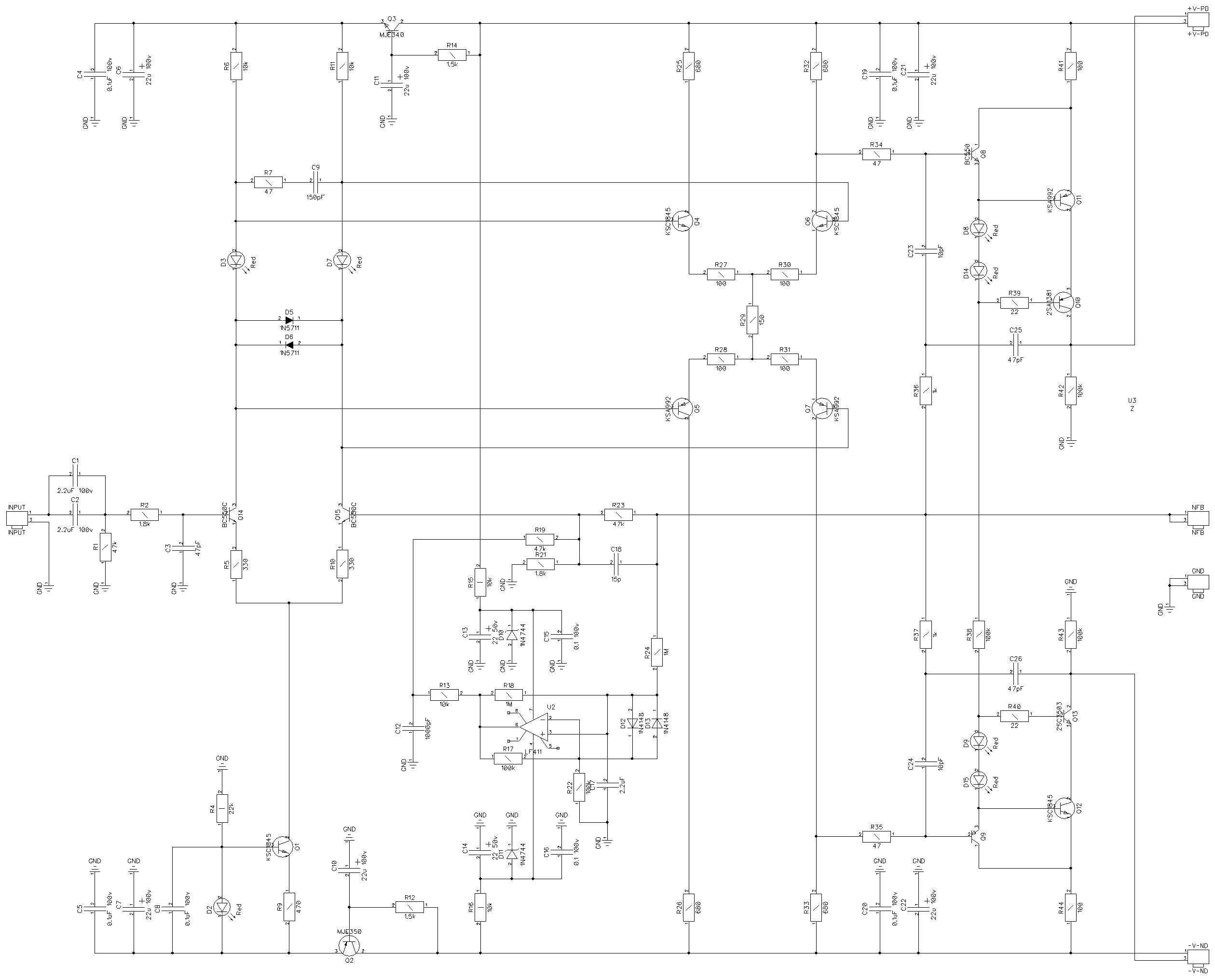

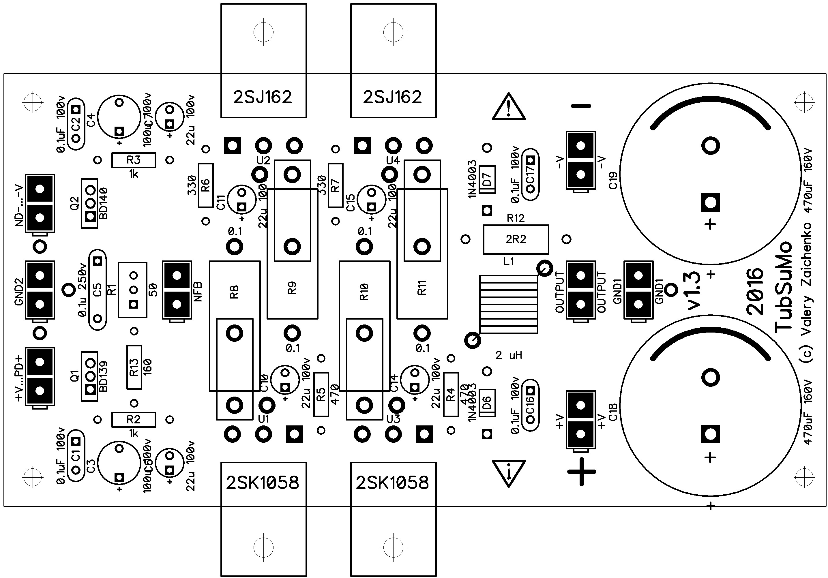

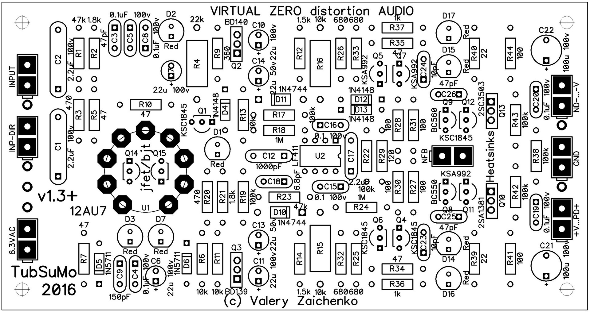

Hi, attached are the schematics and the silk screens of the latest versions. I'm running them with +/-52V rails. D8 and D9 zeners are removed.
Valery
Valery

thank you for sharing zaichenko gerber
but I think that there is a problem that's not good positions 22uf capacitor sizes How many children are too small while taking in my opinion should increase the capacitor 100v large size larger capacitors
he can give me my project files to edit resize foot capacitors are not
thank you very much
thank you very much

Hello Mr. zaichenko I am building and development of this 2014 version
* please tell me what I have to change or not to follow the board components
I follow this BOM was not or is change compared to this BOM
Thanks..🙂
I'm was ready to run with +/-70V rails.Hi, attached are the schematics and the silk screens of the latest versions. I'm running them with +/-52V rails. D8 and D9 zeners are removed.
Valery
are reasonable not, sir
Hi Duyminh,
+/-70V rails are fine, the only thing - for these rails, recommended value for R6, R11 = 22K.
Valery
P.S. Referring to schematic in Post #773
