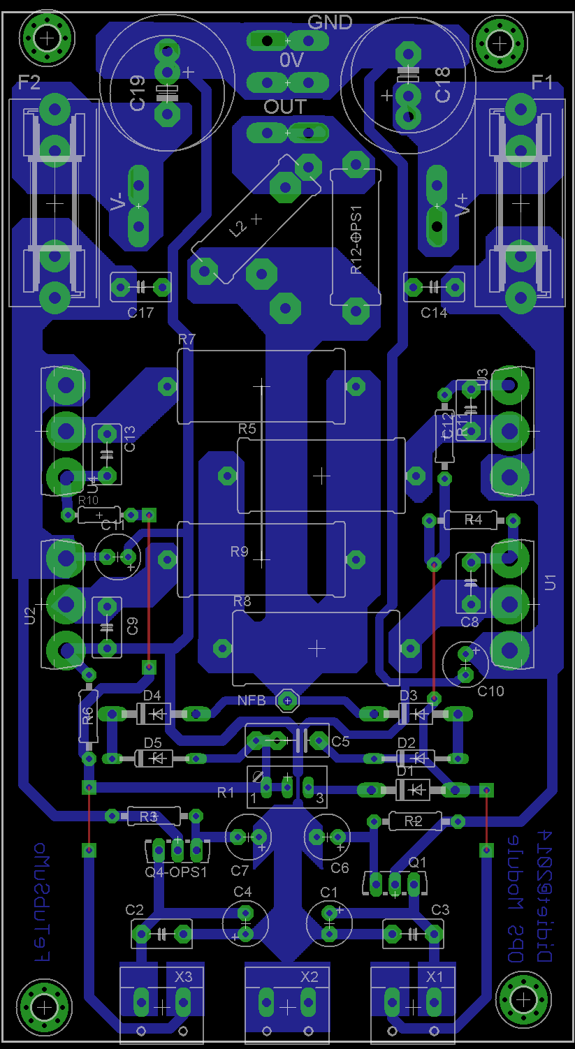

I've received the TubSumo PCBs from Terry (thank you Terry!) and am gathering parts to build. I've got a tube of ALF16N16W/ALF16P16W lateral power FETs that I would like to use. Would you expect a problem to use them?
I've got both +/-55 volt and +/- 72 volt ConnexElectronic switching power supplies on hand. Which would be the preferred voltage? I anticipate bog standard 8 ohm loads. I vote for 72 volts. What are your thoughts?
Any mods to these PCBs that I have missed? I am not aware of any.
Hi Carl,
Good 🙂 I didn't try Exinos Lat-Fets, although I don't see any issues with them. I will check the situation with input capacitance for them - K1058/J162 have got noticeable difference, so we have to use additional caps to balance it out.
If you go for the tube input, +/-72V DC rails are the right ones.
No PCB mods required, just if additional caps will be used at tha gates, the right position will be gate-drain - don't use gate-source places on PCB, place them directly on fet pins.
I will check the situation with Exinos fets' capacitance later today.

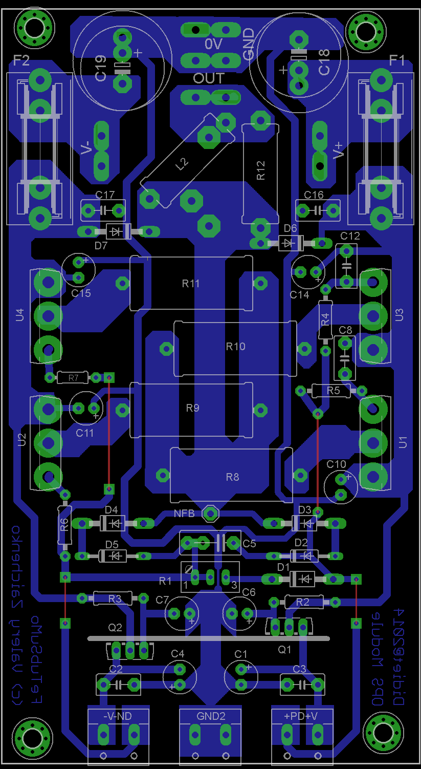

Wow! 😱
ALF16N16W/ALF16P16W ones have got input capacitance at least twice as much comparing to Hitachi/Renesas ones.
900pF / 1850pF respectively, according to the datasheet.
That means, you will have to put 910-1000pF capacitors G-D for N-channel fets.
It will probably make sense to decrease the gate stoppers' value down to 220R, sovthat the time constant stays roughly the same.
Anyway - it will be a useful experience 😉
Valery

OPS . Need cleanup
