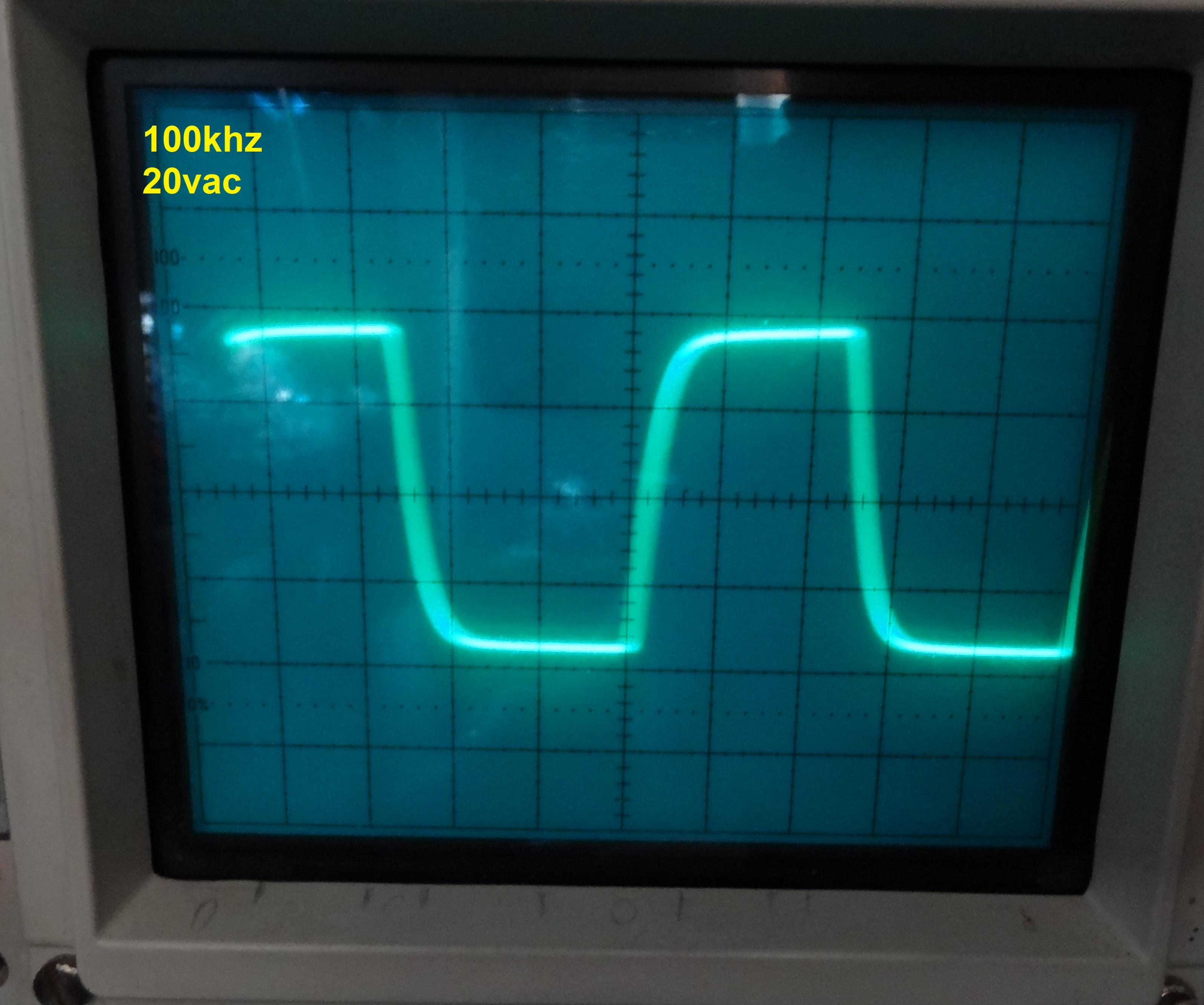

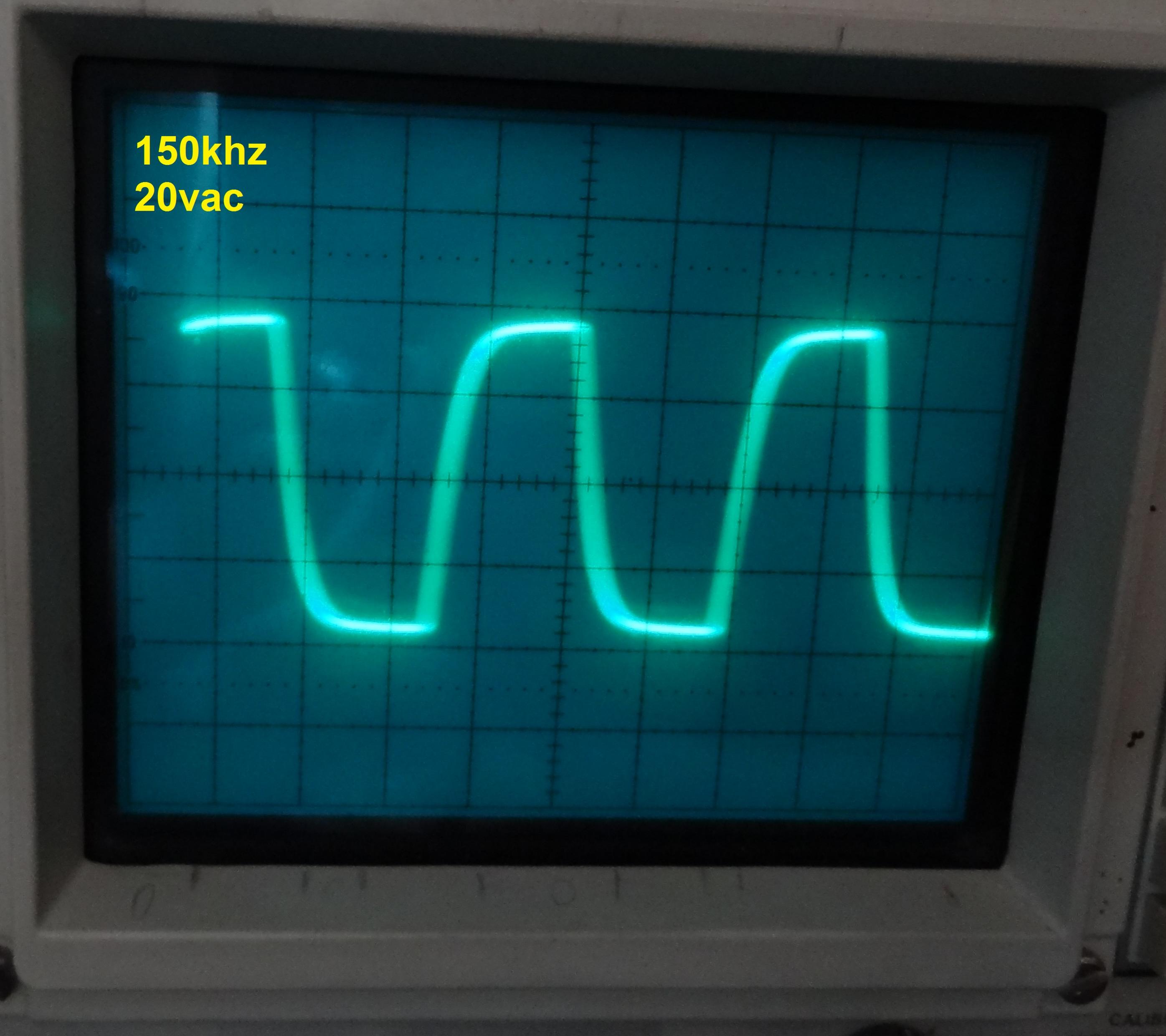

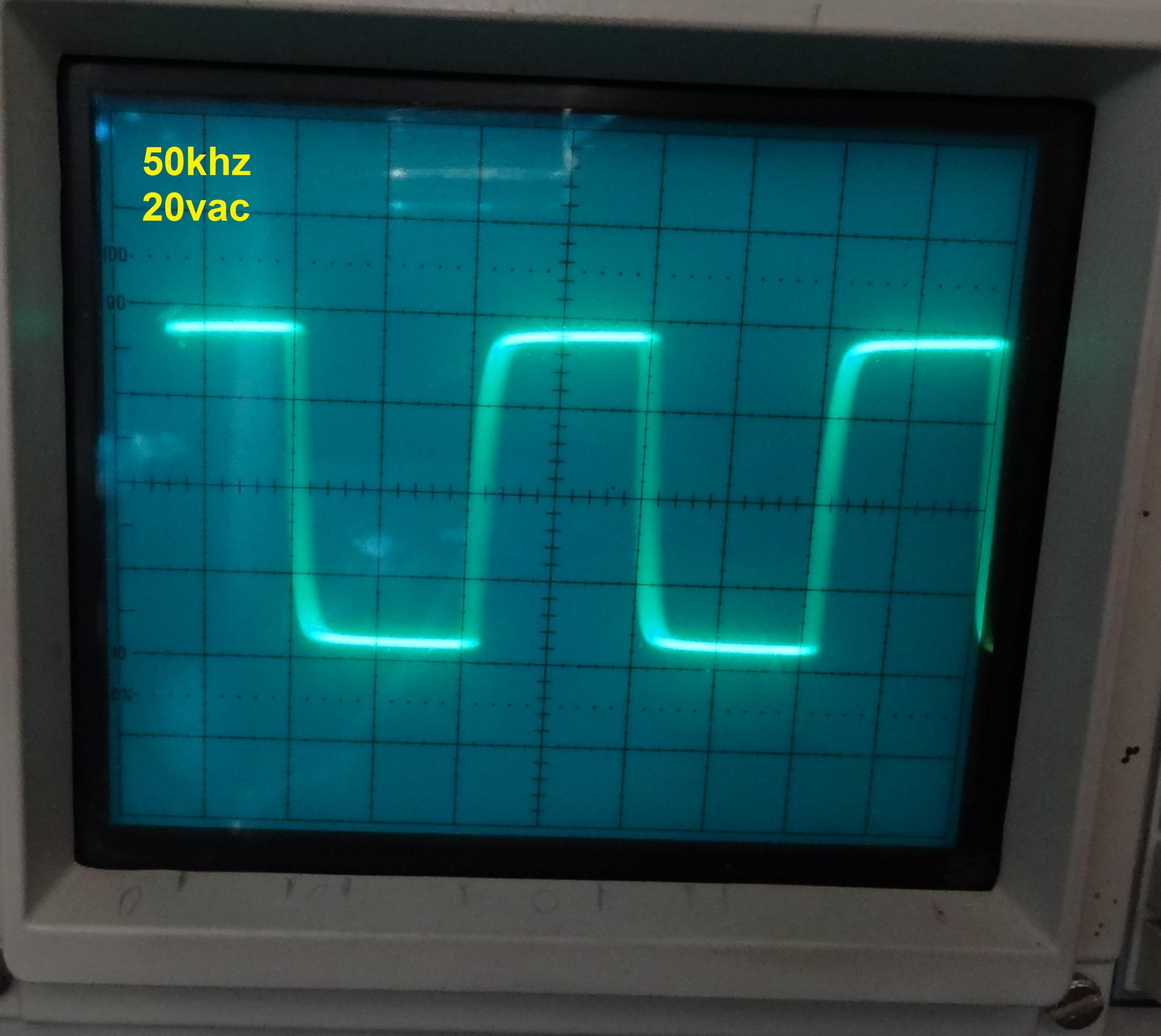

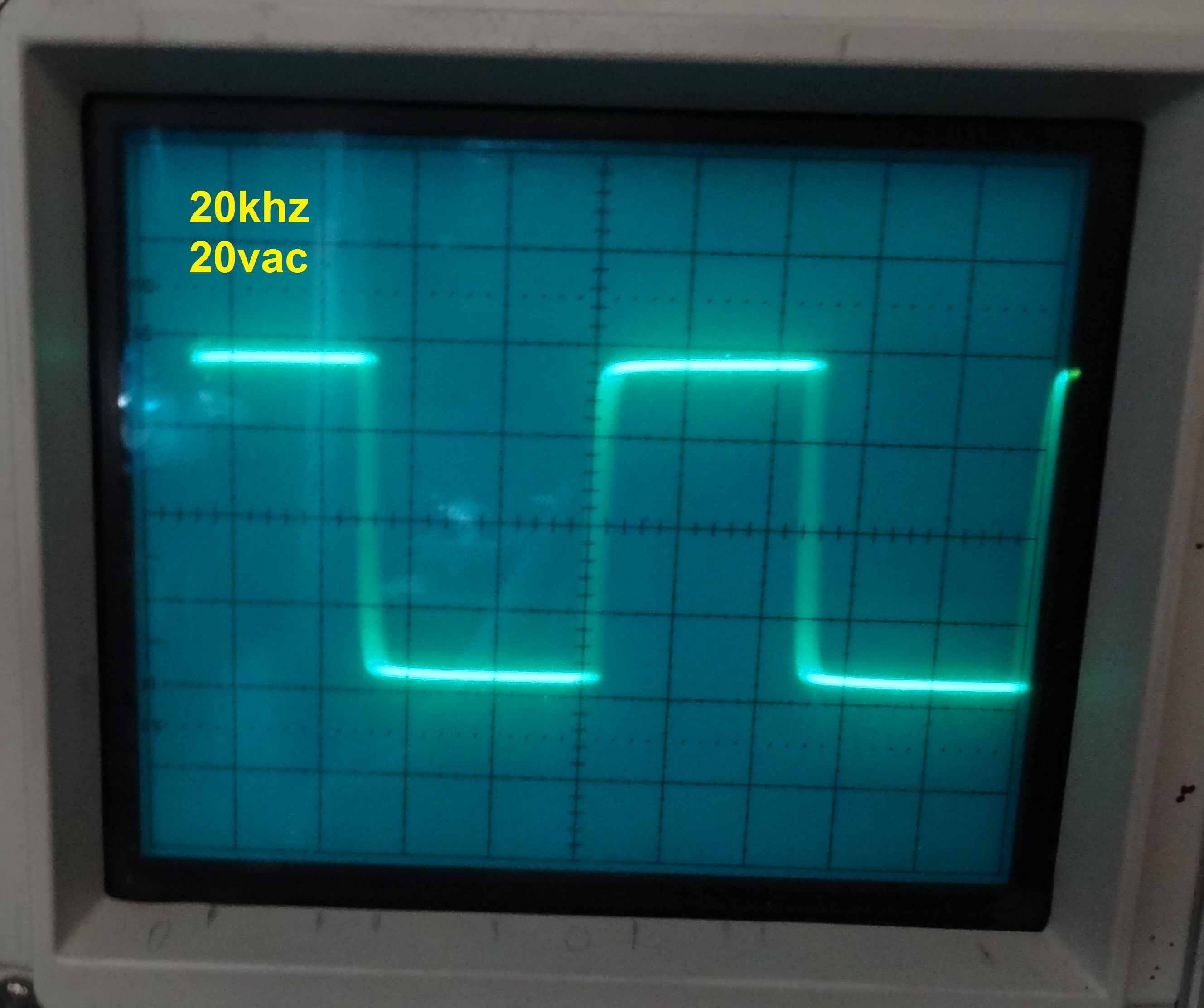

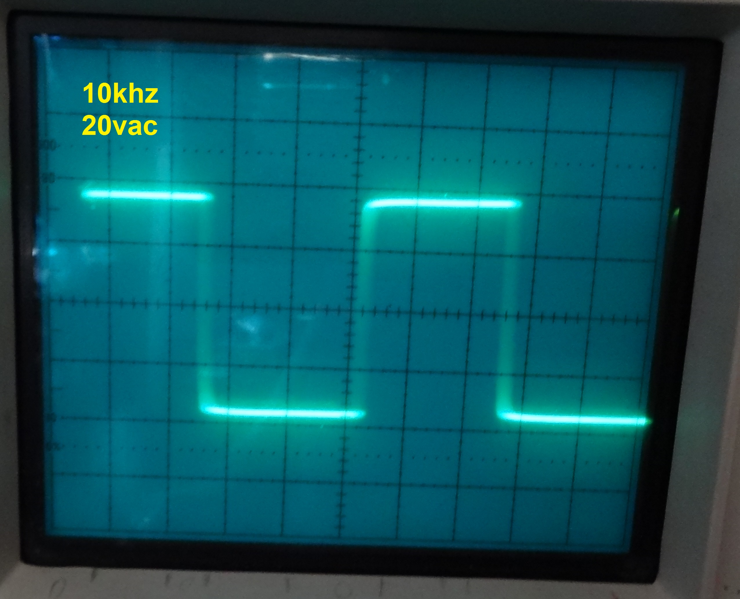

I may have spoken too soon I let it play for about a half an hour and then went out to take some pictures of the scope. I couldn't see any oscillation on the scope when music was playing but when I hooked the generator and dummy load so I could get the pictures I still have a little oscillation. I am really beginning to believe it is OPS related The only thing that changed since I tested it earlier is that the heatsink had warmed up. It only does it when there is a load attached. I took some pictures of some sine and square waves without the load attached for your viewing.

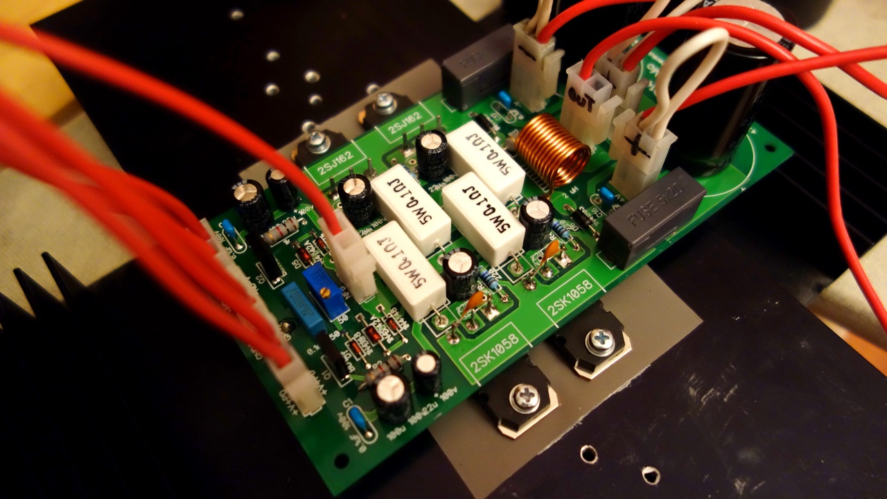

Well, this also may be something to do with different MOSFET manufacturers. When I started testing this setup with OPS for the very first time, I also had some "light" (around 1-1.5 V RMS) oscillation, coming from OPS. So, finally I use 470R gate stoppers and 220pF caps right on 2SK1058 G-D pins. In this configuration it is perfect. Try to start from this one and if it's still there - try to increase the caps value, adding by 100pF or so.
So the caps go across the gate/drain rather than the gate/source that the board are set up for?
Thanks, Terry
That's right, gate-drain is the right position. I have changed it in the updated board layout, but initial one has it in a wrong way. So, better just put the caps right on transistor pins (side ones).
Sorry for confusion 🙄

OK I think I finally have it. Now keep in mind that I have 470R gate stoppers on the J channel and 680R on the K channel. I first tried 220p across G-D on the 2SK1058's. It was better but still some fuzz on the top of the square waves. So then I tried 330p and it was worse. Then I tried 150p and it looks perfect. Now I can't say if the original 330p caps might have done the job with 470R on both sides because I just installed the caps in the holes provided. It is playing beautifully now. I will keep an eye on it for the next few days and make sure it doesn't start oscillating.
