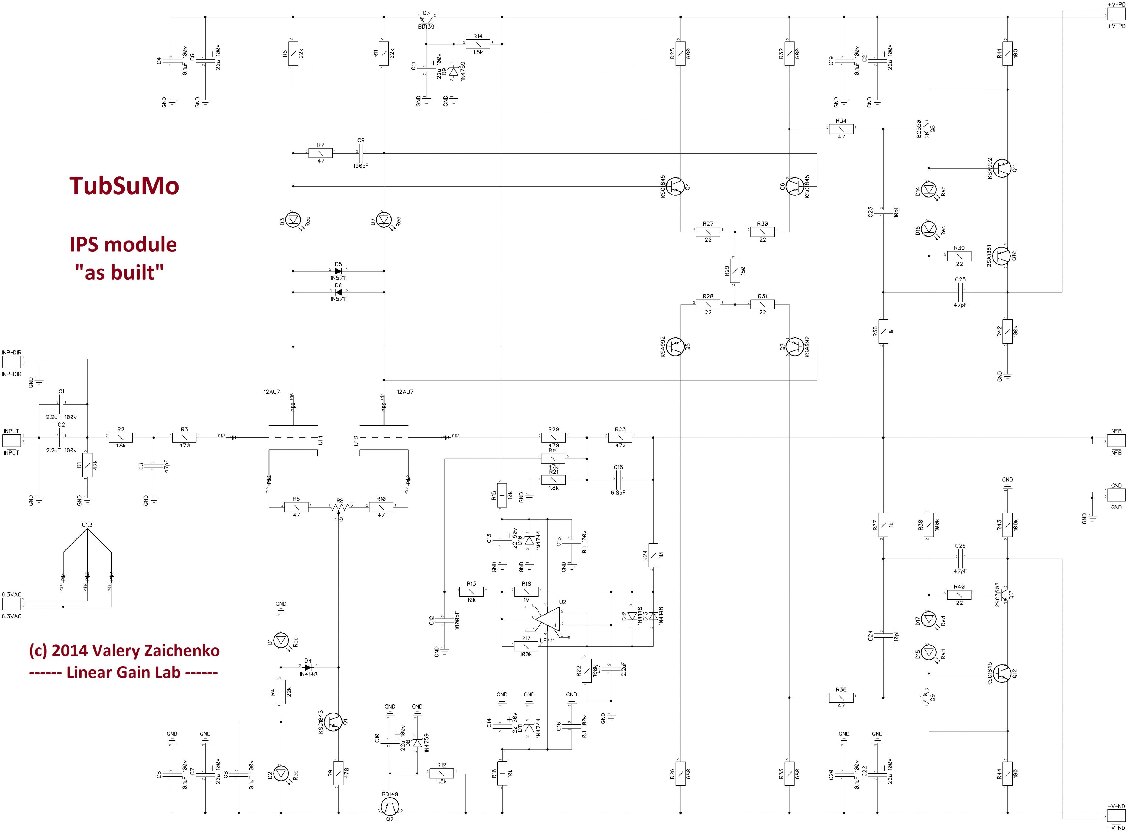

I'm starting to build up the ips boards I got from Terry and have come to the first of what may be many questions. For Q 10/13 it seems that 2sa1381 is E rank and the 2sa3503 is D rank. This is what the suppliers have available. Would this cause a problem? I see that there is an overlap of hFE between the two ranks. Can someone educate me on how to test this and see if I can get a bit of a match for these parts.

Hi Evan, I've got from Mouser exactly the same ranks - ksa1381e and ksa3503d. Practical measurement with multimeter shows hfe around 150 for "E" and around 100 for "D" ones. This is fine - having rather high OLG, this design allows this kind of tolerance.
Using DMM with hfe test is fine for the purpose. Measurement is based on a simple principle there - it sets some calibrated base current and shows you collector current equivalent.

Is it safe to run Tubesomo at 63 volts? I'm cleaned out of 100 volt caps. Nothing to filter a 50 0 50 transformer for testing.
Hi Jeff, it is safe, but it is on the edge - there are zeners at the rails for input section, they are exactly 63V, so they will be somewhat "starving" for current... resulting in a bit lower rails for the tube. It will still work, but probably with a bit higher measured distortion (although, you'll not hear it, most likely).

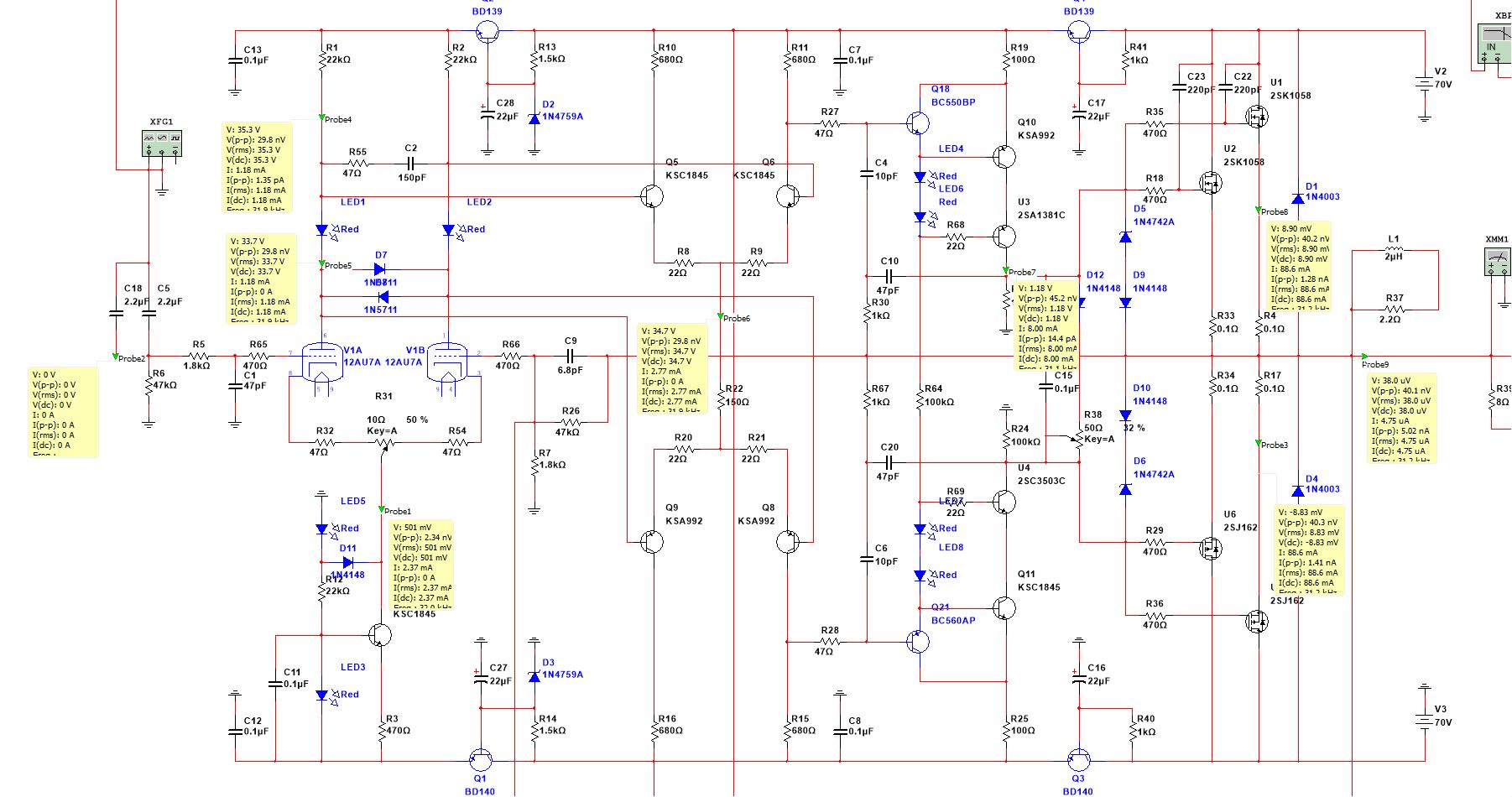

I'm finally back to starting up Tubesomo. I'm getting voltage on the input with the input(not the direct one) shorted. One tube is -9VDC, the other tube is -.3VDC. These were two brand new matched triode tubes. Can a tube produce voltage on the input normally or do I have two duds?
Hi Jeff,
No, the tube is a high-impedance device (somewhat similar to jfet), so in normal operation you should have literally zero voltage at the input.
Something is wrong.
Will there be any issues if I fire the input stage up with no tube? Both boards are behaving exactly the same. -.5V offset with one tube, -25V with the other.
It will be no trouble, but they will not work properly - global NFB will not work, you will have DC offset at the output - the circuit will be out of balance.
Input stays at 0 volts with no tube installed. That's the best DC offset I've seen on the output too. The servo seems to be working.
Everything is considerably lower than your schematic. I'm dropping 10 volts through R2 and R3. Are they overloaded?
