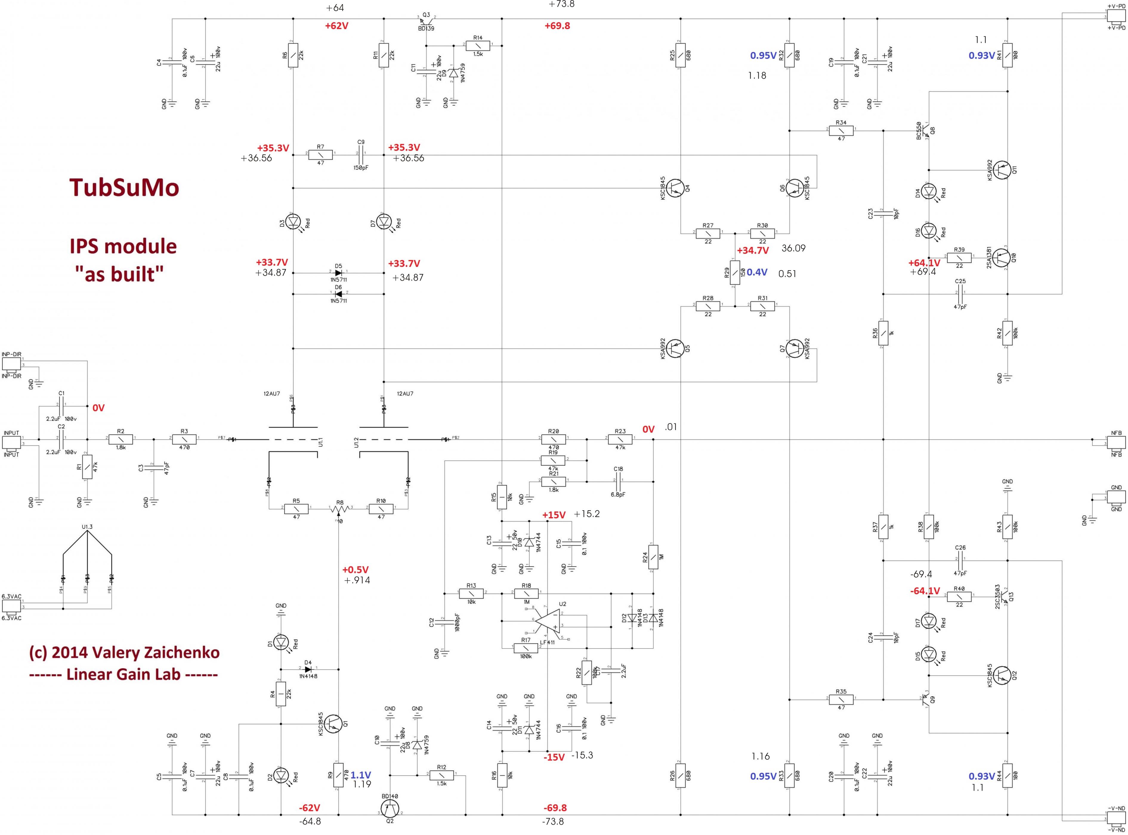

They look ok actually... the only thing which is strange - where does the grid voltage come from? From the grid itself?
Are you sure, R1 is 47K (not 470K by some reason)?
How high is the voltage?
Does the circuit balance itself (close to zero DC offset at the output)?
I've double checked R1 several times. It's definitely 47k. Voltage is still there but lower with a 1K resistor across the direct input. Voltage changes with tubes. I think I saw -9V with one of my matched tubes. It's different with every tube and is completely gone when the tube is pulled. With a tube installed I see a small voltage start to build as soon as I turn on the heater. Depending on the tube output may balance, or may not. With -9V on the input, output is around -35V.
OK. If you still have +0.9V at the cathode, then your grid goes below cathode. Which is ok, if it is pulled by something negative. Otherwise, it simply cannot go below zero.
See what I mean? There's nothing within the tube, that has got some voltage below zero. So it's impossible to have the grid current in such direction, that -9V appears on the grid.
Now, the only doubt I have, is that the floating heating circuit influences the grid potential somehow (that's the only part than can potentially have any voltage relative to grid). What if you try two serial 1K resistors to the heating pins, connecting the central point (where those resistors are connected) to the ground?

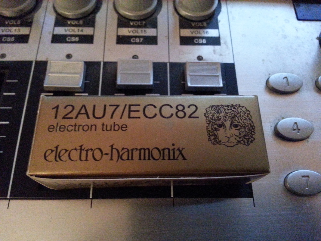

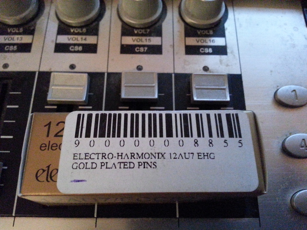

Are these the correct tubes? They say 12AU7/ECC82 on the box, 12AU7A/ECC82 EH on the tubes themself.
www.thetubestore.com - Electro-Harmonix 12AU7A / ECC82EH Audio Tubes
Yes, the only difference - gold-plated pins... but the tubes look exactly the same to me...

I too had a not so great first try. I hooked the frontends up to working slewmaster output stages and promptly blew the rail fuses. I have set up a bench power supply and will check voltages as per the schematic Valery added the notes to a few posts back. I'll be back when I can come up with meaningful questions. Here are a few pictures to get started.
