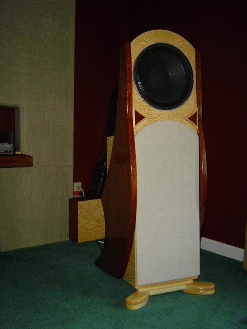

It's still available, it hasn't made it to the website yet. I built a pair (V1) and it is an oustanding speaker, I love it! Here's a pic of mine:

What about the top end? CD fires forward, dome tweeter backwards. Don't know if that matters at all.
Dynamics? Yes. But guessing that Orions would sound more refined.
How does a coax with a CD work anyway? Does the woofer cone provide horn loading?

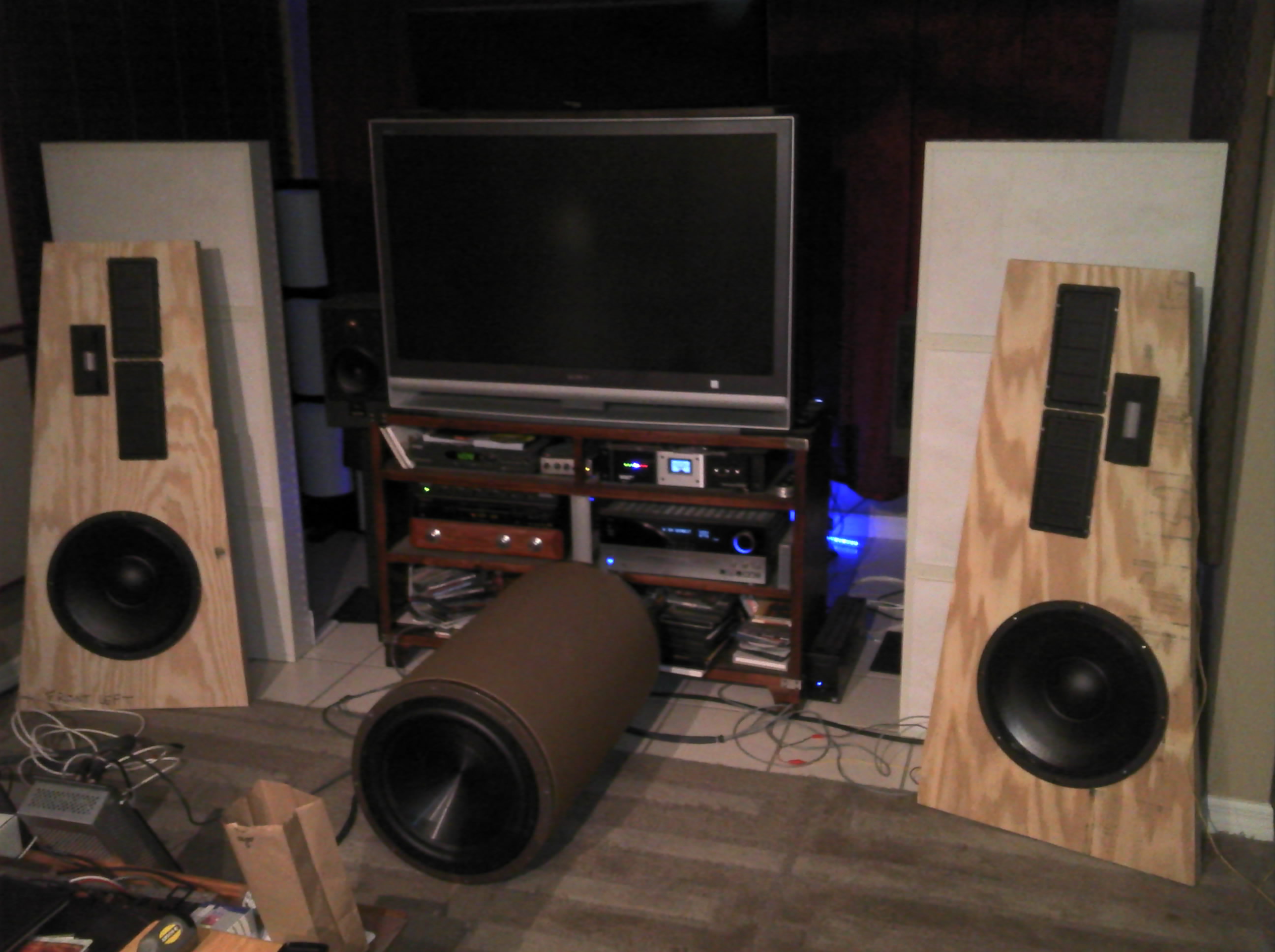

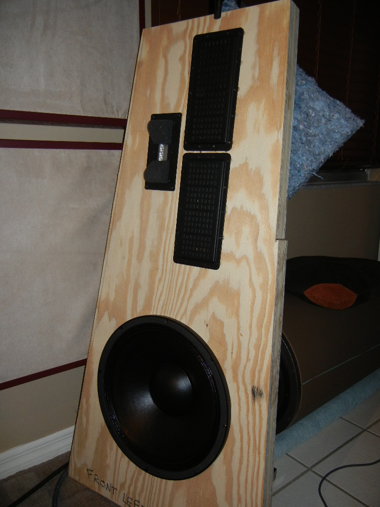

These will be offered for sale once I've sorted the crossover.

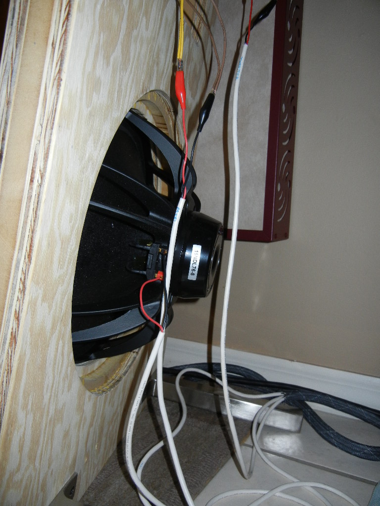

That's a B&C woofer, am I right? How does it work on this baffle?
Yes it is. 15NDL76. As far as making bass, not well at all. Midbass though, great! Takes twice the EQ of the AE Dipole 15 to get half the results, but that's OK cause it blends well with the Rythmiks. Once I decided on using the Rythmik servos with the project, I wanted to get rid of the AE Dipole 15s. No sense using them from only 60-300Hz.
