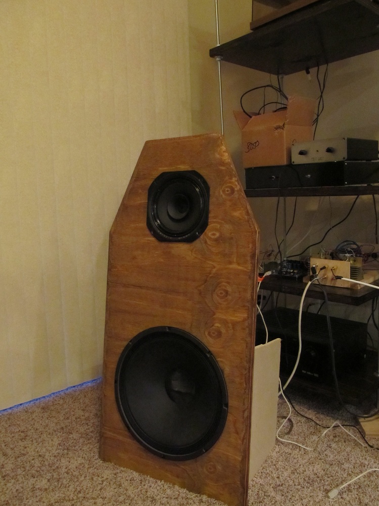

Hey guys,
Here's my current set up. Its an Audio Nirvana 8" crossed to a Eminence 15A
using the FirstWatt B5 crossover (the woofer has been smooshed in by a new
pup in the house). The low pass is a 2nd order 80 Hz and the high pass is a
2nd order 130 Hz with a boost near the crossover. The B5 has the 'boost' built
in at the flick of a switch which is pretty neat.
There is a 6db notch at 4 kHz and 2db shelving filter past 1kHz. I started with
a big 4x2 baffle and ended up with this design. With the big baffle, bass doesn't
need EQ, but the soundstage depth is not as good. The current shape, for me,
is a good compromise between appearance and sound. The angled top spreads
the dipole peak better and the rounded edges help with diffraction (although, I'm
not sure how much). The wood is 1 1/8" thick plywood. It is a huge step up over
MDF. It is cheap too - available as 'sub flooring' plywood from home depot (in the
US).
Suffice to say it sounds great. I've compared it with a MiniDSP in the system, and
the B5 is in a different league.

RA7,
What was wrong with the MDF baffles, thickness, dull sound.
I am considering building a few proto baffles with MDF to get a feel for the sound. Maybe I should do ply instead.......
The MDF just shakes too much. It kind of muddies the midrange. It was still quite good, but with the ply, images are much sharper and much of the muddiness is gone.
MDF also creates a fine dust and I've sworn never to work with it again.
