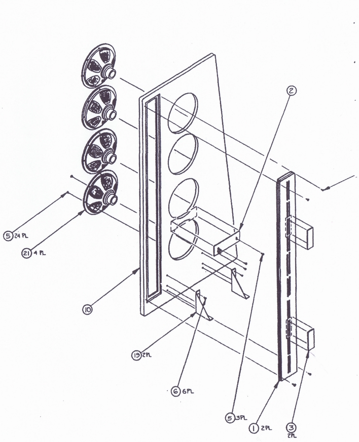

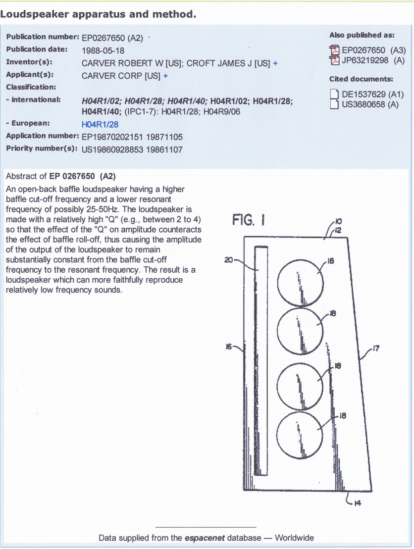

Carver Amazing Loudspeaker
espacenet — Bibliographic data

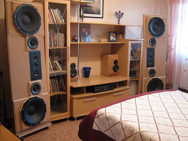

3 ways a passive (WMTMW), low frequencies - an active.Very interesting 😉 Passive or Active ?
Thanks you 🙂 The reasonable way to do this ! I would like to do the same project but I don't have enough place 🙁
