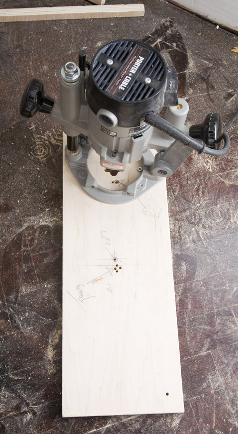

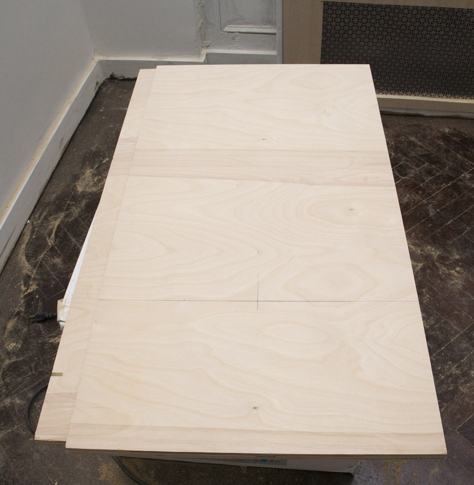

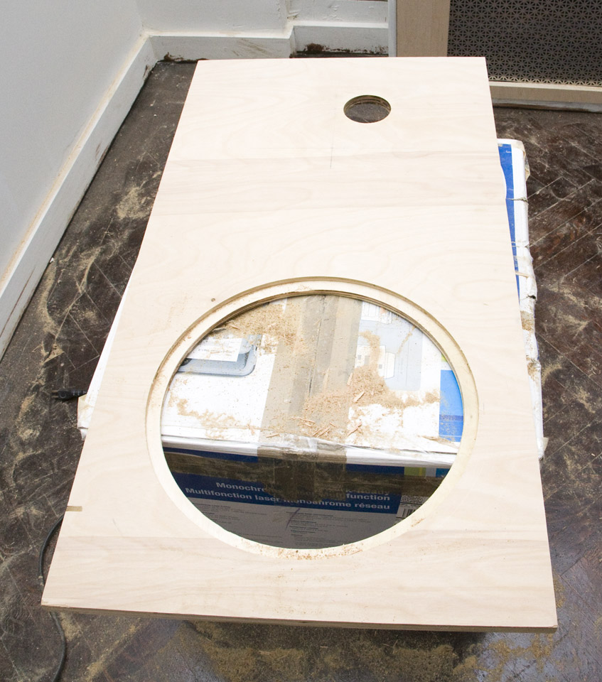

I'm sure I'm not going to make the ultimate OB speakers, but I thought I'd weigh in on my first ever speaker build.
I bought 4'x8' 3/4" plywood at Home Despot. They sliced it into smaller sheets - 38"x20" for me at the store. I was trying to decide on the best angle of attack since I own essentially no tools (just bought a drill press for amp projects). Ultimately, I choose to buy a router and route the holes. I was tempted to buy a circle jig, but after looking at how flimsy they were for the real money, I made my own.
I picked up my Porter Cable Router with plunge and standard bases for ~$100 from Ebay. It came with some very well worn bits. I used a 3/4 carbide tipped bit to router all my rabbets, and holes.
My jig was a scrap of plywood, subjected to my drill press at the right places. Attached are my results.
