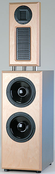

Some older design from 2008 but somebody liked the Neo3 and 10 combo at that time already:
Proraum Pro 20D
Proraum Pro 20D
Proraum Pro 20D
Looks a little bit like the OB I am making. Have you seen how much they want for the Neo10 driver, ouch.😱
Proraum Pro 20D
what woofers are those? Audax?
Hey Navin,
the woofers are Usher Kevlar models with a special coating by Pro Raum.
Greets Fabian
Greets Fabian
Usher W8137what woofers are those? Audax?
Rest as described by Fabian above.

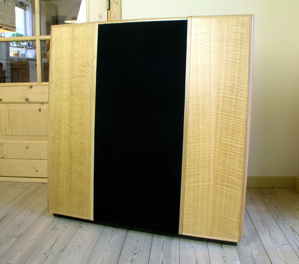

..and here is a nice "little" 😛 present from Troels this Christmas:
OBL11
..and the subjective description write-up has one of the best lines I've read in a while:
"..From a visitor hearing the prototype OBL-11s, I can report that these 15" Eminence DeltaLites beat the crap out of Eminence Alpha 15A.."
OBL11
Nice 😀
How I wish I can get that kind of plywood locally, sigh~
Deltalite-II 2515 has 4.8mm of Xmax. In his measurements, it looked well under 40Hz or so. (I think the big baffle helps quite some.)
Kappakite 3515LF got 9.6mm of Xmax, might be good for louder and deeper. I'm wondering if anyone tried it. (I don't remember any comment of this woofer used on OB... )
