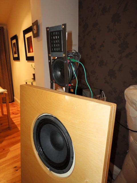

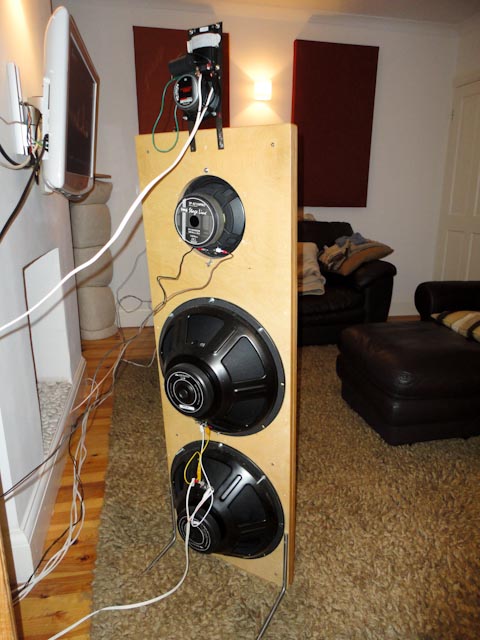

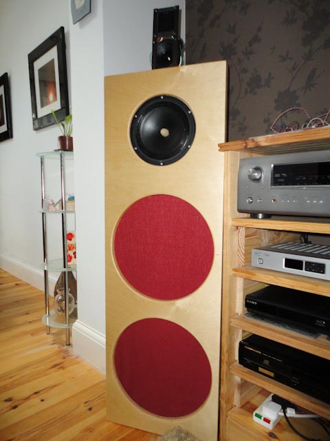

Here is something that is finally working very well for me after a couple of years of experimentation (playing around). I just try to copy other peoples sims and measurements to get ball park baffle widths and xover points.
Structure
The baffle width is a compromise but worth the theoretical advantages and improved WAF. From the picture you can see the 4" driver is behind the tweeter. I am planning on trimming some metal of the aluminum supports so that the cones can sit between the supports, lining up the acoustical centers, and hopefully resolving supposed diffraction issues.
Drivers
Neo3PDR, open baffled.
Monacor MS-100CHQ - 4ohm - 90db
http://www.monacor.de/typo3/index.ph...8&spr=EN&typ=u
Monacor SP-8/150PRO - 8ohm - 93db
http://www.monacor-ost.com/catalogue...=62&SubKtg=679
Eminence Alpha15s - 8ohm - paralleled to give 4ohm
Xover
The PLLXO changes regularly since I am guessing a lot to be honest. I crossed the 15's 67Hz/12db, supposedly reducing some of the open baffle hump this narrow baffle would give the woofers. Sounds right after a lot of experimenting. On 31octave test tones, the sound is pretty close to flat now, with a BSc circuit (10k-10k-100nf) on the upper two or three drivers.
Amp6b - 15" LP - 67Hz@12db
Amp6b - 8" BP - 125-350@6db
TA10.1 - 4"+Neo3PDR in parallel (just above 4ohm with the Xover hopefully) HP - 700hz@6db.
Speaker level cap on Neo3PDR - 8khz@6db

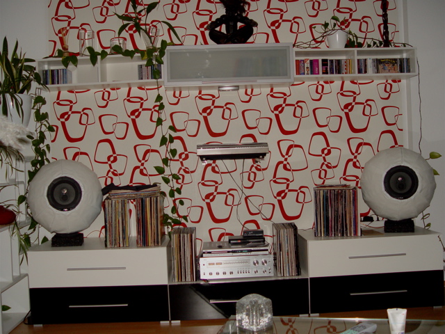

Spheres

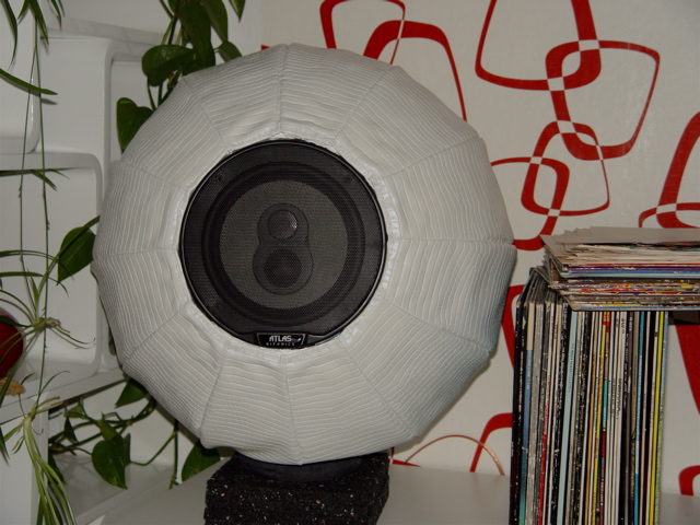

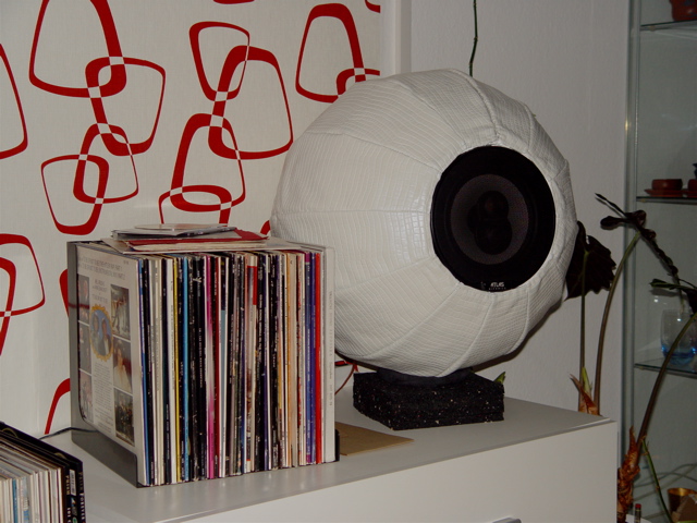

Just got them ready. The loudspeaker is a AX830E from Hifonics, the diameter is about 50cm. It's an ventilated box.
The leather-work is not that perfect, but for the first time it's fine 😎
