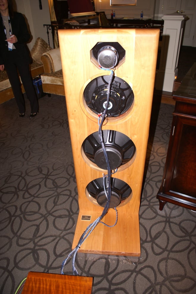

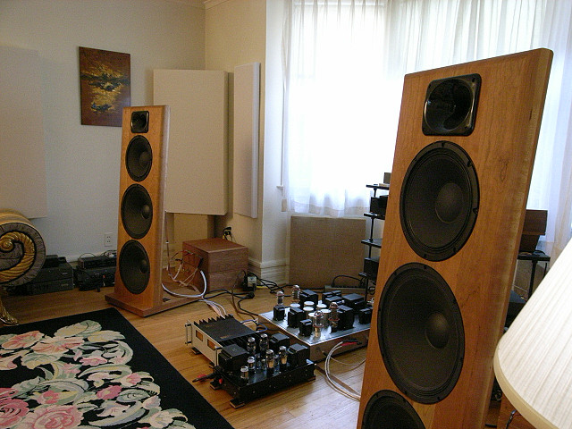

The Wg is the 18Sound XD120 combo. I posted this link over at PE and also thought the design quite interesting. A variant with a pair of Alpha 15's, a B&C 6MD38 mid and the 18Sound top end would certainly be able to kick some serious SPL's.....and look very cool doin it!

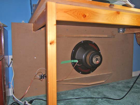

Wanna see a big sub OB?
Five feet wide. Sealed along the top to the table is it affixed to. 3/4 inch MDF. OB board spaced about 3 inches from all and attached to drywall in two places as well as firmly seated into the deep carpet. Stephens 150W, great 15 inch woofer of early 1960s. Cone resonance is 20 Hz.
Purpose was to address room modes by working mid-wall in parallel with Klipschorn in corner. Seems helpful in that goal.
DPDT phase reversal switch towards lower left corner. Not a lot of effect and not consistent across band. Surprised?
Very sweet bass... until the table and wall start shaking.

Would you please share more about the whole setup? A picture of the whole system, for example? 🙂
I appreciate your interest. But I think I can reply with words and from memory.
There is only one listening chair in my music room.
The room is roughly 10 x 15 feet (smallish, don't ask why... in a house with 13 other rooms). The one-meter-square Dayton-Wright ESL panels are across the narrow end and a few feet from the wall. Behind the right panel is the Klipschorn in the corner. Along the same wall, about mid-wall built into the bottom of a table, is the giant OB sub. Yes, the rear of the OB driver is about 4 feet from my right ear but I'm a big believer that a clean woofer is not localizable below 120 Hz.
The two woofers get the same signal (although from different amps - total of 6 amp-channels in my system), mixed bass below 110 Hz (24 dB/8ave), after passing through a parametric equalizer. I have two low freq bands to work with in the EQ. In the past I've tried to counter-act room modes with cuts and boosts - using glide tones (with cricket markers) as audible reference. That's a good use of EQ. At present, the EQ is just boosting bass (a few dB/8ave) to kind of compensate for the OB fall off.
I have a 25-year old pre-amp with a sophisticated bass-only "loudness" compensation. I've set my amps input volume controls way down so that the loudness compensation very nicely tracks the SPL. At loud levels ("6"), there's just a hint of boost. But at late-night low levels, quite a bit. GREAT benefit... that adaptable boost makes the bass just right at all levels. I am firm in my conviction that equal-loudness contours are an uncontestable reality and need to be addressed for music to sound right.
I've been doing a lot of mic testing and have learned very little that way except that room curves are really lousy and extremely variable depending on where you measure. Favourite way this month is low freq white noise signal viewed on a cumulative spectrum analyzer (free software) - quick, clear.
What I've done apropos room modes is straight out of the textbook (Toole) and works as good as expected. The more "divergent" the subs, the more benefit in molding the modes. Hard to think what could be more divergent than mixing a Klipschorn and a mid-wall giant OB. But I also got OK results with an AR-1W in about the same location although the K-horn and the AR have some similarities.

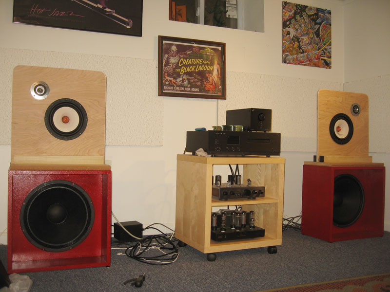

This is for the gallery. Divided Bass and Mid-Treble- Spruce Glue-lam baffles. Great effect.
Also Bass baflle picture, pianohinges and great movability.
Now Mid- and Treble has its own 20 x 60 cm baffle ancored by some 30 pound stone to prevent bass-influences to spread, it really works:
I did try some No Baffle solutions but in fact the small 8" (20 cm) baffle produced the very best results, no doubt.
So this is what it is like. Divided baffle between Bass (Eminence Alpha15s) and mid- tweet- 18Sound 6ND430 and B&G Radia Neo3W, all in dipole mode.
Crossover is with DCX2496 48 dB/octave at 250 Hz and 2 Khz, no other EQ applied.
So with this any OB is Challanged !
/Erling
