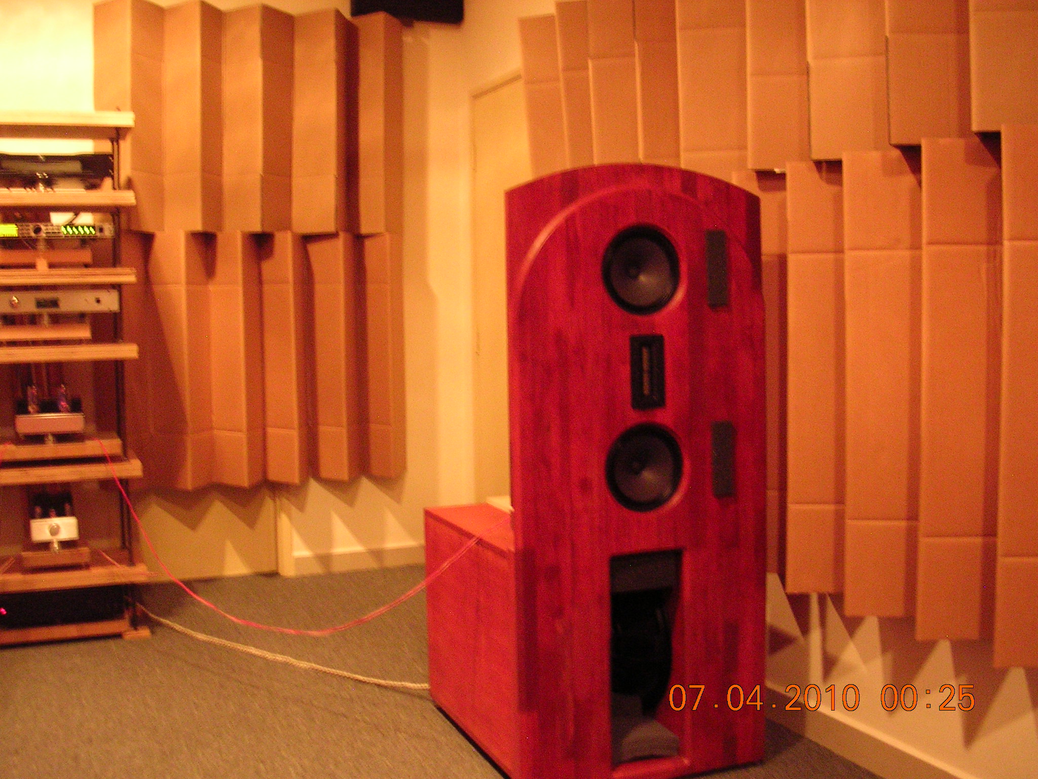

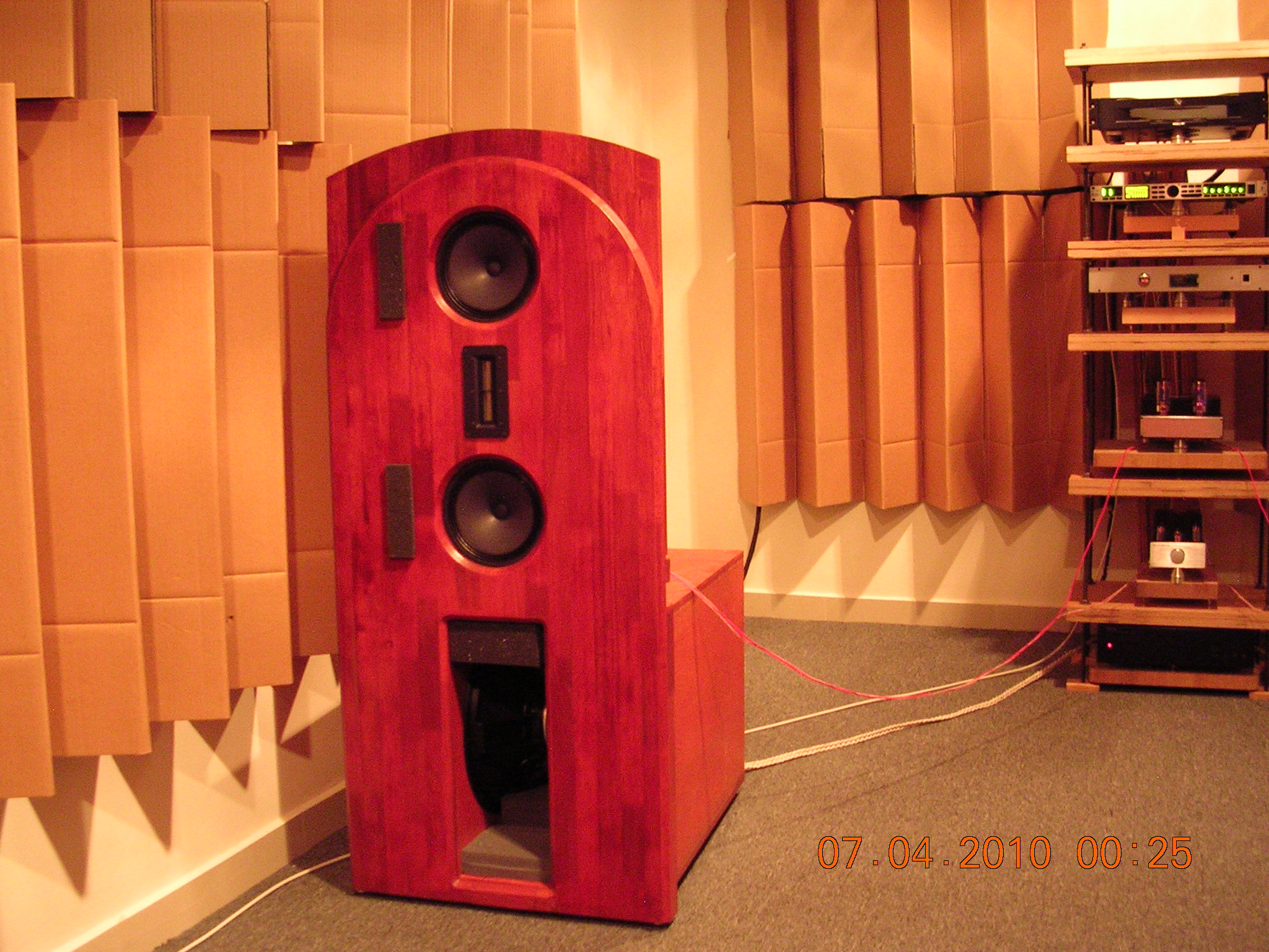

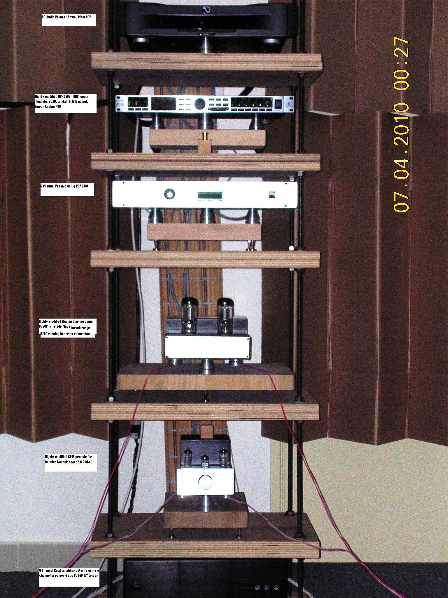

Here is my humble OB setup in a 12'x20' room. Speakers are spread 8 feet apart.
A run down of the connections:
1) HP NX5000 Laptop WinXP into Foobar2000
2) M2Tech usb/ BNC converter
3) 12 feet 75 ohms cable
4) DCX2496 modified to accept BNC direct input into the CS8420
5) DCX Reclocked with Tentlabs VCXO, dedicated Linear PSU for all stages, DAC connected to Lundahl 1517 6 channel output transformer balanced to unbalanced converter
6) 6 Channel preamp PGA2310
7) Bass amp using 4 channel of the 6 channels Rotel RB976 modified with 30KuF PSU caps and bypass internal volume control
8) Mid Channel amp using Modified Audion Sterling 6550C Triode
9) Tweet amp using modified 6P1P pentode SE amp
10) 2 woofers Visaton BGS40 in push pull on both sides
11) Mid range using Visaton B200 series connection
12) Tweeter Fountek Neocd2.0 Ribbons series with a rear firing Audax High Eff super tweet
Speakers are pulled 6.5 Feet from the front wall for best soundstaging depth and bass power.
Seating position is 4 feet from the rear wall.
Drivers are time aligned at first using the mic but then fine tuned by ear.
Equalization is highly necessary to remove OB peaks that are irritating. I use a sine wave generator from my laptop to slowly sweep and then apply notch in the DCX to cut the peaks. Retune the driver time alignment and speaker position if there is a suck out.

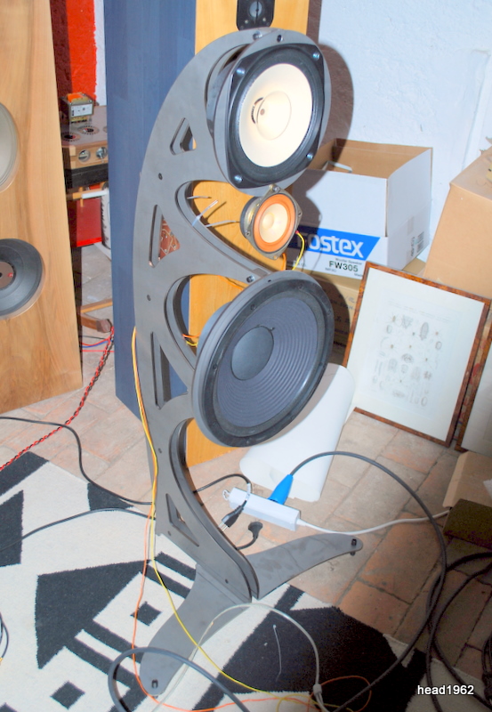

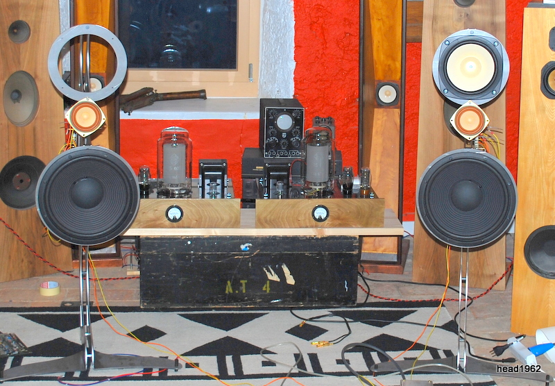

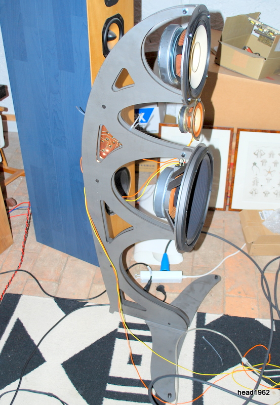

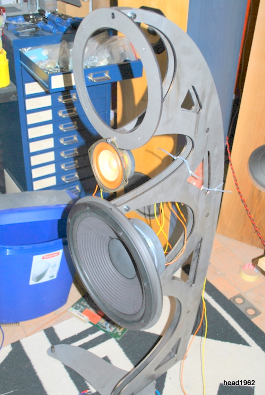

NO baffle
Hey Randy!!
you gave me this idea!
now they're ready.
in steel, pretty heavy.
there is a Fostex 305 for the bass
and a 103 for the rest.
the 206 on some pics is not connected anymore.
THEY SOUND INCREDIBLE!!!!!
I drive them with a 1.5 Watt SE tube amp.
Not the huge one on the pics.
the 103 has to move into the ringt for the 206. I have some new rings made this week.
I'm just totally amazed by the sound!!

What kind of tube is that in the background. That looks crazy-big.
So the FE103 sounds better here than 206? Maybe better sensitivity match.
The tubes are Telefunken RS607 triode.
about as big as they get.
It runs SE driven by a 6EM7. I thought I'd build an amp with the biggest tube available.
There is still the GM100 to try.
TIME MACHINES AND TUBE AMPS
have a look at my blog....
as for the FE206... don't know. I chose it because they'd match up pretty nicely on paper.
But then again... on paper the no baffles don't work either..
Just try it out, the sound is amazing.
Randy convinced me quickly to make a pair.
And since he already used wood, I thought brute steel would be the way to go.
I'll let the rust in the garden for a while, (without the drivers) I just love the the color of rusted irons and steel..
