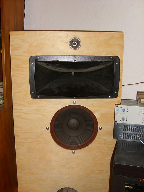

My latest "makeshift" OB´s: EV SP12B woofers + EV 1823M drivers with unknown horns + unknown exponential tweeters on 40x23" plywood baffles. The most expensive part was the wood...🙂
Active XO @ 900Hz between the woofers and the mid horns + single cap in series with the tweeters. With a bit of EQ they don´t sound too bad...😀
