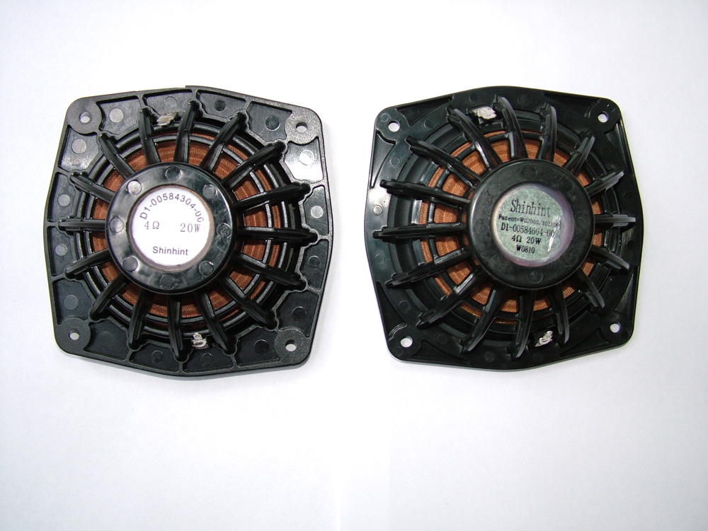

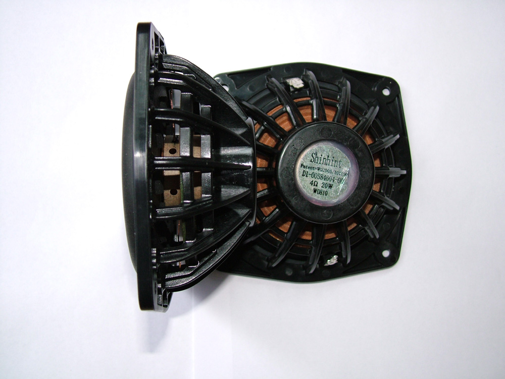

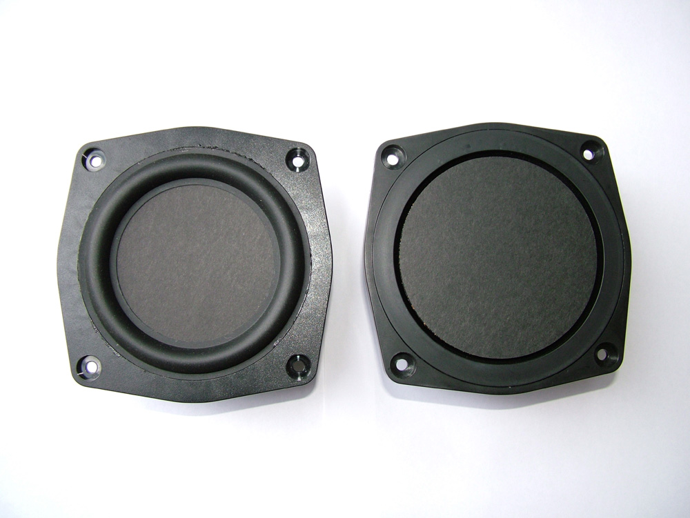

NXT ( Shinhint ) 4.5 inch BMR driver
Hi Human bin,
The NXT patended ( made under licence by Shinhint in China ) Bending Mode Radiators ( BMR ) are really good little drivers.
I will post pics ( Telstar again thanks for your shrinking service! ) of the 2 versions, one pure flat "cone " or with the rubber surround internal ie same side of the cone as the spider.
I have made a two driver per cabinet and and a 4 driver per cabinet using these drivers. They can go down to around 70Hz in a very small ( 3 litres per driver) sealed box. I cross them over at 100Hz to subs in a 5.2 home cinema set up and they sound great.
They dont come close to the Manger in a high end speaker ( listen to the £6,000 Naim speaker using an 8 inch version of the driver...) but they are fantastic value compared to a small bass mid plus tweeter set up.

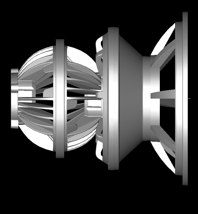

The one area where sealed box stills rules by some margin, is in the home cinema arena. A sealed 80 litre box with the attached "Predator " driver in it will convert more electrical energy into low frequency ( sub 20 Hz ) kinetic energy than a room full of baffle - less 21 inch drivers.
Watch this space....!

BMR pics
Hi Human bin,
Here are a few pics of the little BMR drivers.
If you or any one else is interested I can post details, graphs, and listening impressions a I have spent a lot of time working with them.
