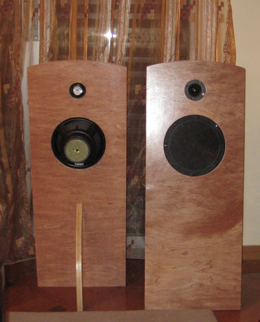

My approach to open baffle - ultimate simplicity🙂

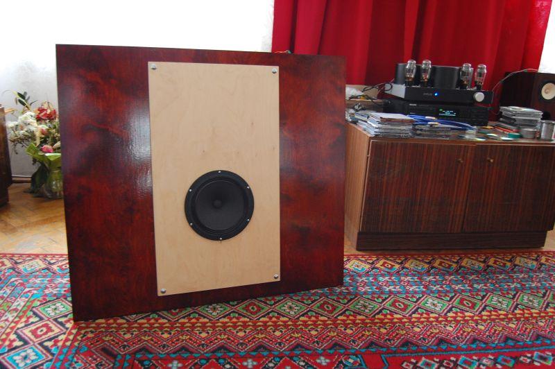

JeLabs style baffles with Visatons B200 (now with phase plugs). They sound stunning with my tube gear.

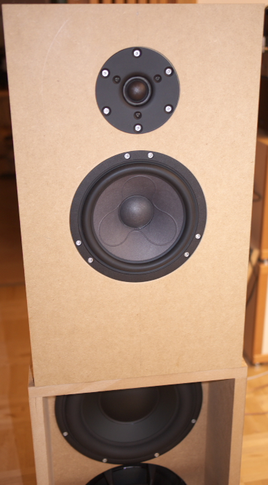

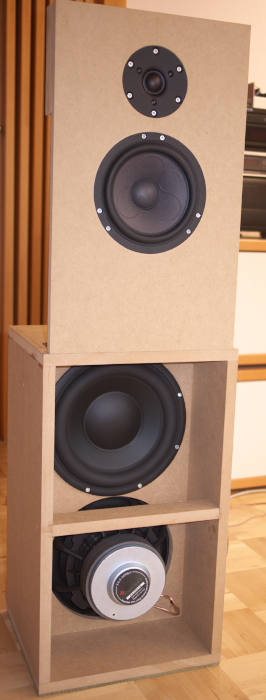

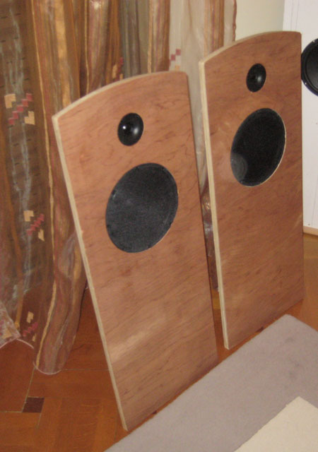

My approach to open baffle, using Vifa tweeters, 8'' Peerless mid/woofer and Behringers active xover. An active sub crossed to 150 hz provides the bass notes.
Sound quality is beyond my expectations with huge soundstage, excellent detail and good balance.

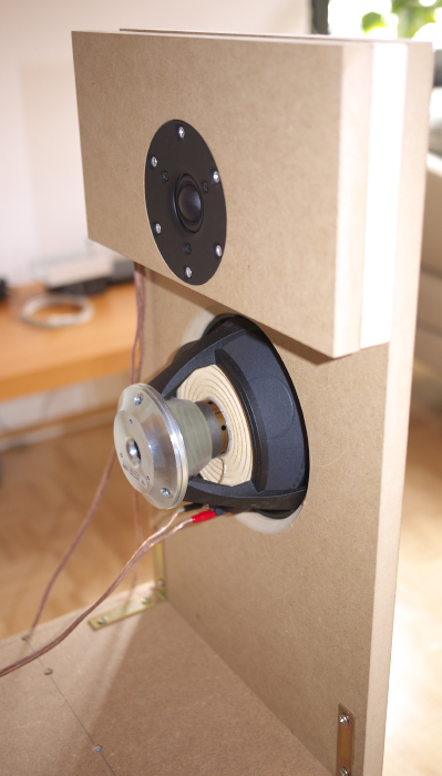

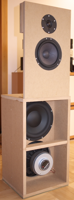

Hi all,
Here are a couple of pics of my latest development.
I slightly damaged a Manger driver ( over driven at party due to 300Hz instead of 500 Hz crossover ) back in Feb and only just got round to replacing it. I could hear a rough sounding " resonance " in the treble but only at high SPL so I did not think it was a full blown driver.
However it must have been causing a lot of problems, the new driver really makes a huge difference.
I have been experimenting with crossover slopes using a battery powered DEQX also tried a 12' low mid Vs the 15' low mid.
Overall I am delighted.
The Manger suspension system is very cool and while I no longer get the 3 dB to 4dB SPL boost from the big horns, the whole system is now very high WAF and really will look great once I seal the backs with black reticulated open cell foam and paint the cabinets.
Suspended Manger
