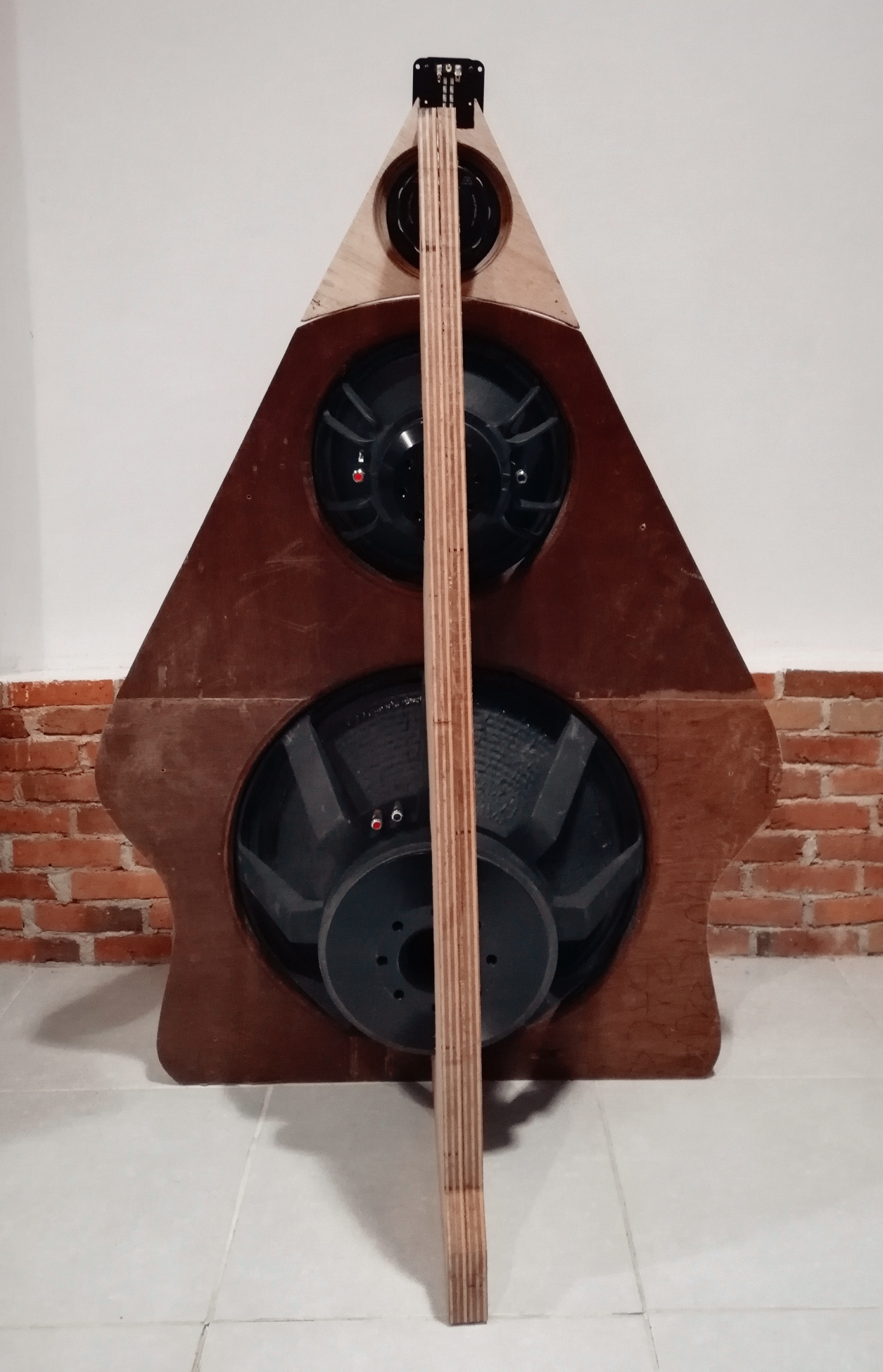

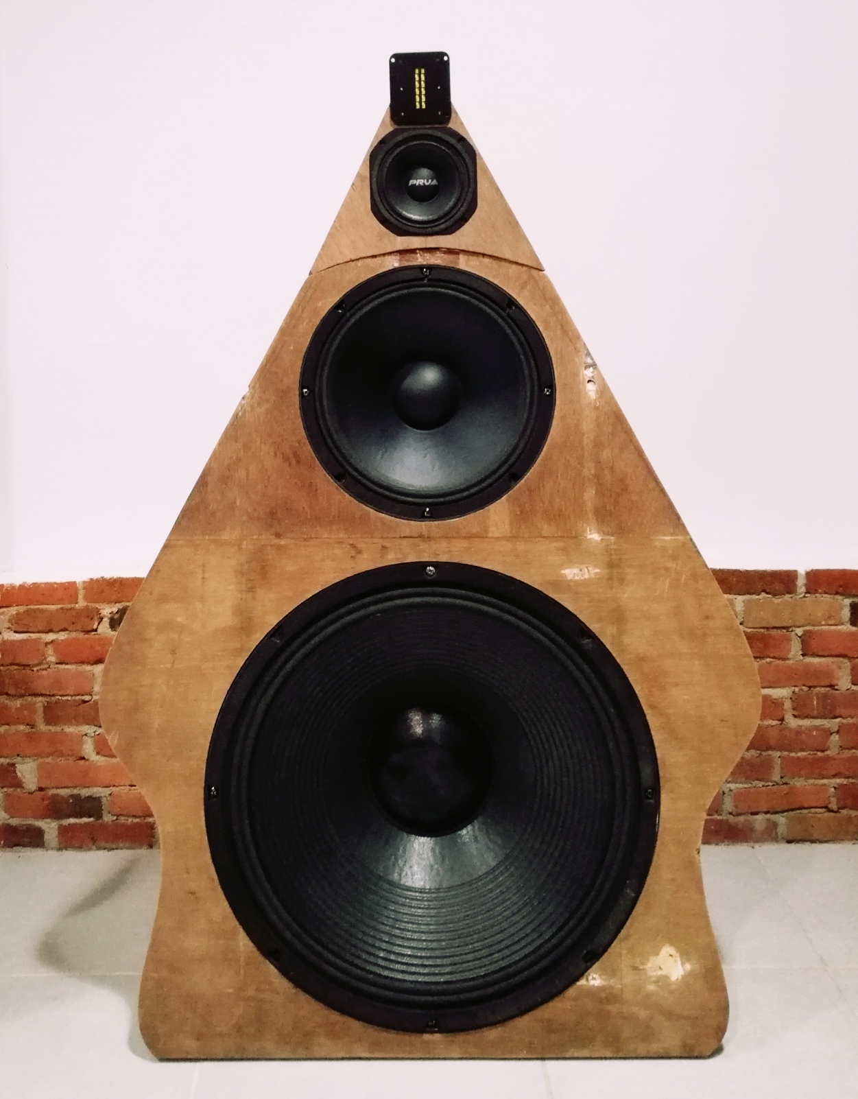

my on progress OB, 4 way active dsp, i also had an idea on less vibration on the fullrange but not string, just separate the baffle
my design is not original, OB fans should have nown where i got te inspiration from, but i adopted the shape to my local culture

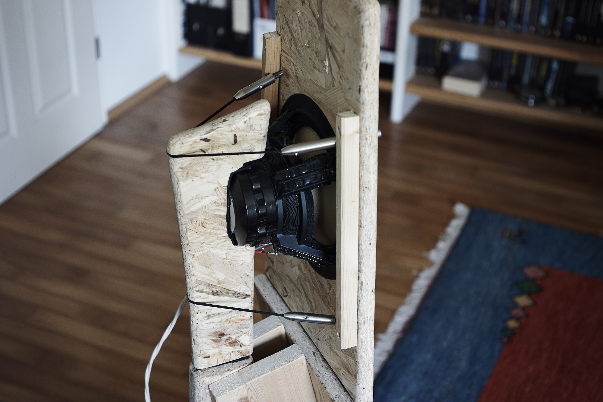

Gadut, separation of baffles is a good thing. I did it before the full swing for evaluation, let´s see if I have some photos here... ok, this was a prototype for shape and separation trials, by that time with a TB 1808 (pretty good for the money). Separation was done with sorbothane pads. Another possibility is to fully disconnect the baffle from the drivers, given driver are magnet mounted on a backbone. A gap of a millimetre doesn´t do anything evil, the impact is very small. Also in the flower pictures you´ll see the gap between the suspensionless FERTIN and the baffle of about 1 mm.

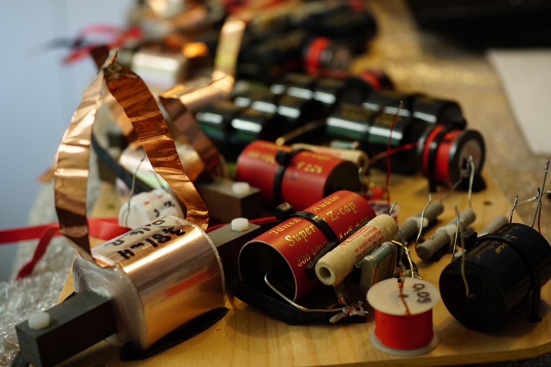

Perceval has answered the program question already, but this is only a first step. You´ll clearly need measurements and therefore several handfuls of coils, caps and resistors...
and that´s how I do it. With a little experience it´s not that much guesswork, but I first need a good handful of crossover elements and a mic and REW. The finetuning of a crossover is a personal, subjective and questionable process incorporating, taste, room, synergy, mood, quality of red wine sipped... and I do it by ear. Just for me alone, without the need to sell or prove anything to anyone... now that´s a big relief after having it done for money as well in former years.

I´ve tried several active approaches in history, and also with these speakers, using high-class DSPs and DACs. It was fine for 48 hours, then I returned to the passive filter. Don´t ask me why... active measures easily better, but somehow...
The filter used now looks more complicated than it is, due to the fact that it´s balanced.
