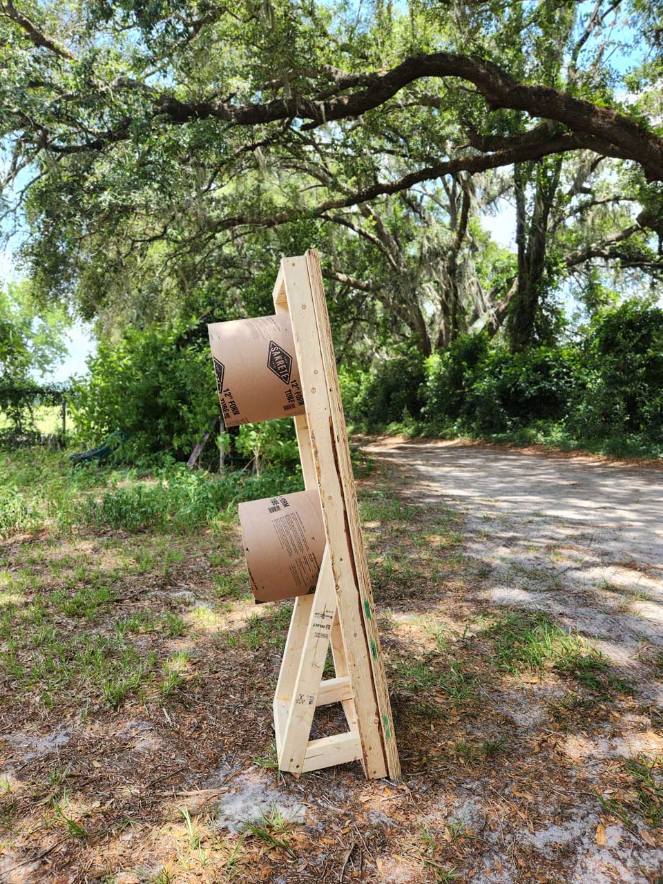

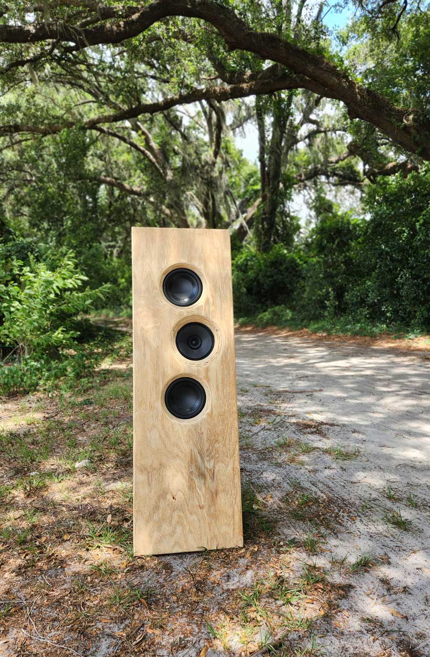

Latest development prototype #5 open baffle. 18" x 55" roughly.
More info here if you care to see the rest.

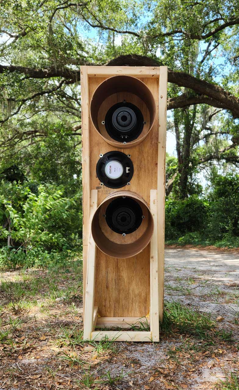

12" diameter x 11" depth tubes on the back, effectively u-frame baffles I think to help with bass response with the woofers.
Woofers in their open back tubes.
Very best,
Why would one want to use waveguides on the back and not on the front. Those recesses at the back do act as pretty bad waveguides. I have made that mistake once, learned my lesson and will never do it again. It measured and sounded pretty horrible compared to a thinner flat baffle

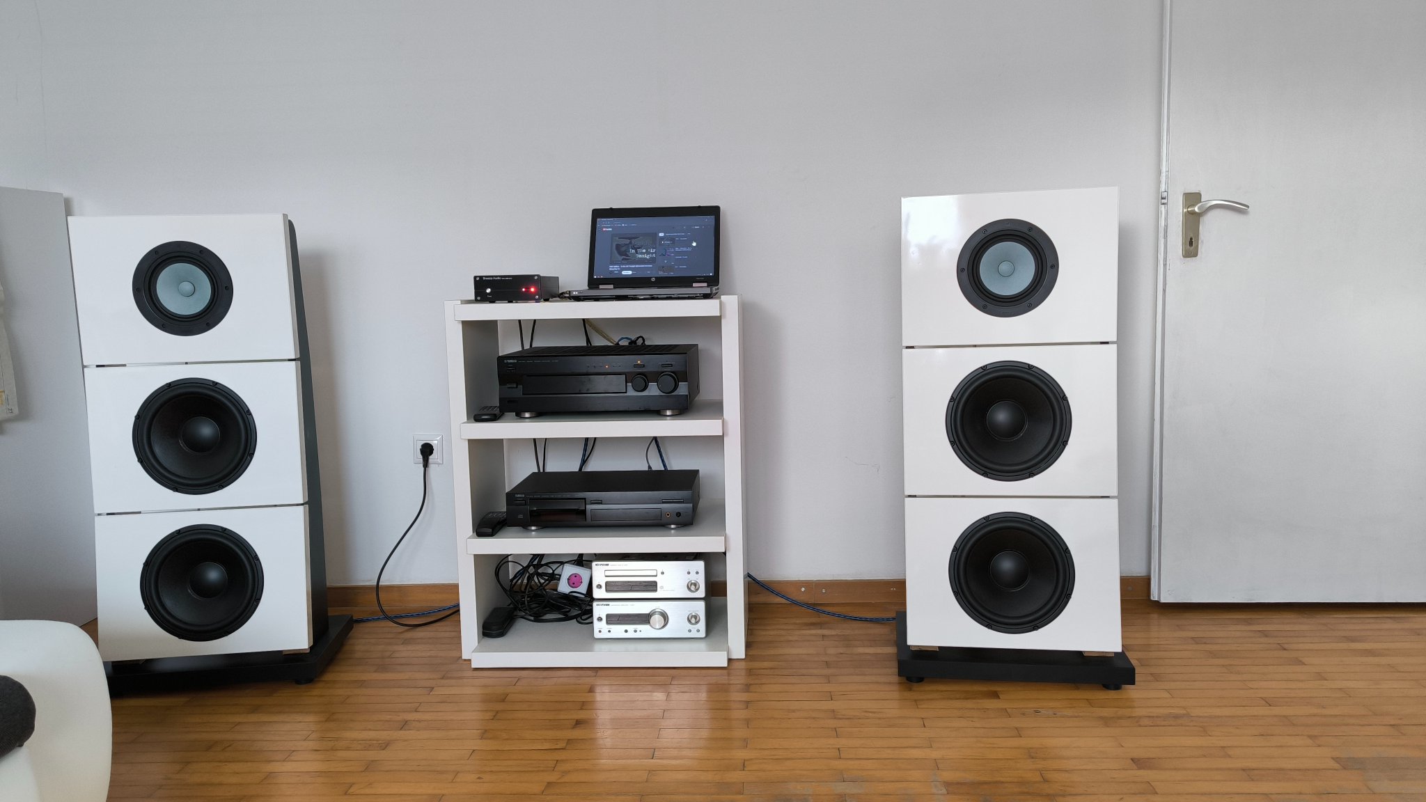

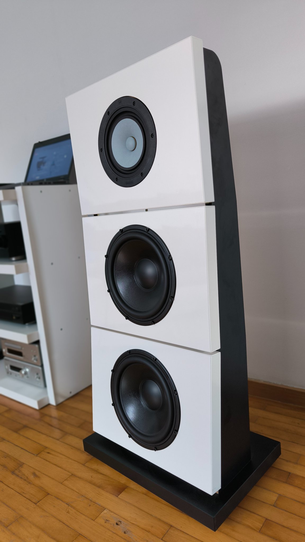

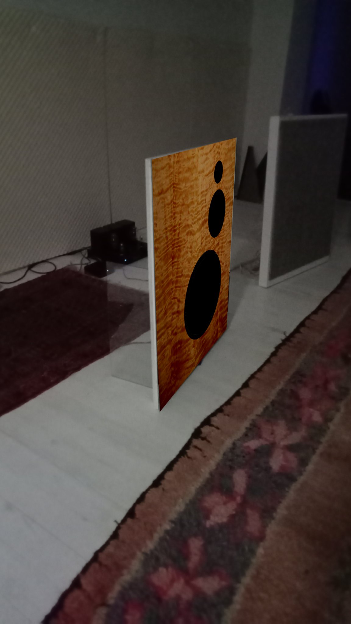

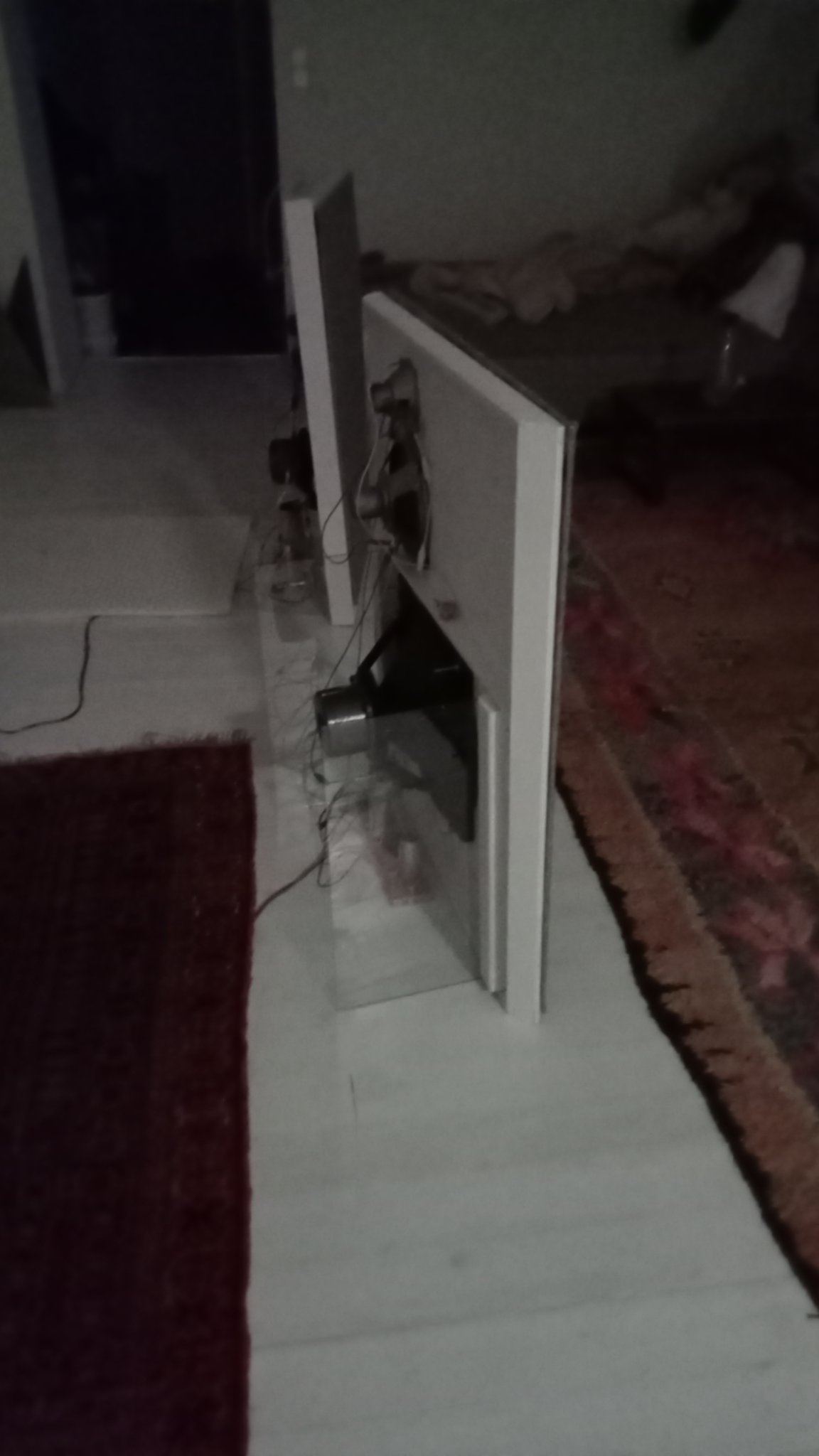

This is my last shape with linear results and real punch bass. Its 73 cm wide, with side wings of 30cm. Next days comes the Lii Audio w15 and i will try more narrow. I prefer 8mm pine wood reinforced with strips.
I would like to have all the drivers on one line and am thinking about slanting the sides next to the midrange and treble. But I've noticed so far that any changes away from a simple straight plate no longer make the whole thing sound homogeneous. I see you have a lot of experience, so I would be particularly interested in which shape is your favorite.
