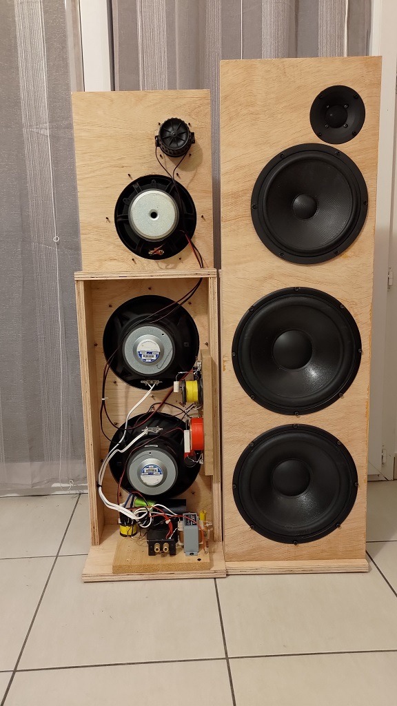

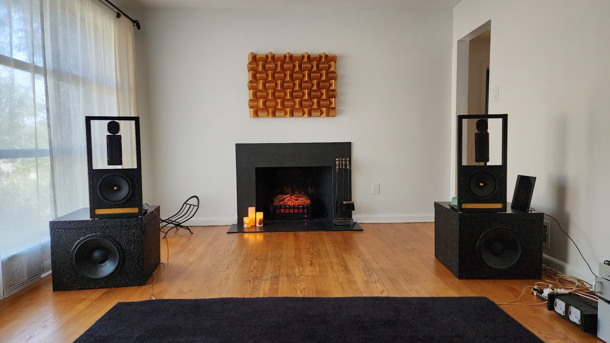

Work in progress on this open baffle seeking the good midrange.
After a 8" 22W8534 not convinced

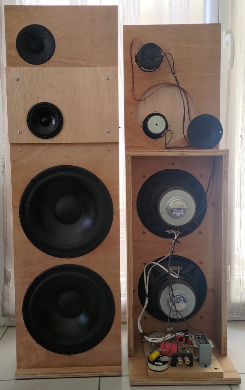

The 8" was replaced by a 6" W18NX001 not match with the woofers. Now the midrange is the MU10RB with the 27DXT as tweeter.
Very fan of the sound, very homogeneous sound and the treble is very realistic with a real 3D dimension. Note the tweeter placement is not very optimal....

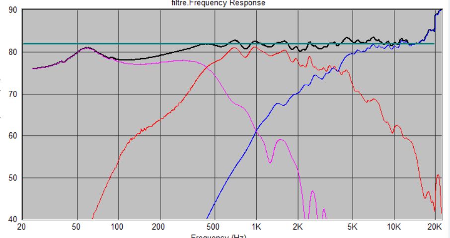

Crossover frequency 400Hz-3700Hz LR2.

I expect you would have better results with the tweeter as close to the midrange as possible.
