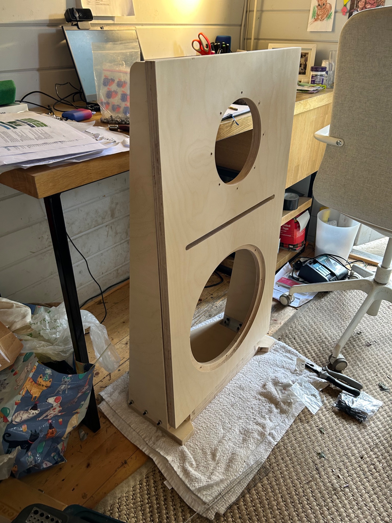

In line with a few others here, I’ve just fired up my PAP Duet 15 Prelude clones this evening. The missus is NOT happy, but I am! Much to do, and I suspect that the Eminence Betas will go in favour of a pair of Alphas and I may tone down the Tang Band 1808 another notch (running the 3.3ohm resistor in parallel at the moment) but I’m totally smitten with the way these present music already, compared to my Cambrian period Living Voice Avatars. I actually have mids now! 😂

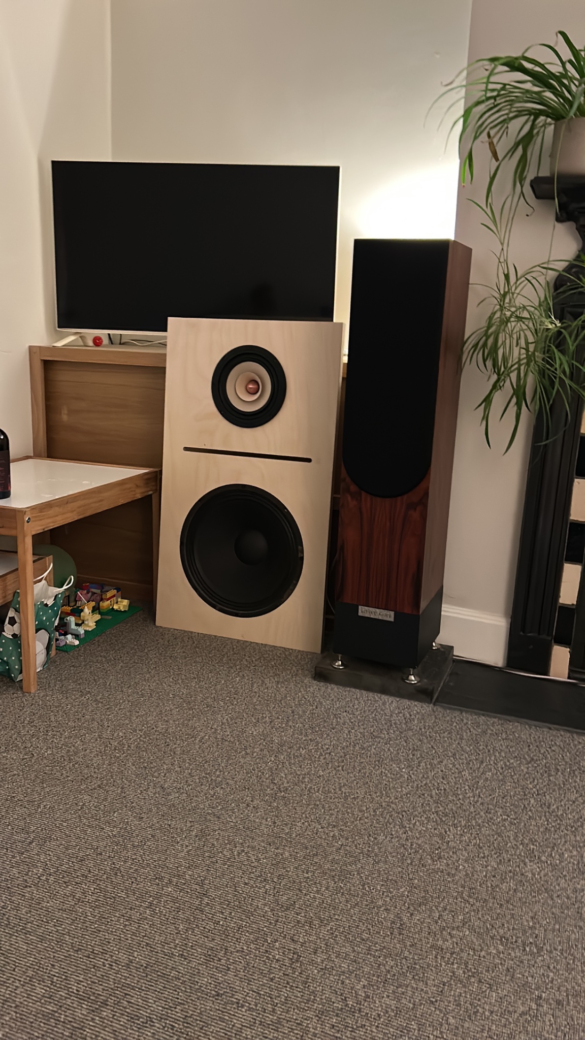

Man - I just got these together, using the Alpha's. I have all the XO parts, but have never built a crossover (scratching my head). I'm trying to determine if I can find someone to assemble the crossover, or if I should order the Sublime K231 (and spend the extra $$$) after already ordering good XO parts. I have 4 additional Alpha's if I can be successful in the XO piece and want to take the project further. Any, and all, recommendations are appreciated ?
Looking good! If these are Trio clones, some kind fellow has a schematic on YouTube you could use, plus it’s bloody good fun making your own! Try this

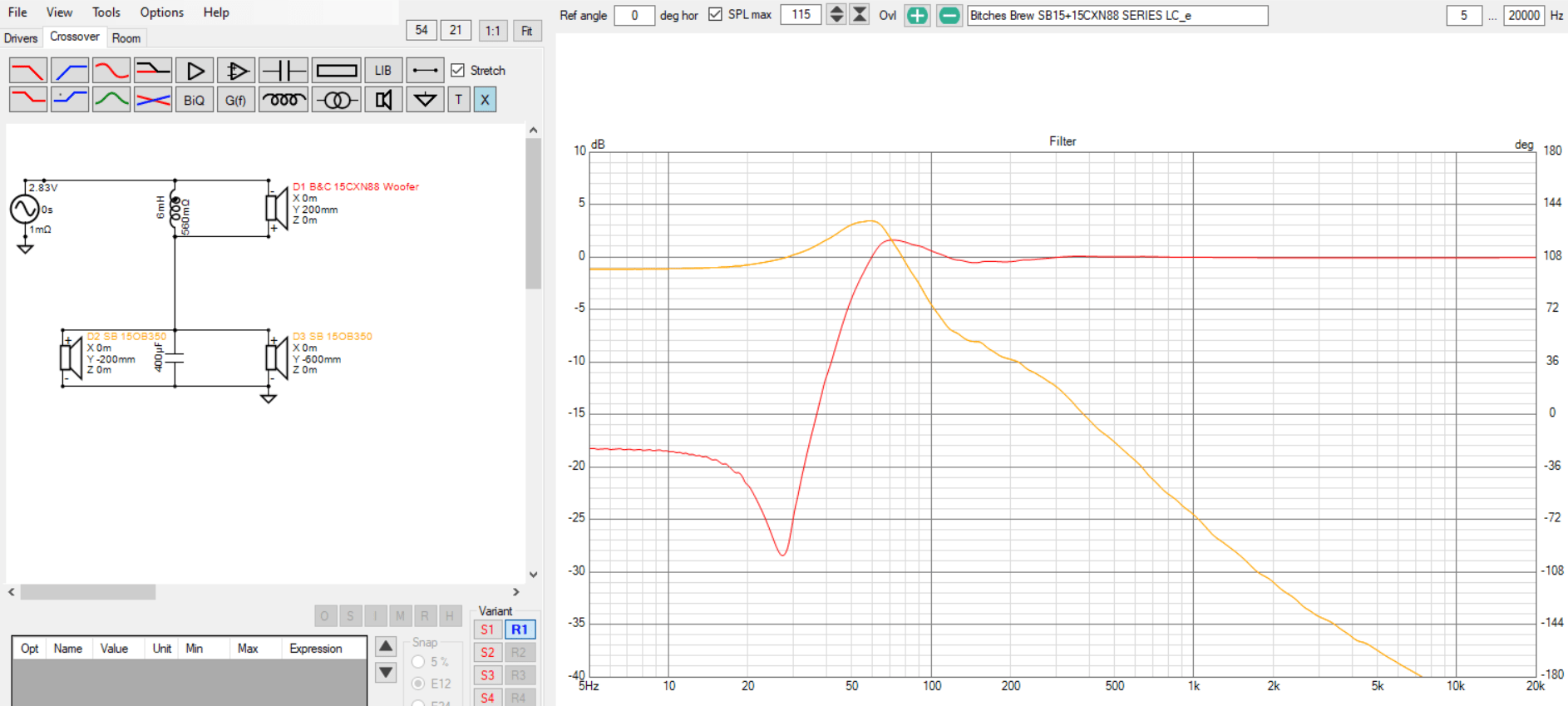

A rarely discussed crossover is the Series Crossover (in contrast to the universally popular Parallel Crossover). It offers considerable advantages especially with a subwoofer and a bass midrange. I used a series passive crossover in the Bitches Brew Live Edge Dipoles (which are featured in the new October 2023 issue of AudioXpress). Here is the schematic:
ABOVE: In a series crossover, you wire the woofer and midrange in series. You short the woofer with a capacitor. You short the midrange with an inductor.
The circuit above is what I used in the Bitches...
