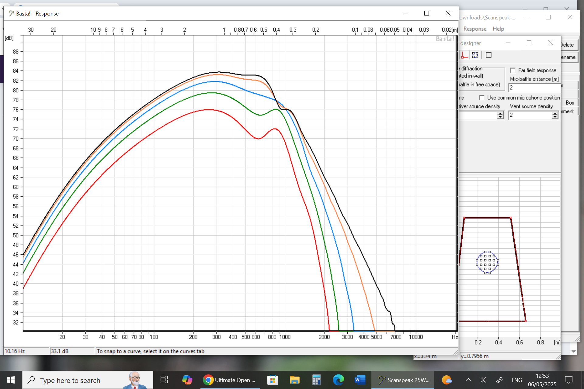

OK, here's the same setup as modeled in Edge above (see post #4657). This time, in Basta!, using driver parameters, and with a passive crossover. @adason I adjusted the vertical scale to approx 25dB/decade, in line with IEC recommendations. (I may have made the baffle slightly wider this time, bringing the problem frequency a touch lower.)

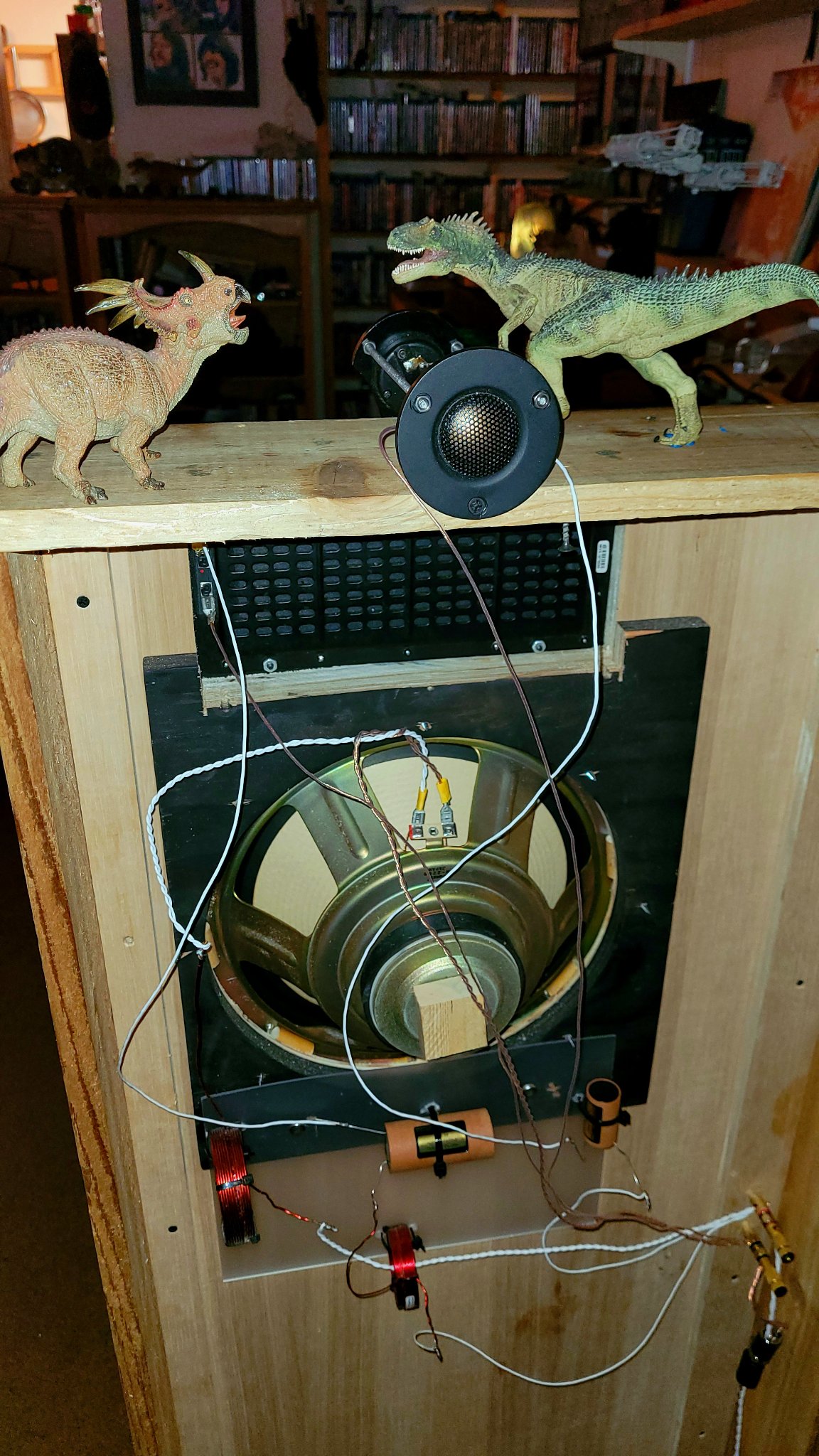

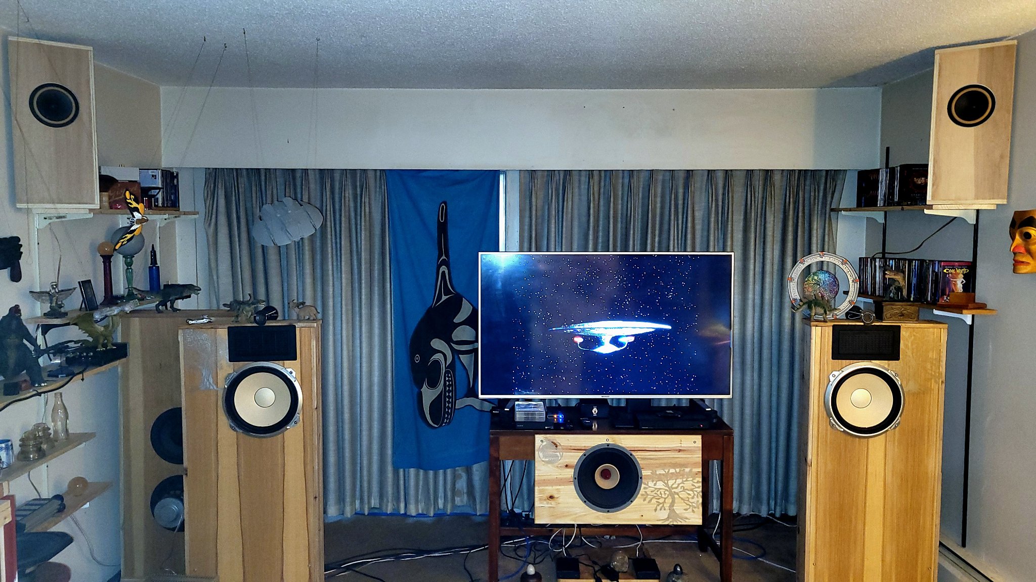

My mostly folded front open baffle speakers. The stereo pair started out as 12" single drivers, placed for easy active eq to flatten a little but mostly suit my taste. Soon after adding helper tweeter attempts, I went full multiway, with placement and crossover points chosen for low excursion and peaks if they weren't dipped with.the crossover.
I didn't at first use a rear tweeter, but it's paralleled with the front one to share the load, which allows a strain free sounding lower output to meet the mid at-6db at 1800 hz first order.
The old Sansui 12" have new lighter surrounds, which further lower their made for sealed cabinets Q.
I'd tried these with a couple kinds of 2nd order filters with closer filter knees, but like the sound and lower parts count of a first order crossover, ranging between -5 and -9db crossover points.
I do use a bass panel for movies and cable programming, but there's enough to not use feel like I need it for my 2 channel system for music streaming, or records.

@ianbo What did the crossover look like used in this simulation? 🙂

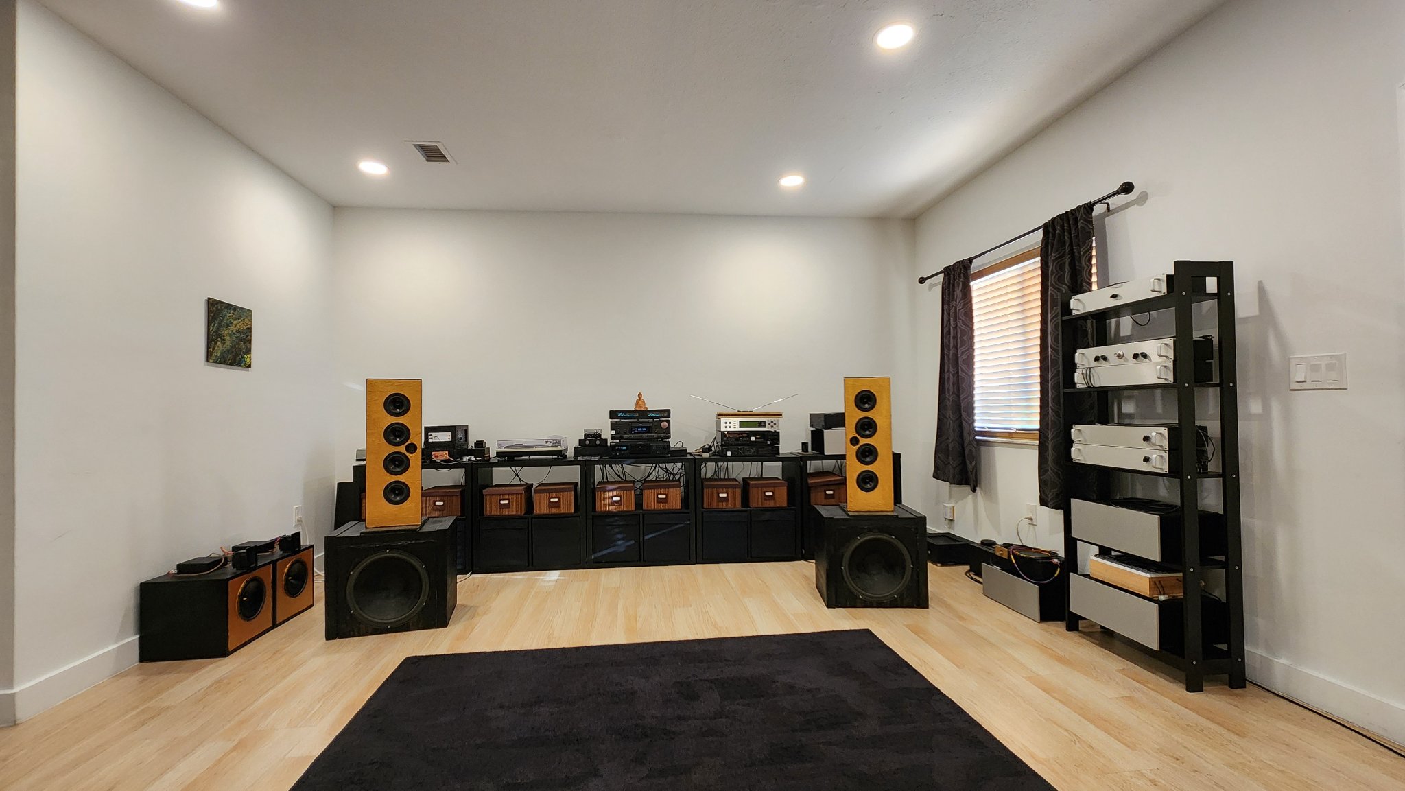

I do not have much update, except i change top open baffles from time to time, just to make things interesting. Tops are four 4" reference series aluminum cone daytons. In 2.5 way configuration, plus dayton amt tweeter. Amazing coherency, great soundstage.
Plus i partly organized my amps and preamps/crossovers on the rack right.

Sorry, missed this. I'm away from home right now so can't check. Might have been third order.What did the crossover look like used in this simulation?

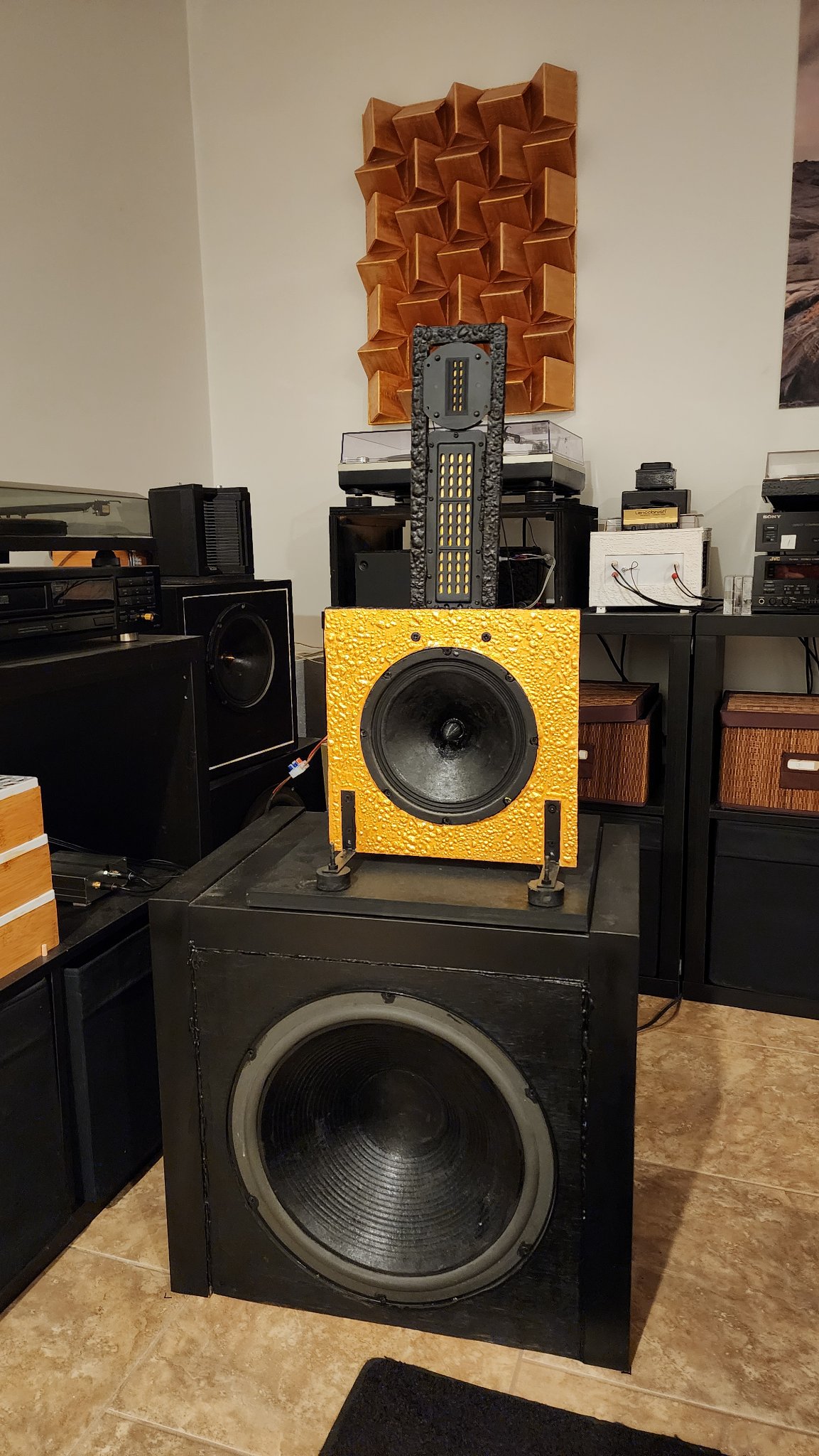

My ob dual driver bass panel was originally push push, and used some now 25 year old subwoofers.
It surprised me to switch to a push pull mounting of the drivers. I' thought I had not reversed polarity of one driver, because the level dropped fairly noticeably.
Apparently these old ones were putting out a lot of distortion, mostly gone after going push pull.
I couldn't swear things sounded cleaner in any way after matching before and after levels, but I guess we're not too picky about low frequency distortion.

The sim in post #4,662 used a 2nd order passive crossover, 1.2 mH and 33 uF. These were just random values, really. (Of course, the sim is of limited value in the midrange, because it just gives the effects of TS parameters plus baffle size/shape, and isn't based on a measured response.)What did the crossover look like used in this simulation? 🙂
