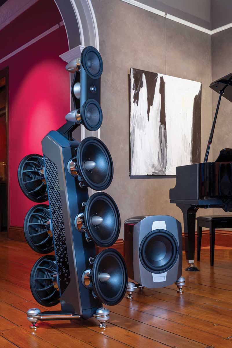

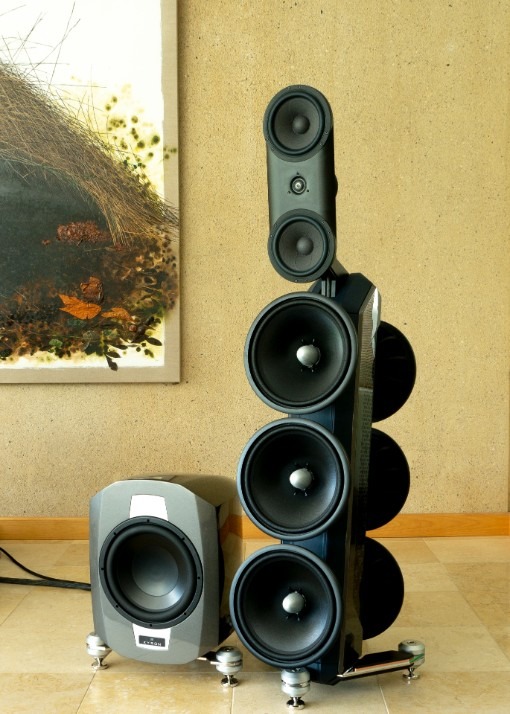

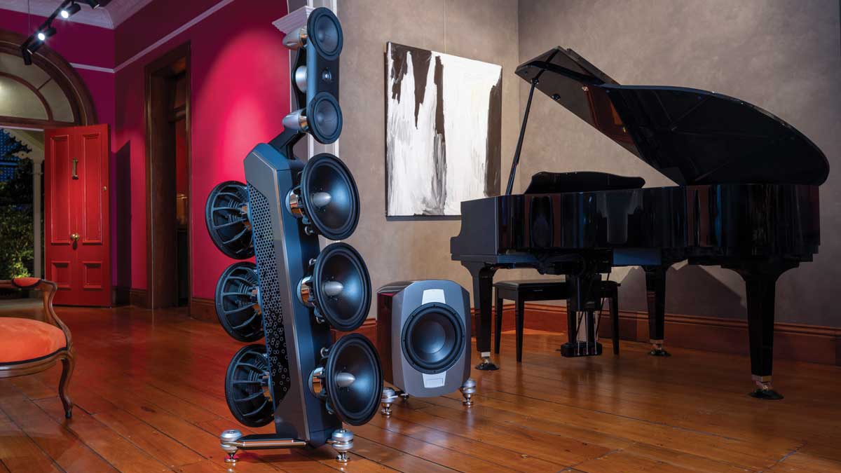

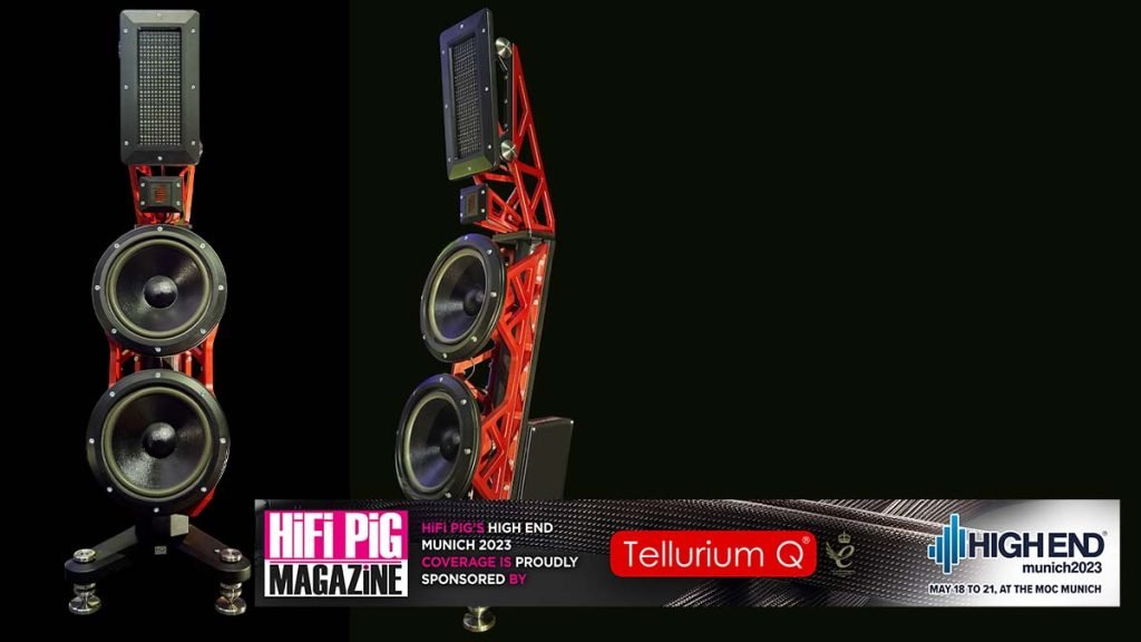

Anyone heard these Italian crazy looking all open baffle speakers? How can they produce enough low bass?

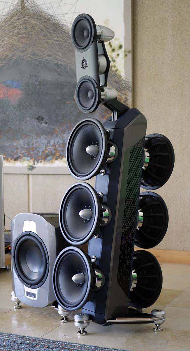

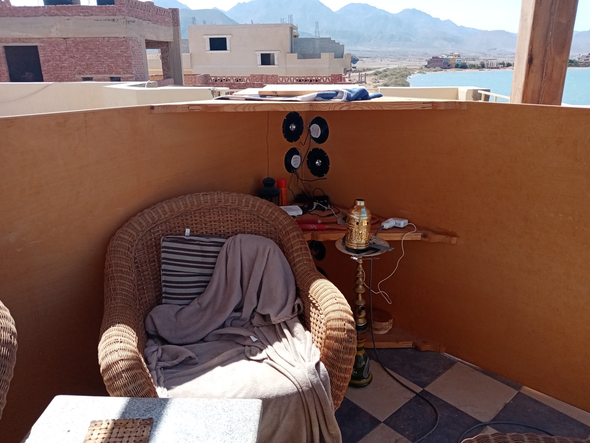

You know me, i am very fond of open baffle, for that open sound free of boxiness. But open baffle bass is no easy task. I use four 15" woofers with eq.
Even kyron uses sub now...looks like six woofers ain't enough 🙂

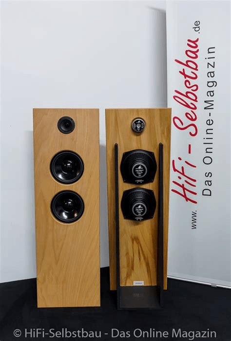

Monacor Katana
https://www.monacor.com/products/components/speaker-technology/diy-/katana-m1/
https://www.monacor.com/products/components/speaker-technology/hi-fi-speakers-/spm-205-8/
https://www.manua.ls/monacor/katana-m1/manual?p=4
Comparable woofer? (foam surround- so what-it's cheap $7.50 cdn, $5.70 usd) see specs
https://qcomponents.ca/collections/...s/sammi-cwr200b20u-8-ohm-8-home-stereo-woofer
https://www.avforums.com/threads/open-baffle-kit-first-impressions.2443996/
https://foorumi.hifiharrastajat.org/index.php?threads/monacor-katana-m1.172110/
https://www.hifi-selbstbau.de/index...-monacor&catid=156&highlight=WyJrYXRhbmEiXQ==

Guess they do it with more cone travel?

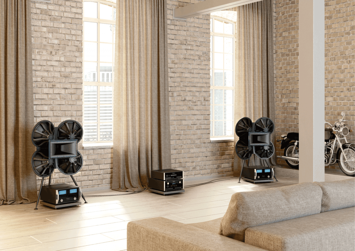

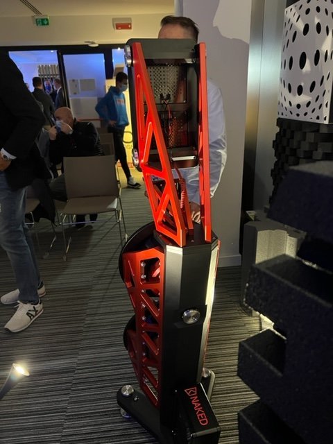

Certainly has a Ducati frame vibe going on.Italian crazy looking
The woofers appear to be in a tiny rear chamber, so high tuned in theory with some sort of sub harmonic synthesizer?How can they produce enough low bass?

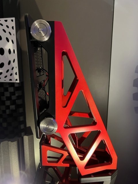

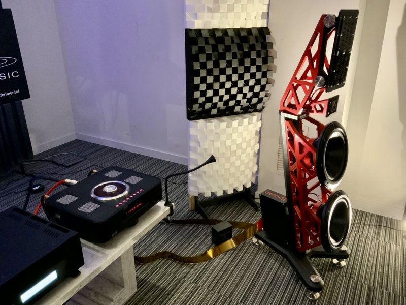

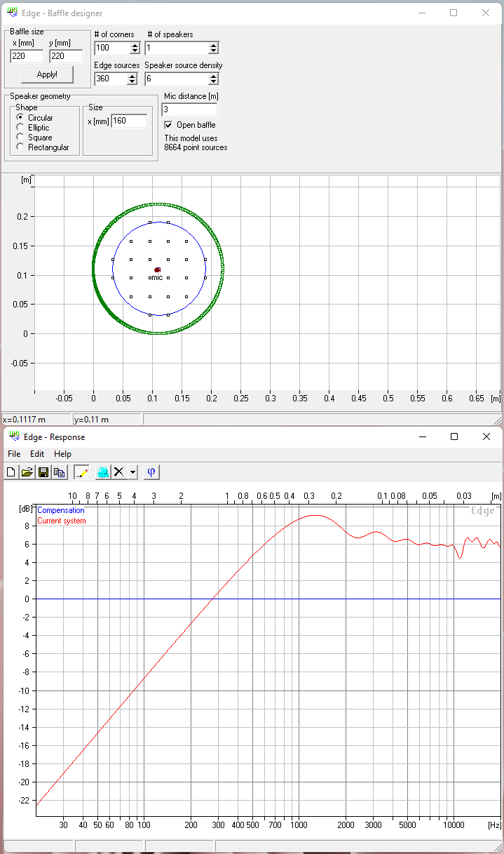

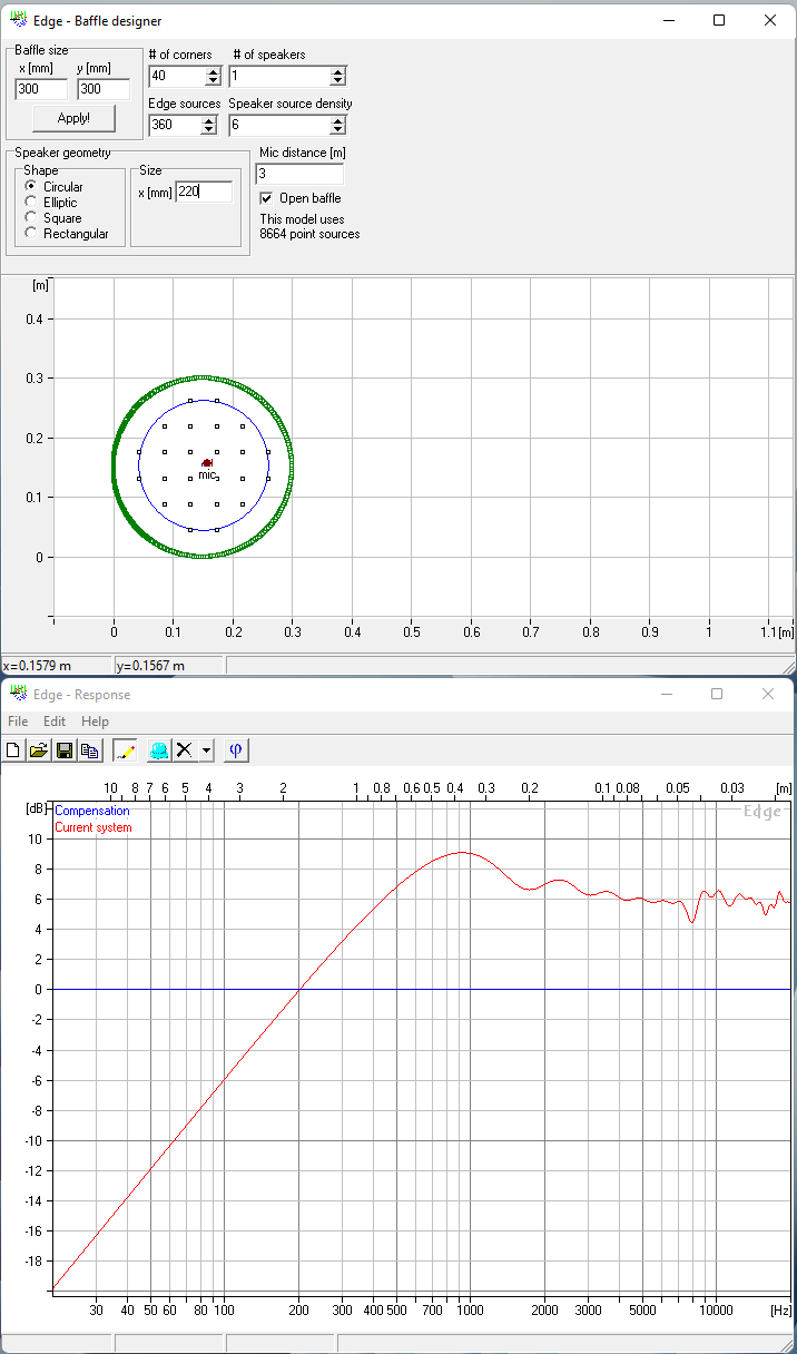

That was exactly my question. How can naked woofer without any baffle have bass? Not to mention hifi. Because if you eq, you get excessive cone movement with lots of distortion. That creates upper harmonics poluting midrange. Not good.
Naked woofers must have terrible cancellation below 100hz. Someone could simulate it.
Almost any open baffle bass has baffle. The bigger the better. Like that katana speaker ChrisABC posted. Or NoBox visaton.
Simulated baffle response of an 8" with no baffle... If will roll off even more in the low end if the driver's Qts is lower than 1.

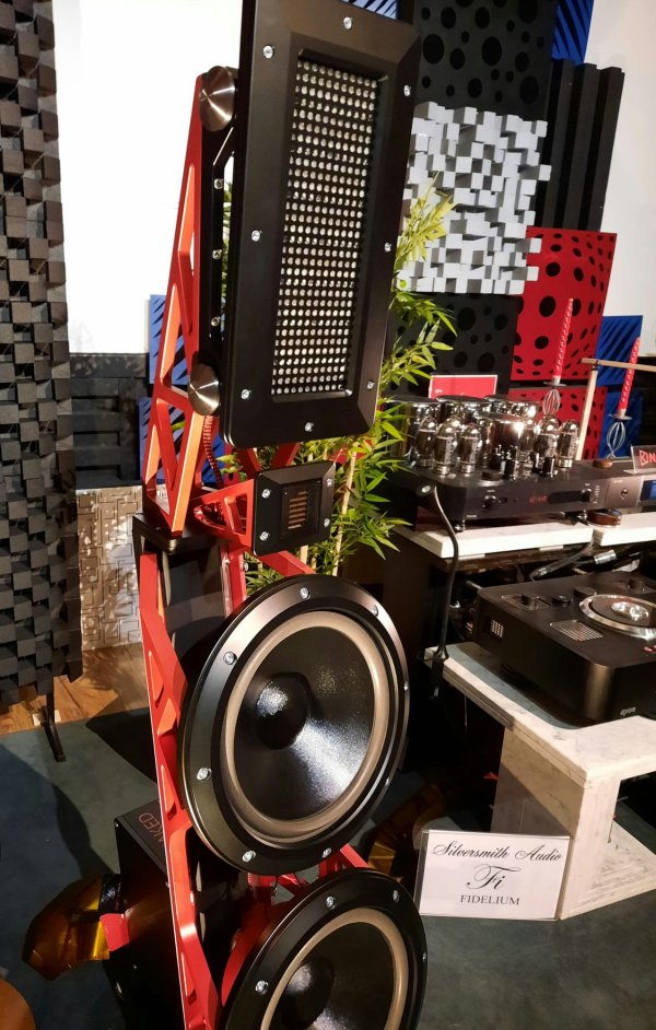

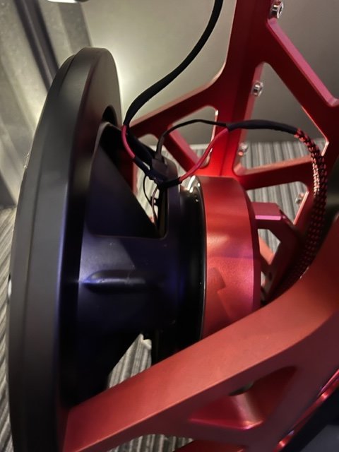

More information here? IO Designs - Biggest Surprise at the Show - Loved Them!!! - HighEnd Munich 2023
https://www.monoandstereo.com/2021/12/io-design-naked-speakers.html?m=1
12" woofers per this link. And I'm certain those mids are the 1030 driver that FPS makes.
- All open baffle
