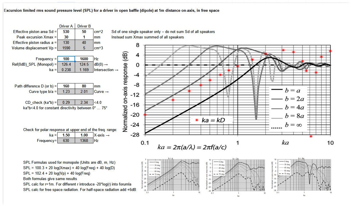

Take care with this Linkwitz spreadsheet - D is not the Diameter of the baffle, but more or less it's radius, or as stated, the effective path difference for a point source. So you should input 150mm instead of 300mm into your spreadsheet. This spreadsheet was published by Linkwitz on his website in an early version related to a section called "Open-baffle Loudspeakers". Have a look there for the meaning of D.
Later on Linkwitz published a more elaborated chapter about "Radiations from a rigid circular piston in a finite circular open baffle". Taking your values (Diam=300mm / SD=1060) into the resulting simulation of this later section, then the SPL of this speaker e.g. at 40Hz will result in some
If you take these graphs, then you end up with the following values (taking an overall radius/pathdifference D=160mm):
40Hz: 110dB - 30dB = 80dB
100Hz: 126dB - 16dB = 110dB
Horizontal constant directivity may reach up to some 630Hz.
And take this with a grain of salt - It's nothing but simulations, models and approximations.

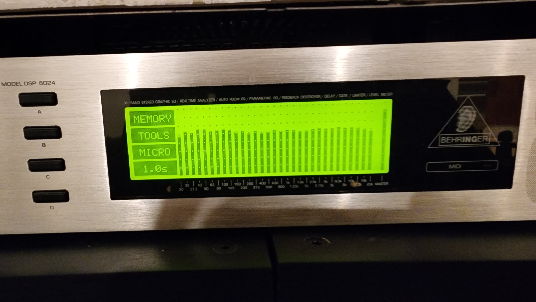

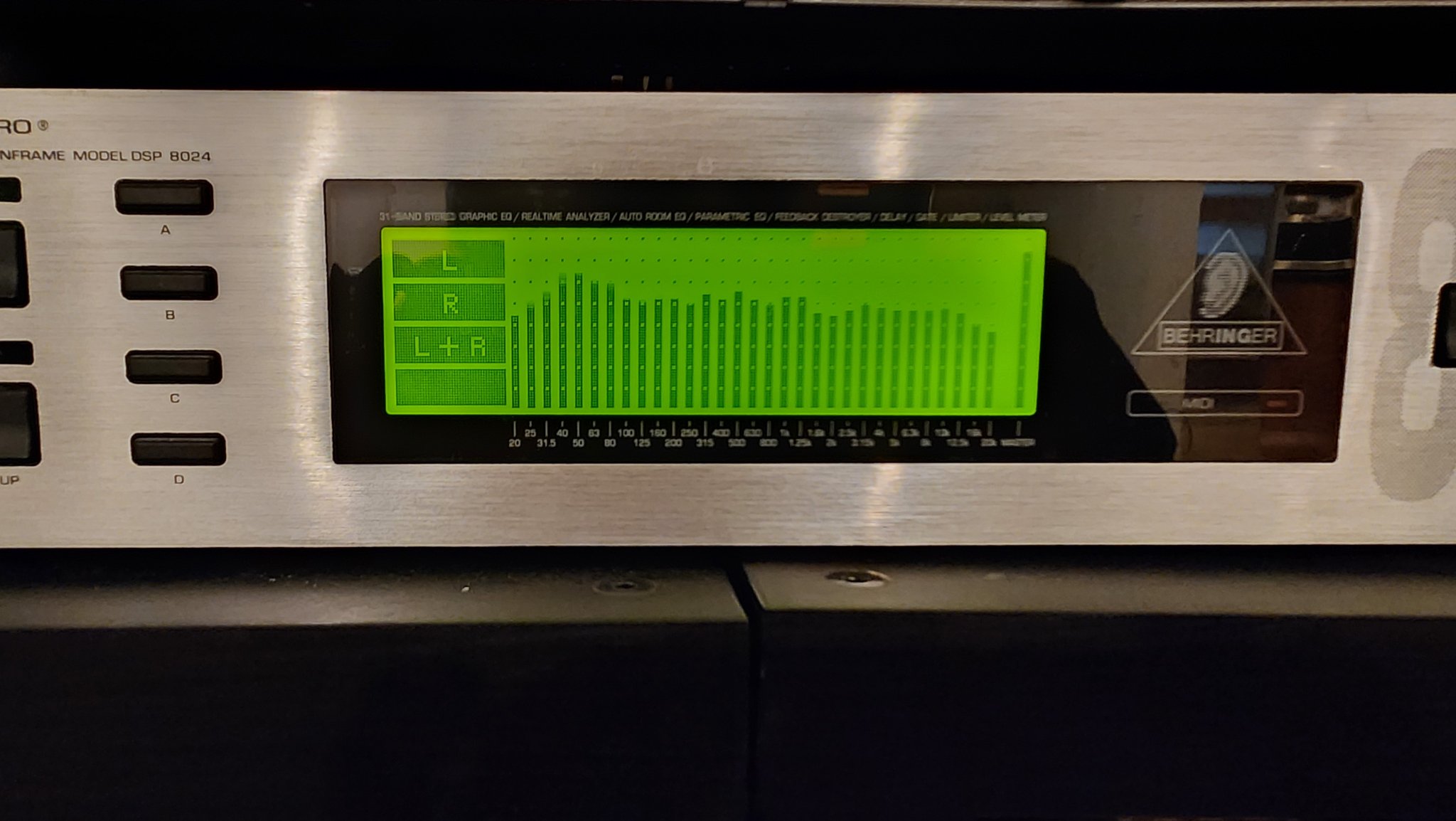

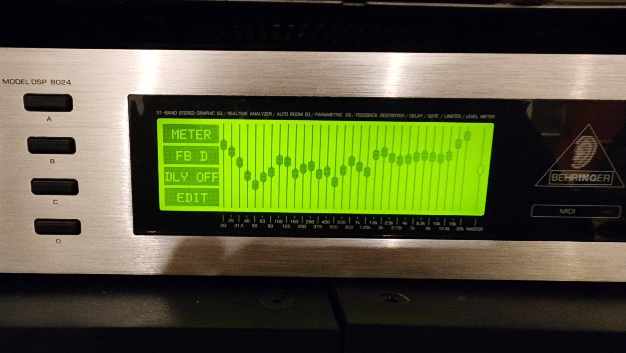

Cool pics. > I like hardware based analyzer/equalizers. It reminds me of a Behringer I once used in a workplace.Before eq, eq required, after...quite happy with the response in the listening chair.
What is it?

It is behringer ultracurve.Cool pics. > I like hardware based analyzer/equalizers. It reminds me of a Behringer I once used in a workplace.
What is it?

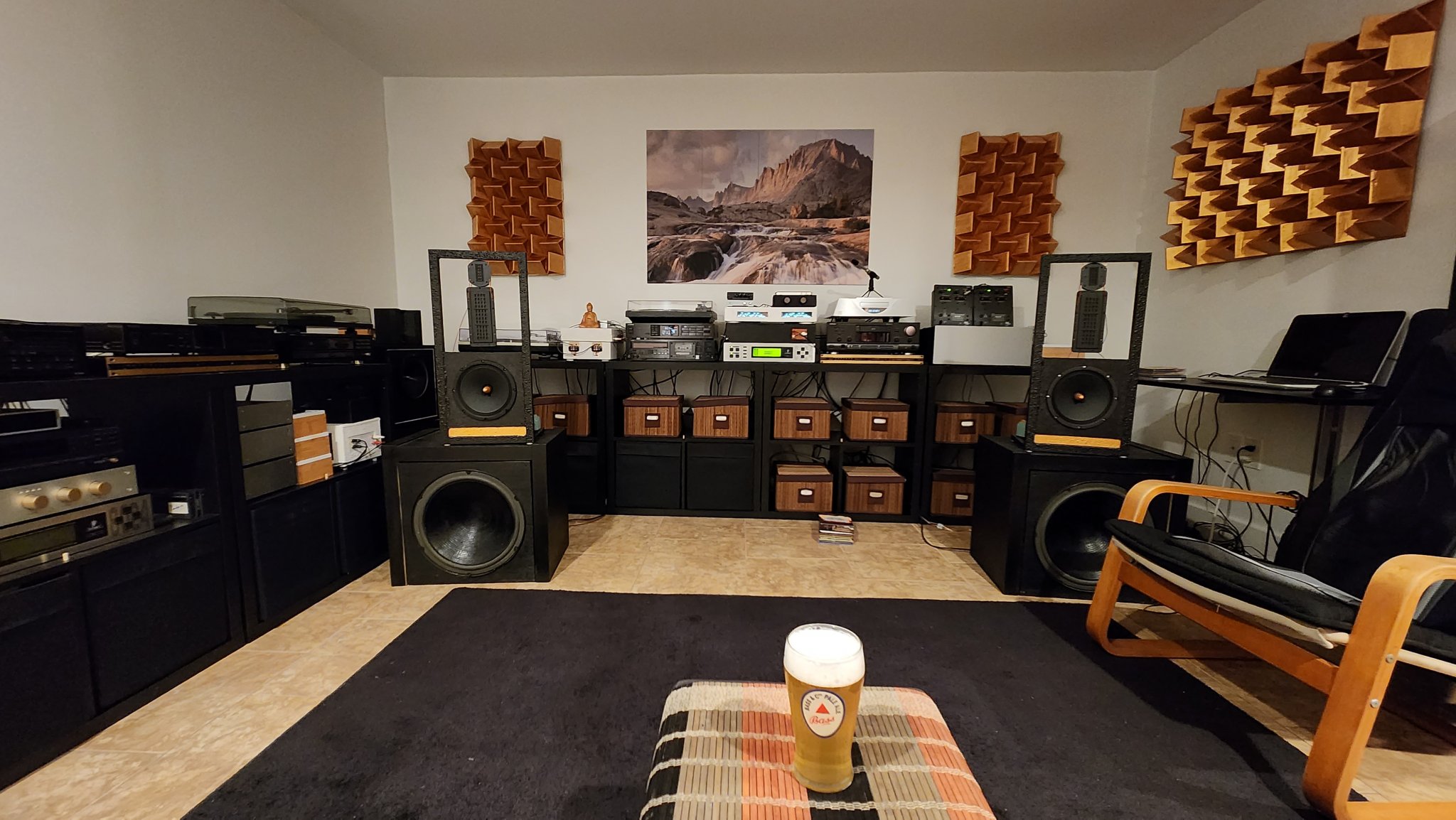

Amps? I use biamping with simple active crossover. Bass duties by various plate amps. Top by various amps on rotation: J2, wolverine, AlephJ, M2, F5, F1J, AN39, F3, F4, JLH and many other chip based permutations.

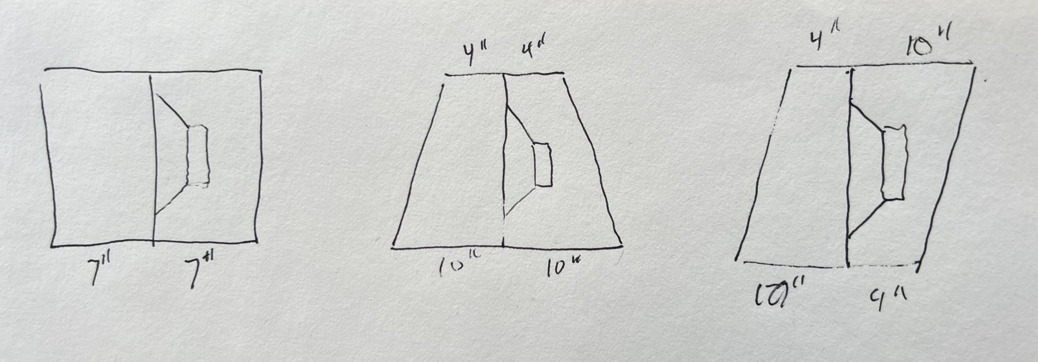

I have a question about U-frame and H-frame design. Assume you have a U-frame or H-frame design that is producing bass response you are happy with. And that design is 7” deep sides (on one side for a U and both sides of the baffle for an H). What is the impact on response (generally) if you change the shape, but keep total volume the same? See the example image: 1 is normal, 2 & 3 are shape modifications which keep volume consistent.
Nearly what ever OB bass speaker need active correction to play bass. If driver have big Xmax and high nominal power, only then proper correction can be made. Corrected OB play very good bass. Most significant difference of U- and H-frame is that U-frame is nearly omnidirectional at first dipole peak, H-frame is dipole in full frequency range it produces. With same on axis FR U-frame can be half size of H-frame. Inclined H-frame had nearly no sense other had cosmetical and FR is determined by the smallest front and back separation length what frame have.
