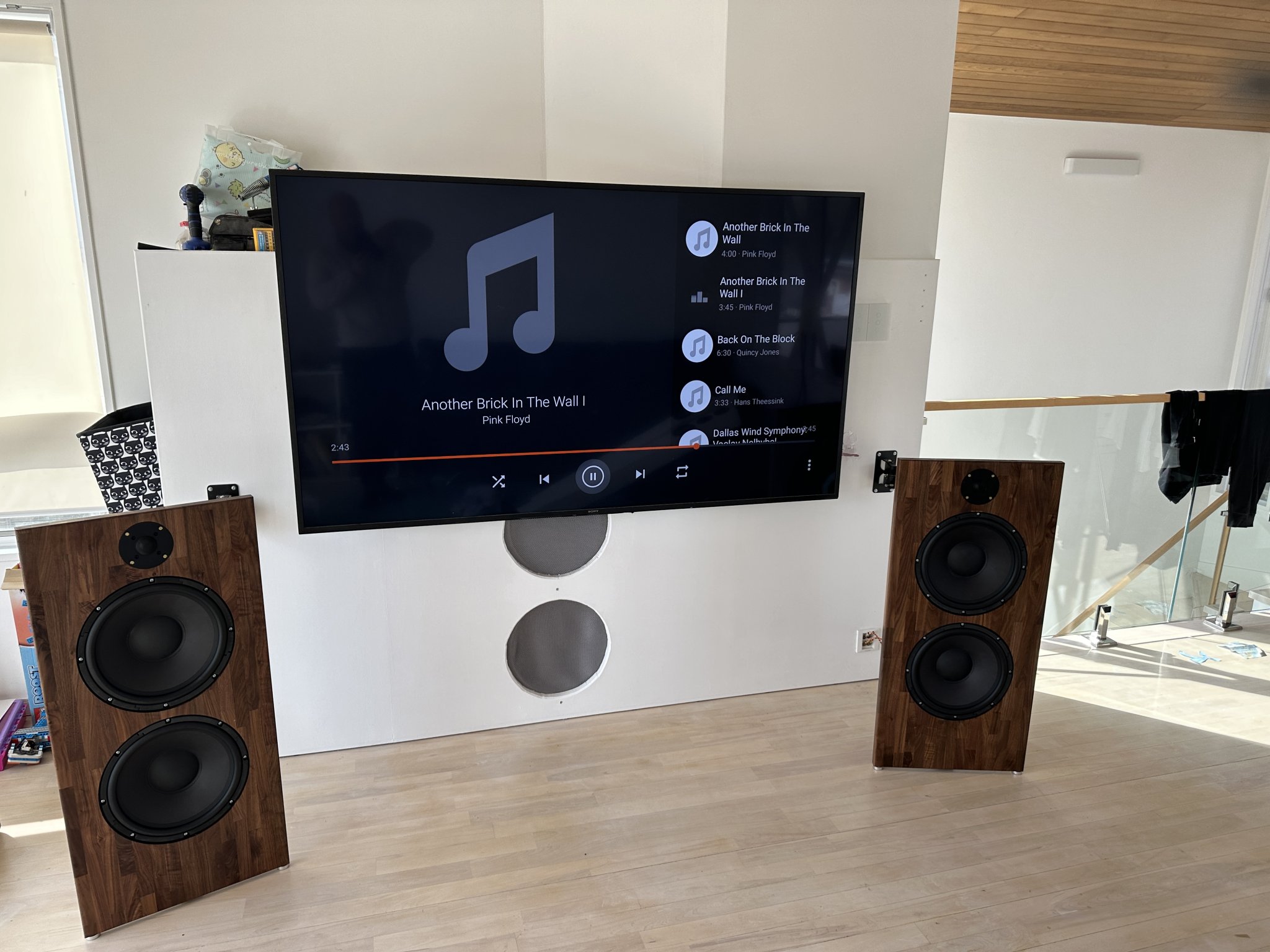

Inspired by New Record Day video about the Caladan by Clayton Shaw, I decided to do it DYI since shipping costs to Japan are ridiculous (and no international deliveries at the moment provided). My MiniDSP serves as an active crossover for two ICEPower 125ASX2 amplifiers. They sound amazing, using a Linkwitz-Riley filter 48db at 1kHz and some gain in the low end, Never thought open baffle speaker can have such a lot of low end, while the speaker membrane is barely moving. The speaker disapear and you feel like in a live concert. This works also for my music with distorted guitars, not only for the high end demo music. Bass guitars sound so real. This is the first day listening to them after waiting 3months for the delivery of the 12inch speaker drivers....I guess no burn in needed. Clayton Shaw chose the perfect drivers..... measurements etc. to be performed
Thanks for posting this. I've been intrigued by the Caladans too.
Also interested in which drivers you used. Sounds like this is your first open baffle experience?
I've been intrigued by Clayton's move from Beyma AMT tweeter with waveguide to this new design, while keeping about the same xo point and 12" midrange. Also about his use of such wide baffles for the tweeter and midrange vs using narrow/minimal baffles.
My interpretation is that Caladans run both 12" drivers from the lowest end and one of them is cut above a certain frequency (with a coil) such that the top 12" is the only one reproducing the midrange. Are you doing the same?
I built also the Linkwitz mini once and heard some open baffle at High end shows in tiny rooms woth lots of people and exotic tube amps. Never was hooked before maybe because of the type of music that is played usually in shows). Never heard heard ACDC or Alice in chains live recordings on such speakers. Hells bells intro sound frighteningly good now! I got my information from the new record day video and the homepage Clayton Shaw Acoustic lab. Caldan is 2-way, crossover 1kHz (looks like 2nd order L-R). So my first test was based on this information and it sounded very good to my ear "out of the box" (except the gain in the low end and cut off below 20Hz). I will measure and maybe can be tuned better (crossover steepness, correction of room modes) for my room in the coming weeks.
Hi housemd, do you happen to be in Tokyo? I was just looking at purchasing Caladan's and bringing them back during my next holidays and curious about build process.
