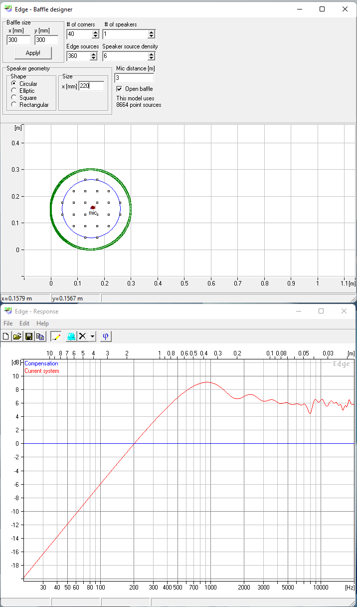

There is no mention of any active EQ being used on this speaker. But even if it was, adding 20 dB could extend the response to 40-50 Hz. The penalty is of course a massive increase in amp power and cone excursion.I am just starting to look at open baffle designs but as there is no magic in physics and following the Occam's razor, is it plausible that a 6dB slope compensation let say up to +20 or even 24dB makes the job based on the 91dB sensitivity (see in post #19) to reach a "reasonable" power handling (value not mentionned in the paper #19)? Is it possible to put more figures on that thanks to the loudspeaker excursion in open baffle (very long excursion driver?)?
The problem is not so much that the required power will be unreasonable but that the driver is simply not able to operate nicely when the gain is increased by 20dB or more to equalize the dipole response to be flat. One issue is the increased excursion demand. To check this, model the driver as if it is in a closed box with a volume that is very, very large, e.g. enter 999999 liters or whatever for the box volume. Check out the cone displacement for 1W. Now increase the power by 20dB to 100W. Does the cone excursion remain within the acceptable limit (e.g. Xmax)? Keep in mind that this 20dB boost is just to equalize the low frequencies up to the 1W SPL level at some higher frequency. It's not making it "loud" - the equalized dipole speaker will just be operating as if you applied 1W to a closed box speaker!I am just starting to look at open baffle designs but as there is no magic in physics and following the Occam's razor, is it plausible that a 6dB slope compensation let say up to +20 or even 24dB makes the job based on the 91dB sensitivity (see in post #19) to reach a "reasonable" power handling (value not mentionned in the paper #19)? Is it possible to put more figures on that thanks to the loudspeaker excursion in open baffle (very long excursion driver?)?
The other problem with trying to use too much boost is what I call "distortion amplification". Distortion products such as harmonic distortion will appear at a higher frequency than the fundamental. Let's say driver X in a closed box has -40 dB of 4th order harmonic distortion at 100Hz. This means the distortion component at 400Hz is -40dB compared to the level of the fundamental at 100Hz. Now make this a dipole. If we are far below the dipole peak, the response is falling at 6dB per octave. 400Hz is two octaves higher than 100Hz, so the level at 400Hz is 12dB higher than the level at 100Hz. This also "magnifies" the distortion product by the same amount, changing what was a -40dB distortion level (1% distortion) into a -28dB level (about 4%). Taking this further, if the response is 20dB below the level at some higher frequency then there will also be a 20dB magnification (10x) of the distortion product there. One side effect is that higher order distortion products will be magnified more than lower ones, and higher order HD is typically thought to lead to bad sound.
In my own systems I try to limit the bandwidth of any driver used as a dipole, especially when the baffle area is relatively small, to no more than about 2.5 octaves when possible. 3 octaves is pushing it IMO. This helps to reduce the power lift required and will minimize the distortion magnification problems.

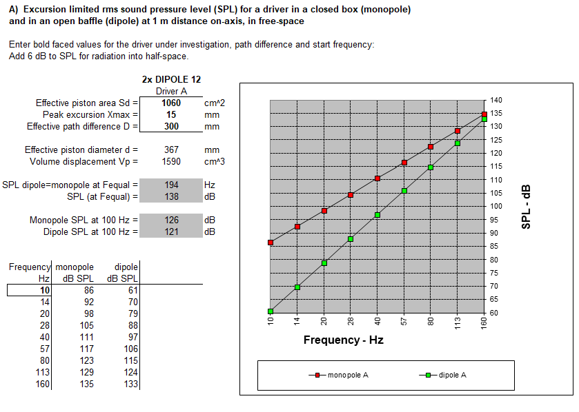

I've got a spreadsheet made by Linkwitz that calculates max SPL in open baffle and closed box. Here's the results for two AE Dipole 12 with no baffle and in closed box.
It's quite possible to get down to 40-50 Hz with decent SPL level with these drivers and some giant series coils in the crossover, I think.
But 20 Hz? Not gonna happen.

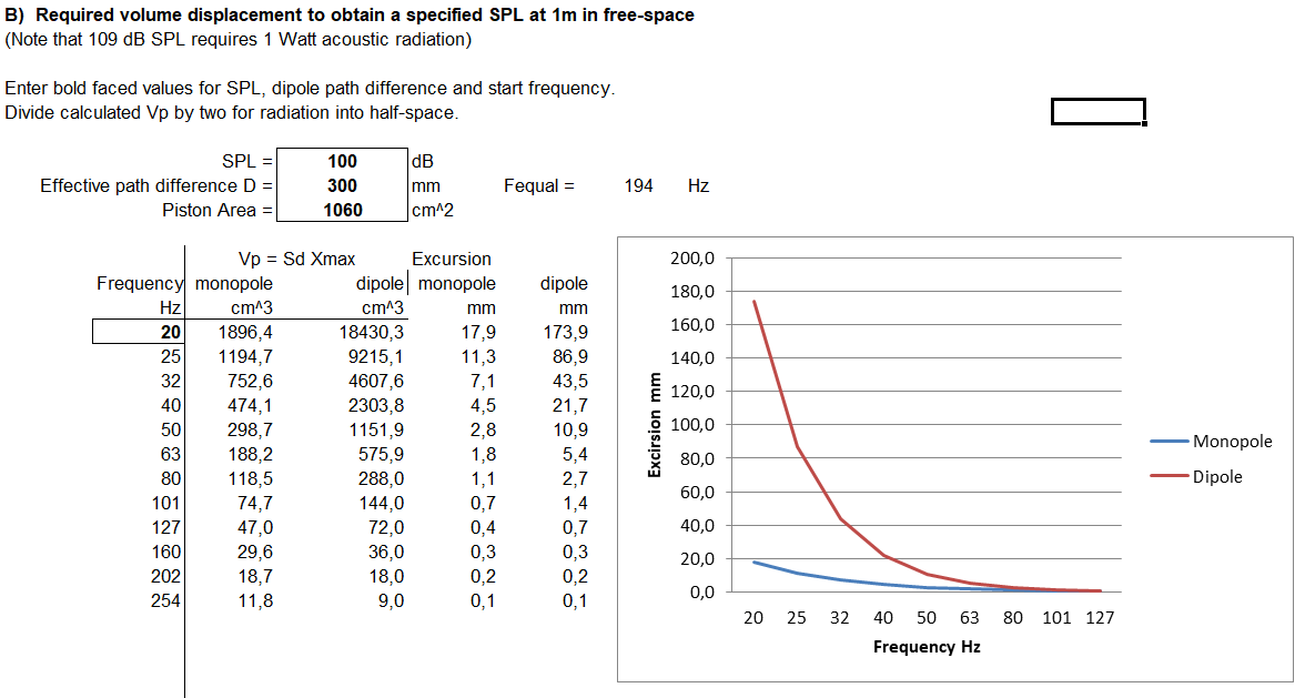

The problem is that the required cone excursion for a given SPL increases 8 times for each octave below the dipole peak. Two octaves = 8^2 = 64. Three octaves = 8^3 = 512. Four octaves = 4096. You get the idea....
I gave up dipole sub a long time ago. Even sixteen 21" in very large H-frames was not up to the task of reaching 20 Hz with low distortion and high enough SPL.
I've reworked Linkwitz' spreadsheet a little to visualize the excursion needed for a given SPL with a given driver cone area and path difference (the baffle size).
Here are two 12" naked drivers shown.
Thank you for the simulations and all the other comments/opinions that help me to understand open baffle. Some terms remain unclear to me...I've reworked Linkwitz' spreadsheet a little to visualize the excursion needed for a given SPL with a given driver cone area and path difference (the baffle size).
- Monopole : which real situation is it?
- Dipole : open baffle in free space conditions I guess. Meaning without the effect of the room
- The excursions in the table in #36, is it peak (so to compare to the 15mm peak in #31)?
