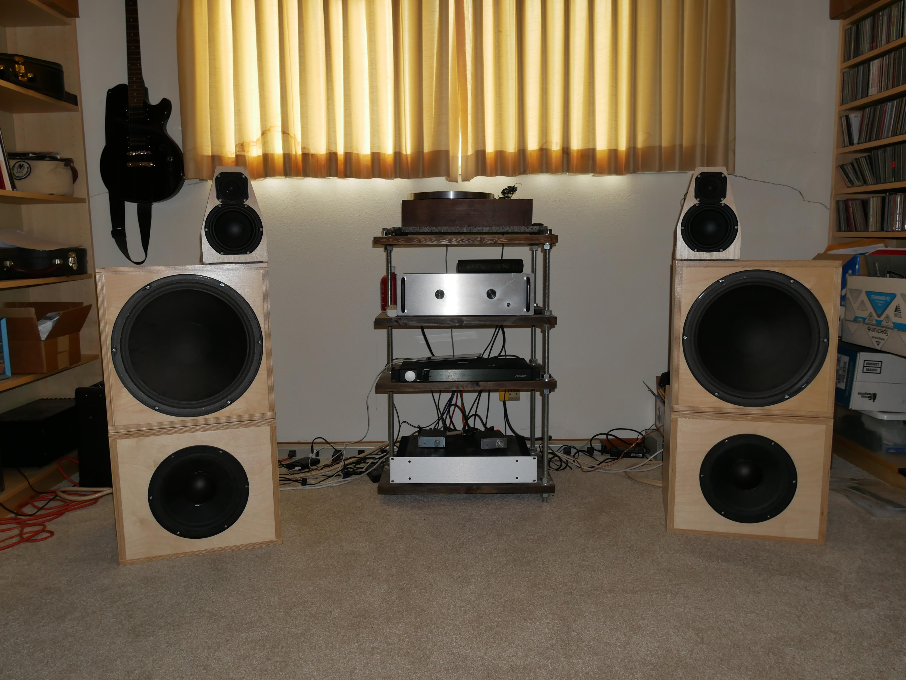

OK, I'll play. Here's my current, evolving, 3/4 OB den music system. The room is small for OB speakers, but it's too small for much of anything to work optimally. This was mostly built from drivers I already owned and re-used from other builds. Total driver cost was under $100/channel.
From the top:
TC9FD18-08, 3000 Hz & up
Peerless SDS-860656, 700 - 3000 Hz
Jamo 20388 (PE buyout from several years back), 5" deep u-frame, 150 - 700 Hz
NHT 1-11-083-2 woofer (from NHT liquidation, I think these were a raffle prize at an early Burning Amp), ~30 to 150 Hz, small sealed boxes with a gentle Linkwitz transform to reduce the system Q from .9 to .56 and slightly extend the response.
Baltic Birch cabinetry with clear poly.
MiniDSP 4x10HD, using S. Harsch topology (BW4 lowpass, 2nd order Bessel highpass acoustic slopes, upper driver delayed 1/2 wavelength @ crossover frequency + physical offset compensation) for all three transitions.
4 channel Modulus 86 amp for the upper drivers (sliver faceplate at the bottom of the rack).
2 stereo Breeze TPA-3116 amps running the mid-bass & woofers.
