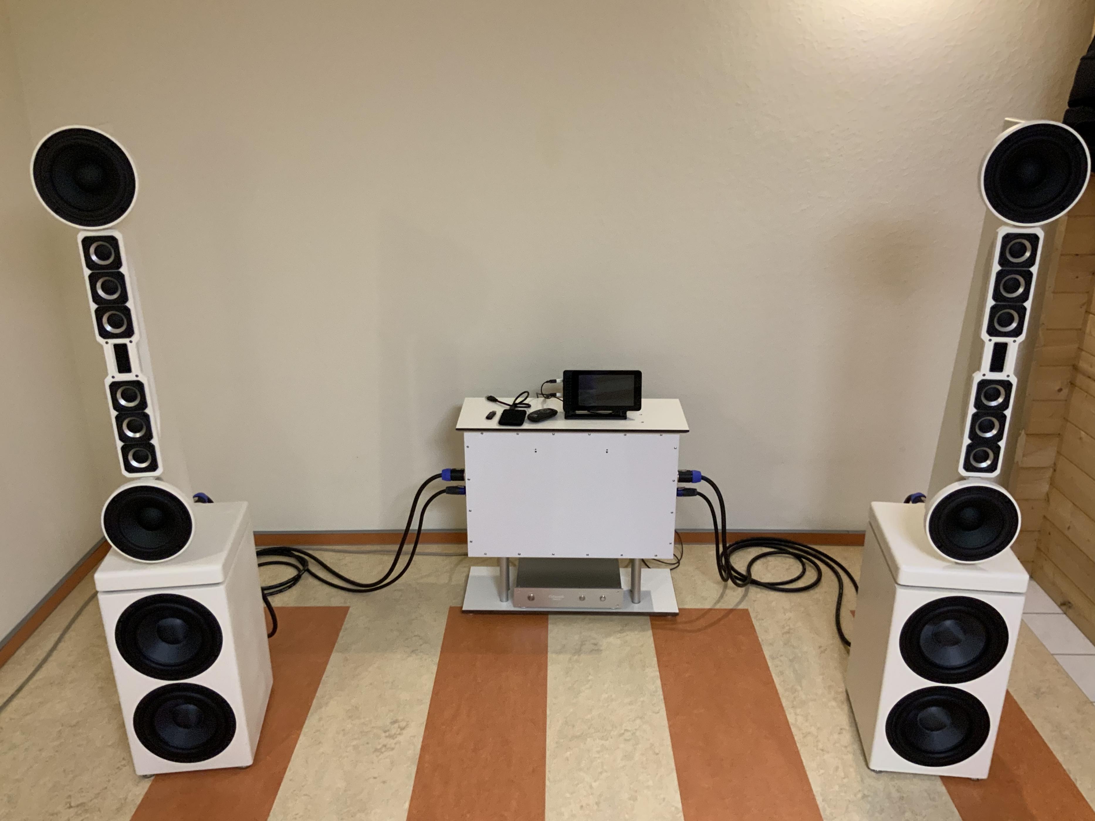

Hallo,
Let me introduce Safineia evo, 4 way Open baffle project, with Rpi Streamer (allodigione signature / RPi3b+); Hypex Fusion amp FA253/252, open baffle speaker with damped u-frame sub, line array mids and ribbon tweeter.
Best regards
Michael

Hi Michael,
thanks for showing us.
Can you give us some more details?
I would be interested in
  • which drivers are used
  • xover frequencies and type
Thanks and regards
Matthias
Hallo Matthias,
The chassis which I used are based on best k*a / xo and lowest harmonic distorsion (based on Hobby-HiFi).
Sub: Visaton TIW 200 XS
Lower MID: SB Acoustics SB17NBAC
Upper MID (line array): SB Acoustics SB65
Tweeter: Aurum Cantus AST 2560
XO: 130Hz/1000Hz/4000Hz; LR4
Best regards
Michael

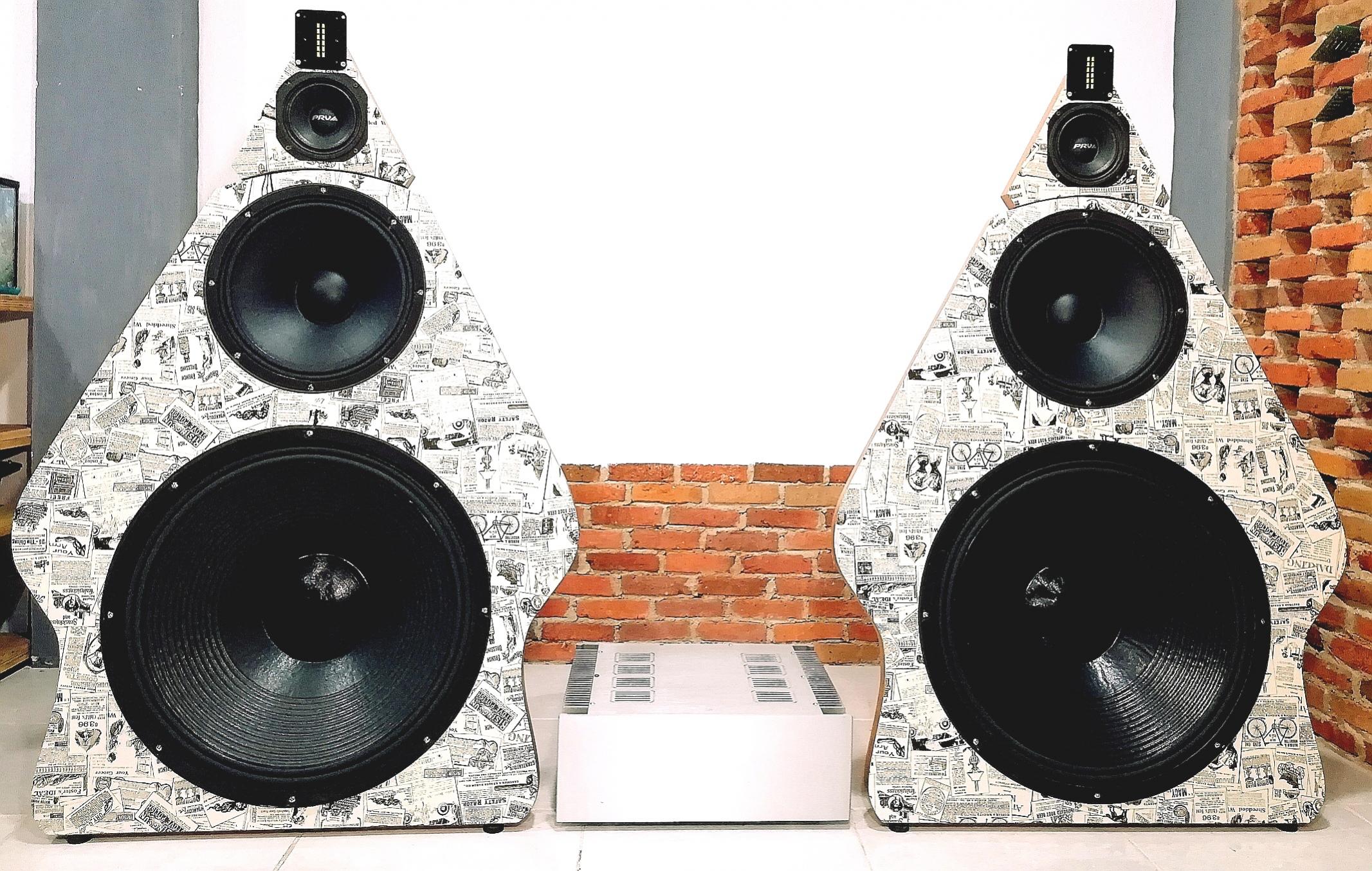

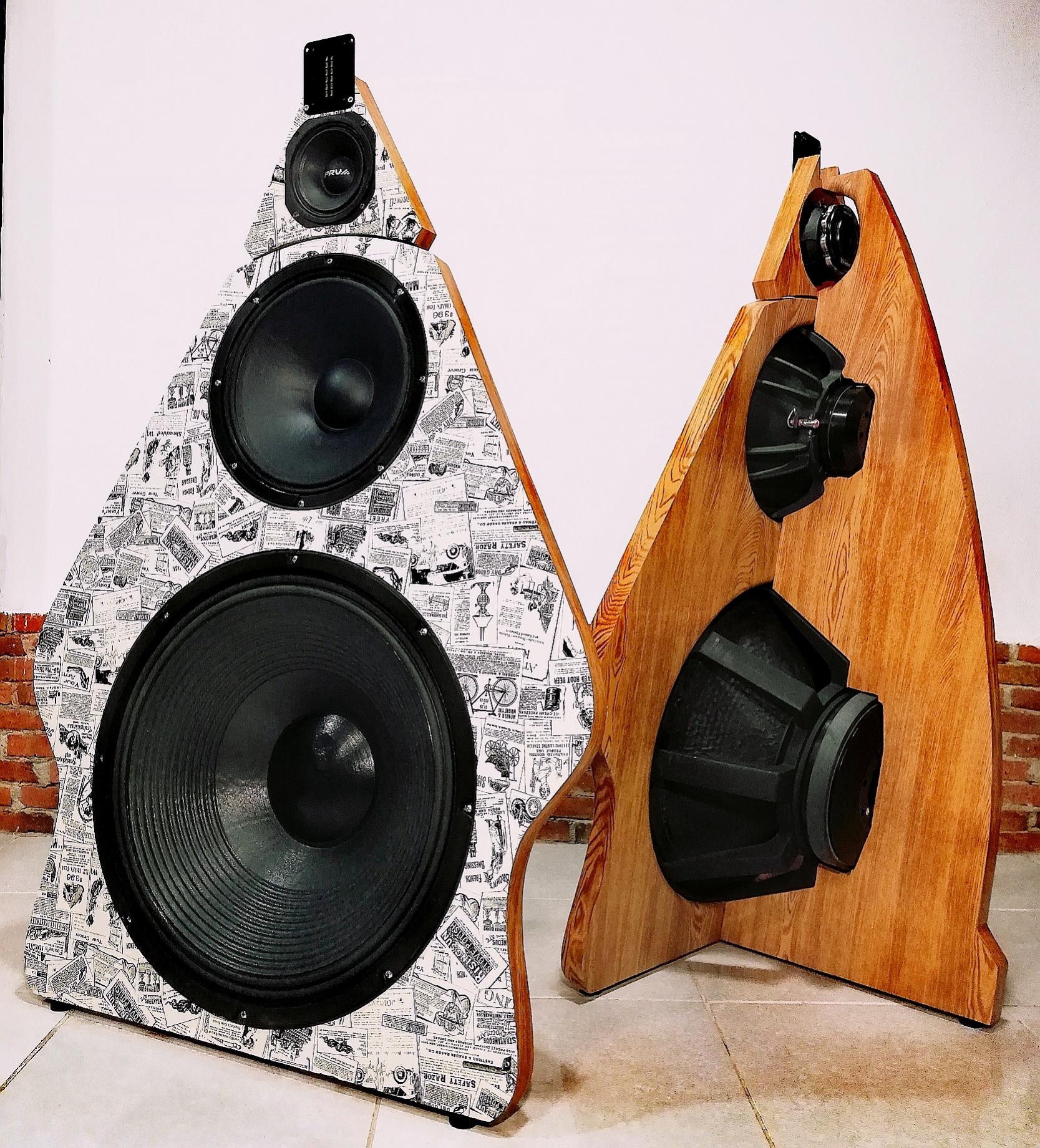

"Gunungan" 4way dsp Open Baffle
DSP : Minidsp 2x4HD
Driver : Amplifier
21" ACR Fab 113212 : D4K5 1kW Class D
12" ACR Fab 75124 : D4K5 1kW Class D
5" PRV 5MR450 : PeeCeeBee v4 50W Class AB
Beston RT002-dipole : PeeCeeBee v4 50W Class AB
Next : crossover setup + measurement 👌 I will use Harsch xo as 1st try

Hi Michael,
nice to see some more crazy people in our country...
Very nice built and thoughtful design! Guess it was also a lot of work! Do I see some plexiglass baffles there, or is the line array completely naked?
Best regards
Mattes
Hi Mattes,
Yes, there is only an open baffle for the line array, do to best dipol 8. You will find more pictures on octaaudio – DIY Open Baffle Projects.
Best regards
Michael

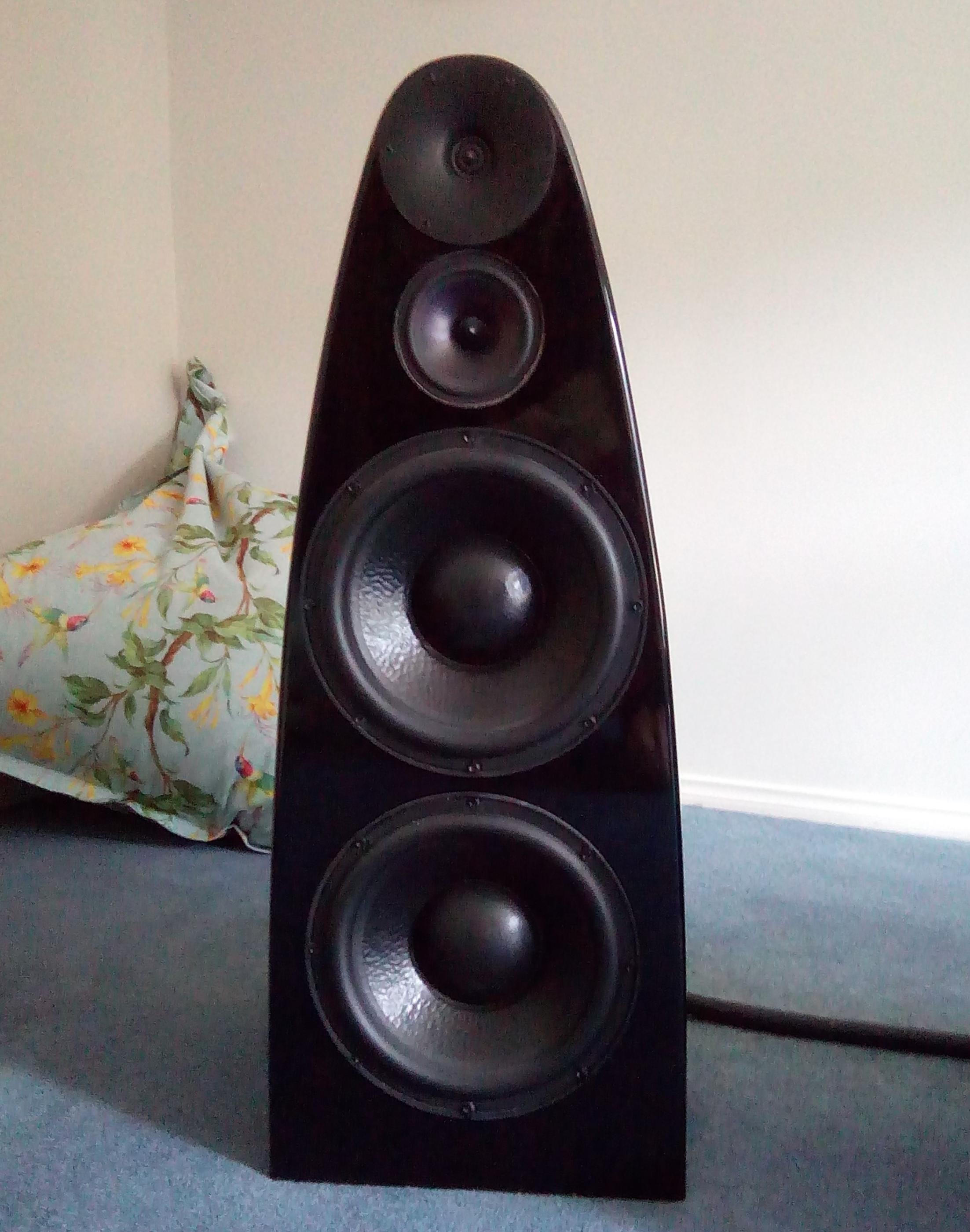

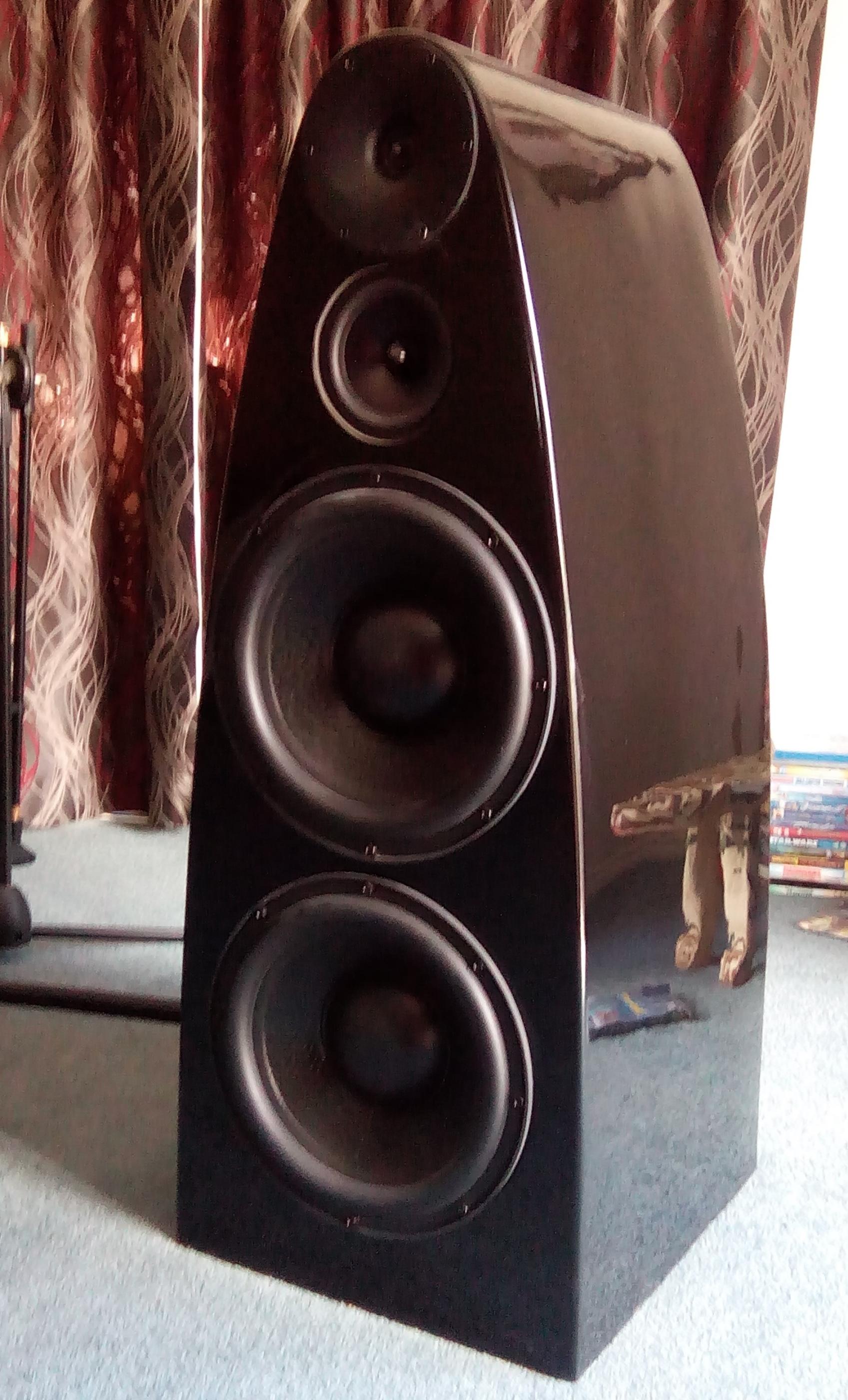

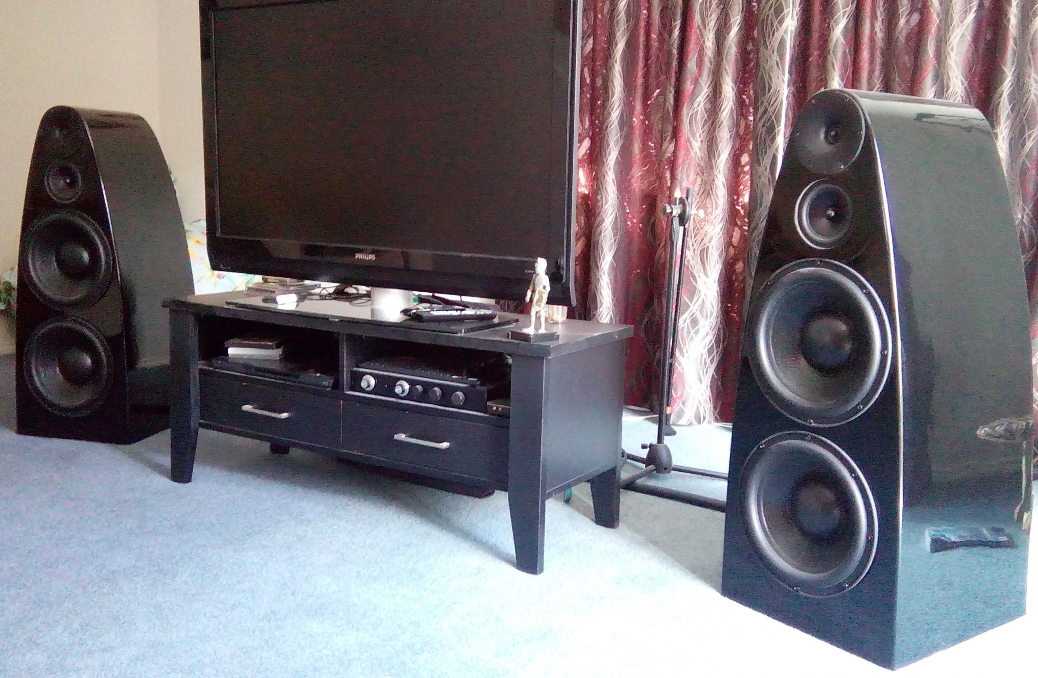

I'd like to show my 3 way active open baffles. They've been running well for a few years now, with occasional upgrades along the way.
They look like box speakers from the angle photos, because they are 'U' baffles - but they're open at the back.
Bass is 2x12", from BK electronics in the UK. Used in their well regarded 'Monolith' subs. Similar to Eminence Lab 12.
Mids are Dayton RS150 6" Ali cones. Vifa XT25 ring tweeters on Visaton WG148 waveguides, plus 19mm rear tweeters.
Amplification, 4 stereo amps = 8 channels. Heavily rebuilt Quad 405's with no current limiting.
Active crossover. Digital FIR linear phase, measured with REW, programmed in rePhase and run through Equalizer APO.
All music and processing on a windows computer. 20Hz-20KHz -3dB in room. Measured with Cross Spectrum individually calibrated UMIK-1.
Full size speakers on 'U' baffles are unusual because of the potential for resonances in the rear cavity. The up side is powerful extended bass which integrates perfectly with the rest of the speaker.
Actually the rear resonances are fairly easily tamed. A combination of design, damping and EQ tames them totally.
The speakers are curved and sloped, with no parallel sides or edges, so resonances are not encouraged at any particular frequency, and the rear cavity is well damped with foam and wool.
Any remaining resonances are smaller that the room resonances and can be EQ'd out easily.
The finish on the speakers is Piano Black, so there are some weird reflections of furniture on the side of the right speaker.

Beauty.
Any snaps of the back of the speakers? Curious your methods. Wish I could hear em.
