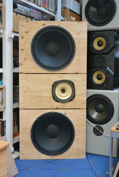

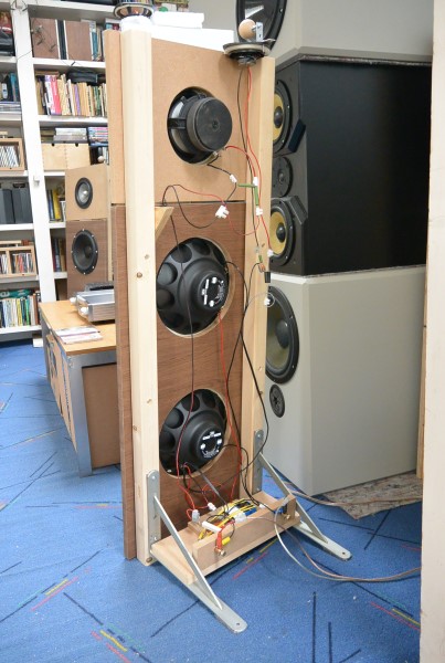

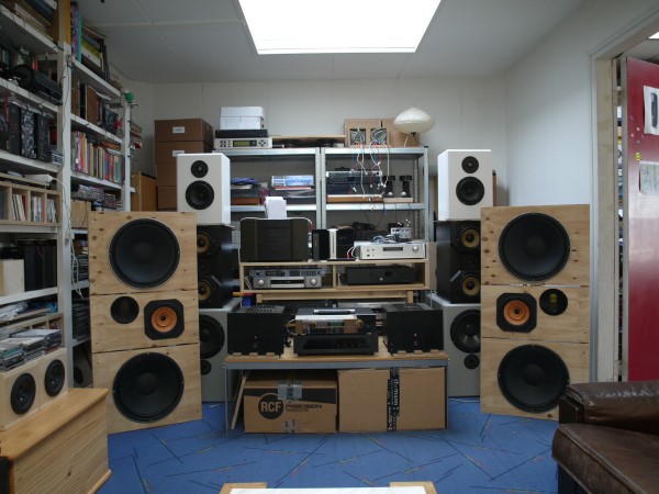

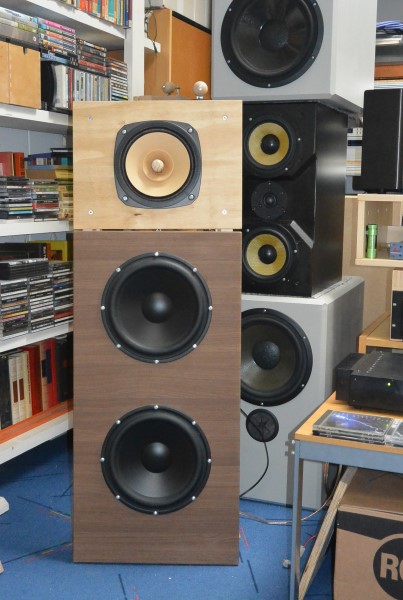

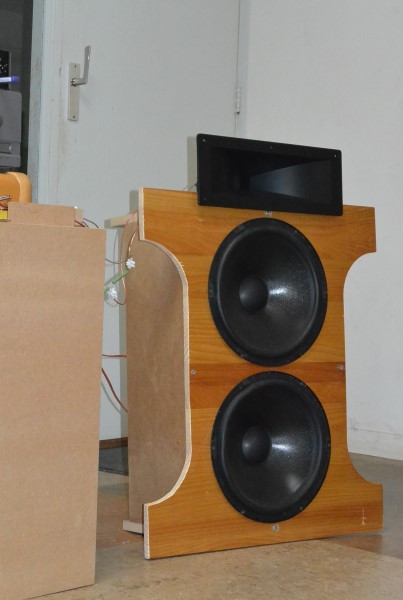

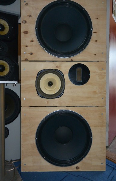

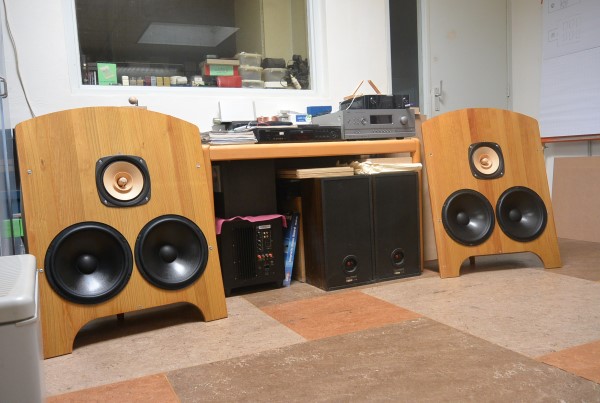

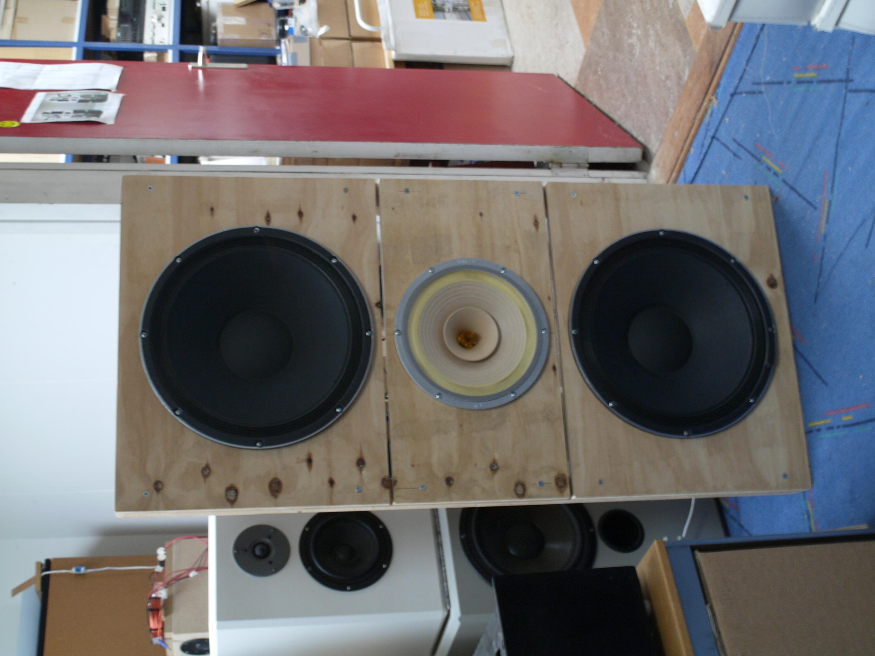

Just some experiments I did on OB 🙂
I did the Leonidas XO for PAP and try to test as many FR drivers as possible.
Also tried many 15 , 12 , 10 inch woofers.
After over 50 years diy speakers , OB is , for me , the way to go !!
Hope you all have fun and.......enjoy the music 🙂

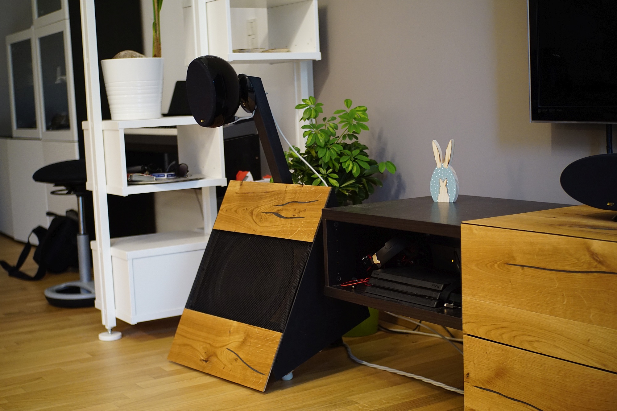

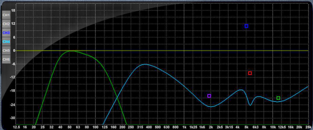

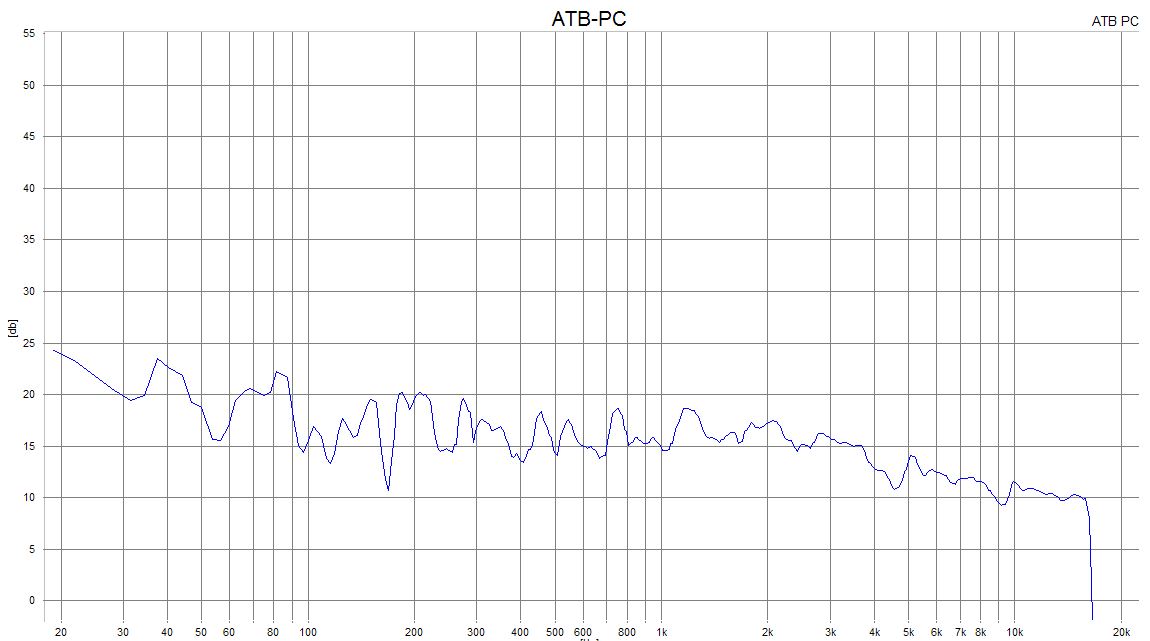

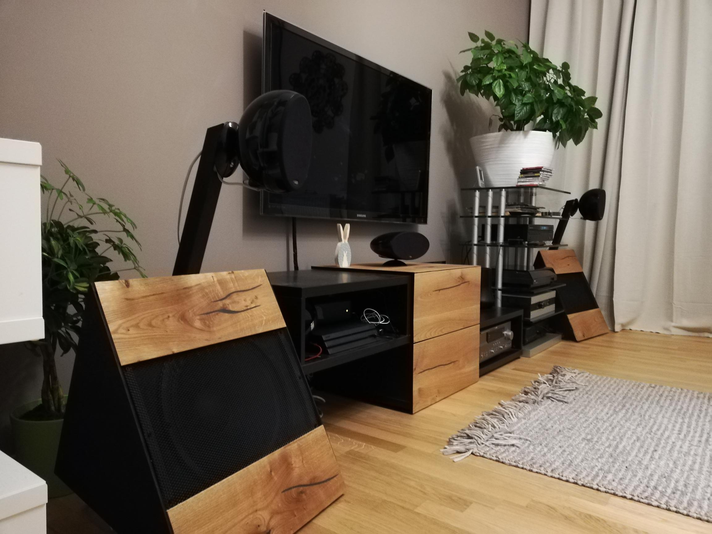

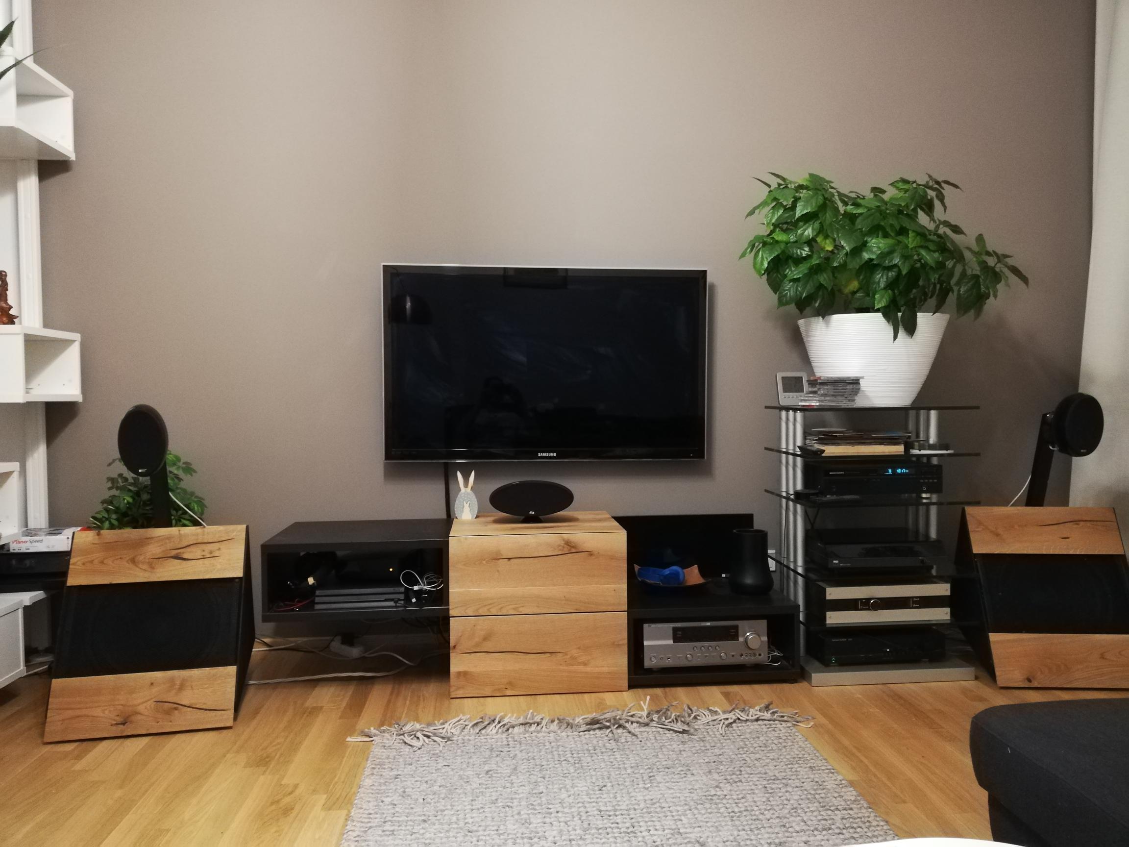

Here's the current incarnation of my hybrid speakers: OB bass + point source coaxial mid-high. It might inspire someone looking for a high-WAF OB (at least my wife is happy..)
I've got the idea to use the KEF HTS3001 sattelites from Patrick Bateman in the snytrip thread - takin the opportunity to thank him here ! The UniQ coaxial is really, really good and clean. I believe combining them with OB bass is a very effective way to get a great sounding speaker.
Some technical details:
- OB is Eminence Beta 15A in a "wedge"/Y baffle, helped by Graham Maynard's (RIP) T-Bass circuit published on this forum
- crossover at ~250 Hz LR2 (miniDSP) + room EQ
The KEF coaxials are replacing my Visaton 6xFRS8 + NEO3 PDR array panels (OB). As with most things in engineering, this is a step down in terms of naturalness and authority of vocals, but a step up in terms of imaging and resolution (plus much smaller size). At the moment I am happy with the result.
Indeed! Looks great. Nice design, and I also believe it would score WAF points.
But, if you are already using the miniDSP, why do you need the T-Bass circuit?
Thanks !
This has been a long and heated debate in the original T-Bass thread, with Graham arguing that T-Bass does something you cannot do with EQ alone, namely compensating the time-domain transient response of the large woofer + amplifier combo. The details are in 'T'-bass drive for OB LF drivers.
Personally, I do feel that there is somethig audible to it, so I'm using it together with miniDSP.
Thanks,
I'll have a read over there, but time and phase alignment could be done using RePhase and the FIR filter import in the miniDSP.
Bzfcocon do you have a schematic or some values for your T-bass circuit?
Read the whole tread. Tempted to do a test myself.
Big caps must also be bipolar, right?
The schematic is on the first page of the thread. For the Beta 15As I use the following values:
L = 6.8 ohm, 0.26 ohm ferrite core
R1, R1 = 1 ohm
C = 330uF (bipolar) - I am cutting higher
Transformes are toroids, 250 VA 2x 18V (only the secondary is used)
I don't use the low pass filter on the right part of the schematic - that is optional and can be replaced by DSP/crossover.
Warning: you MUST use a 4 ohm capable amplifier. The impedance of the assembly is low. But it does not have to be an expesive one and you don't need a lot of power: with OB you typically run out of Xmax long before you run out of power. I'm using a good old HK 620 and it does the job just great (even at somewhat higher SPLs)

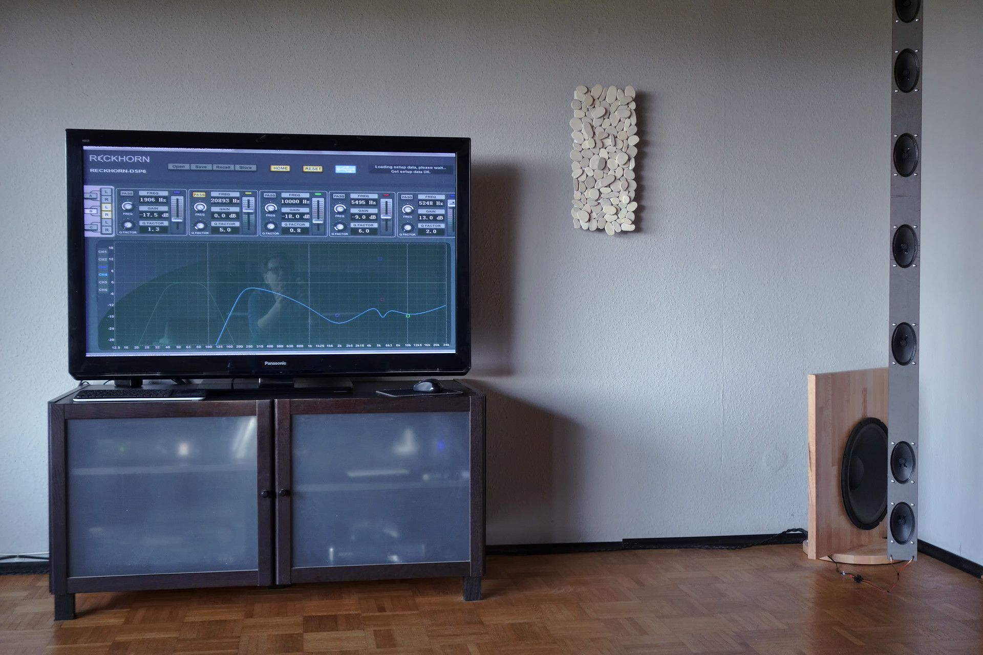

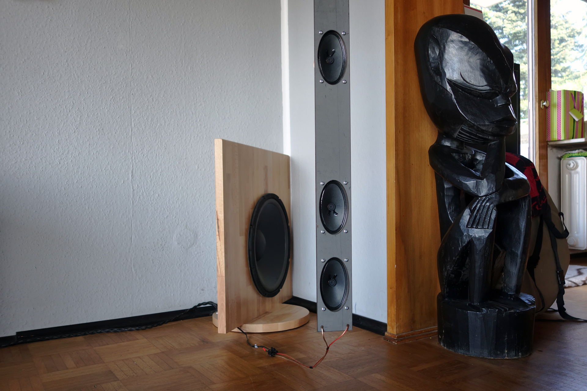

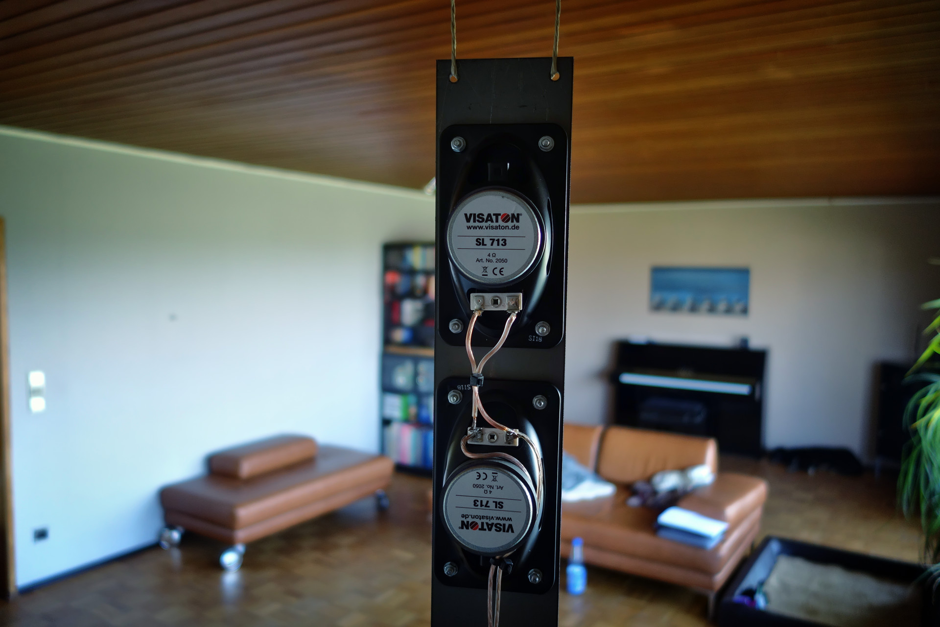

Current and fourth setup after almost four years playing around with open baffle. Line Array Dipole with Corner Woofer. Satisfied for now but final? You never know...
Dipol Width
Dipolplus - Alles über offene Schallwände
Sparse line array
So gehts: Line-Array dimensionieren - Visaton Diskussionsforum
Golomb ruler - Wikipedia
Corner dipole woofer
Corner Dipole Woofer (CDW): info? anyone tried one?
Linearray
8 x Visaton SL7.13
SL 713 - 4 Ohm | Visaton
No power or frequency tapering
Baffle 1840 x 80 x 5 mm - Steel
Corner Woofer
OmnesAudio OBW1506 - 15inch open baffle woofer
8 ohm Qts 1.0, Xmax 12 mm, Sd 835 cm2
Baffle 600 x 600 x 28 mm - Solid beech glued
Active Crossover
Woofer Line Array X-over at 250Hz
Reckhorn DSP-6
https://reckhorn.com/frequenzweichen/139/dsp-6-digitale-frequenzweiche

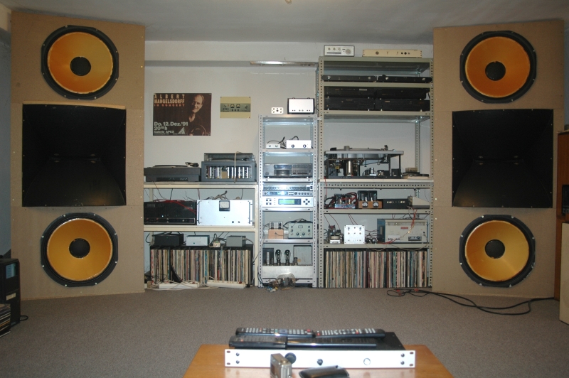

Hello ,
here is my open baffle project . 24 zoll Fane "Colossus" , JBL 2360 with BMS coaxial drivers . For mid and high I use single ended amps with RE604 and E406N and EL86 push pull for the bass . The active crossover is from Behringer , the final version is a tube crossover in the future .
Kind regards , Alexander .
