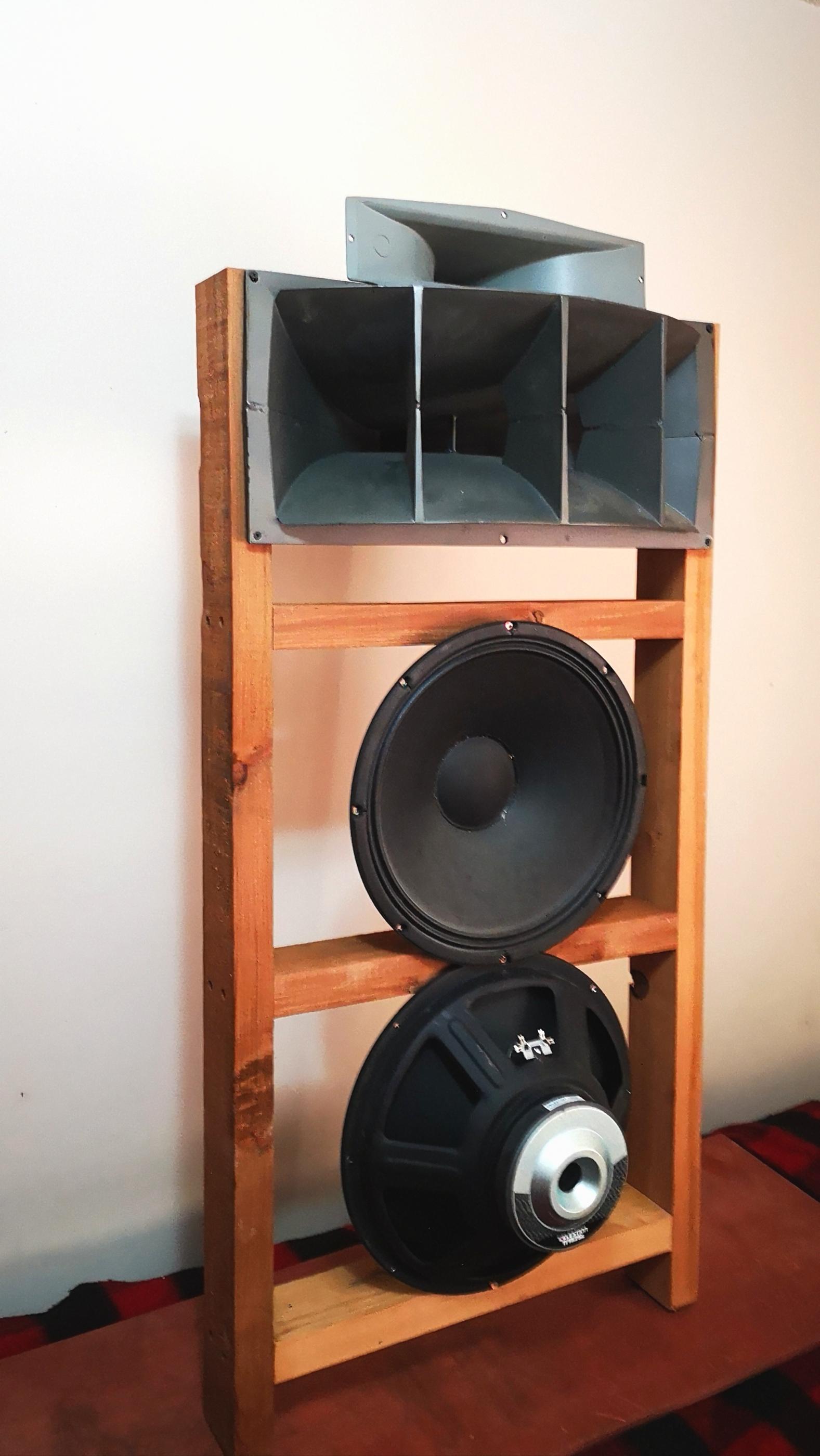

I've had my fun with the Van Halen planar dynamic hybrids, but was missing the transient snap of my horns.
Plundered my Onken cabinets, and am trying no baffle for now, as the Van Halens can be modded for a slob sub.
So far so good; the 2 Celestions are quite good without a baffle, as long as they're close together.
This pic was from this morning, prior to me mucking things up with wire.
I may post if I figure a way to do that neatly.
Maybe the easiest build I've ever done, and I think the no stain no oil no finish gets the steampunkish mancavd look I was aiming for.
Loving the exaggerated dynamics and colourations. The BG stuff is great, but horns are the fun date.
Are you getting decent bass so close to the wall? Clean lower midrange?
They are now about 4 feet from the front wall, and centre of woofers is about 36" from the sidewalls.
They are very very clean through the vocal range.
I'd hoped they would reach down to a subwoofer, but subjectively, that's unnecessary, even for movies.
I'm guessing it's better boundary reinforcement, being so close to the floor, some gain from a 30" vertical cylindrical wave launch, and the 1525e natural 40 hertz or so bass spike.
Cleaner sound by far, than my planar hybrid Van Halens. They had only a 19mm thick baffle, which I now think added lots of stored energy resonances, with each having 3 1525e drivers in it.
I'm very surprised the bass is adequate.
