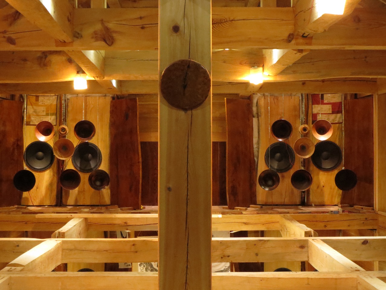

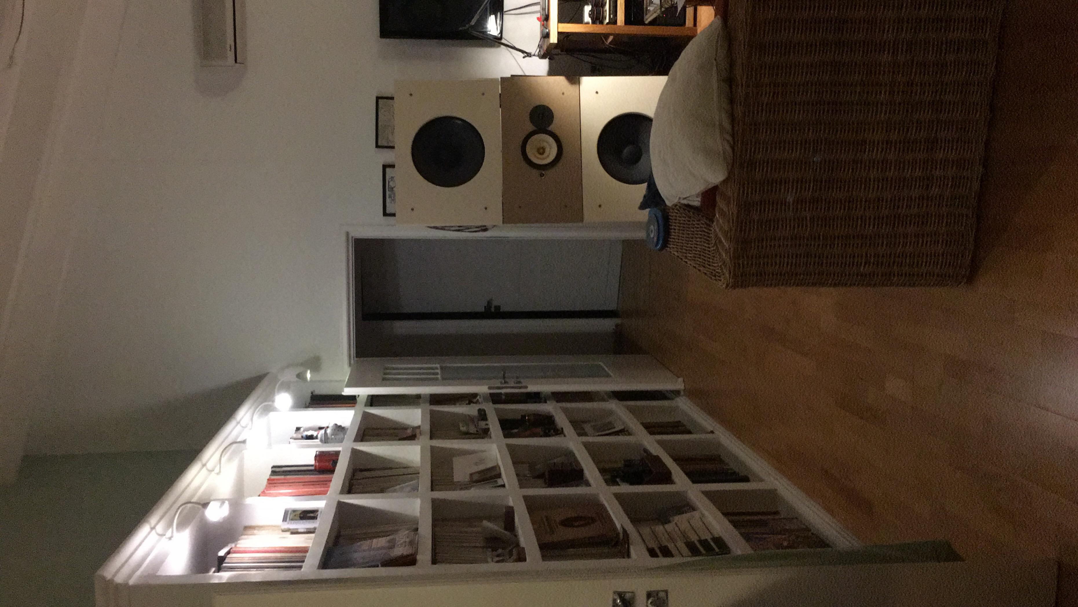

I don't have 18LX60 but have experience with another 18-inch unit 18G40, SM118/N and 18P80/Nd in open baffle operation. They sound excellent though my experience with a DIY speaker is only open baffle. I love their natural sound probably brought by no enclosure(woofer cone doesn't have air pressure). My open baffle isn't inside my listening room but at the border between the next room. This setup forces you to be a carpenter rather than an engineer. But you have the advantage of full usage of potential bass. It's not for a commercial product but for DIY use only because you need to sell both an open baffle and a house.😀
I use two by channel of Beyma 18LX60V2. With good sound. In OB, I chose them cause its QTC is fine for OB

But where do You sit when listening?😕
In a 50 m2 room. (With many carpets 🙂..). I think that's ok for OB listening. Have the opportunity to move around the OB speakers. Thanks.

No problem.🙂 My attached pic at #2625 was taken from my listening position, where it isn't the ground floor but the 2nd because the 2nd floor is far better sound. An open baffle hangs from a beam between my listening room(the front side) and a living room(the back side).

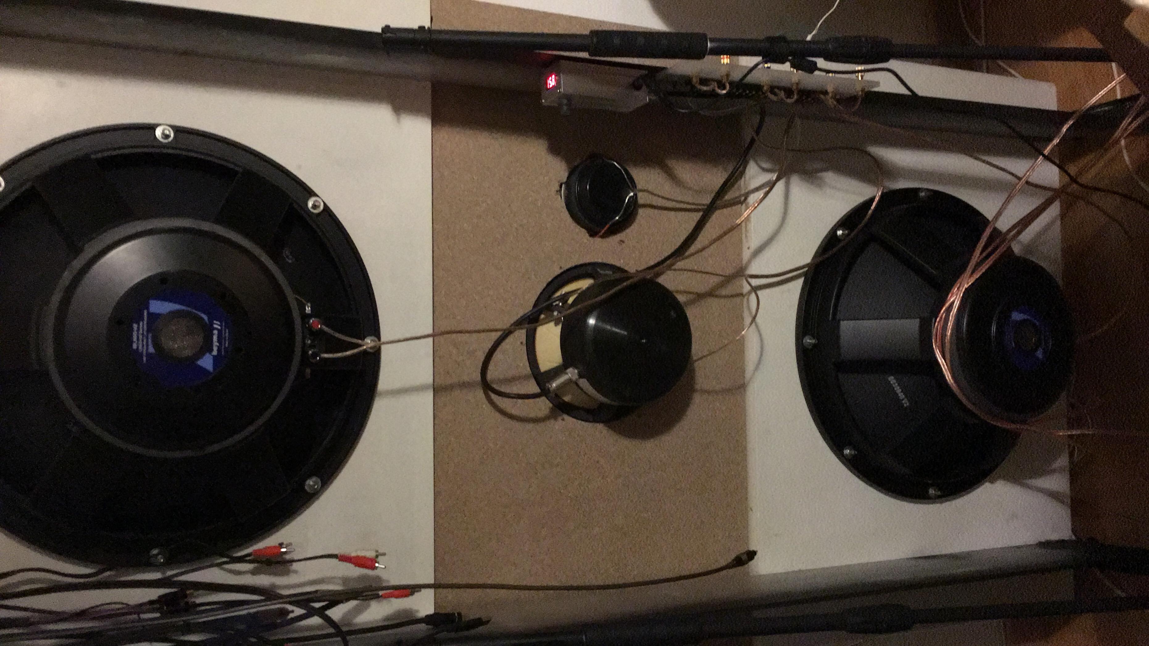

Hi.
slot loaded in in bass unit can lowered Fs and also Qts, I have a pair of OB speakers with slot loaded woofer.
Slot load a full range are totally different, as rules of thumb, the slot area should be 1/3 of Sd of your driver but I always fine tuned carefully using thick cardboard, and after finalised, I use ply wood instead.
Please read comment in youtube for further info + patent article # US2646851 (A) . Mr. Gilbert Briggs also mentioned in his article too ( Wharfedale SFB3 prototype ) . thank you.
This slot loaded open bass (right side on the picture) works very well in the range 30-200 hz. GPA 414 alnico.

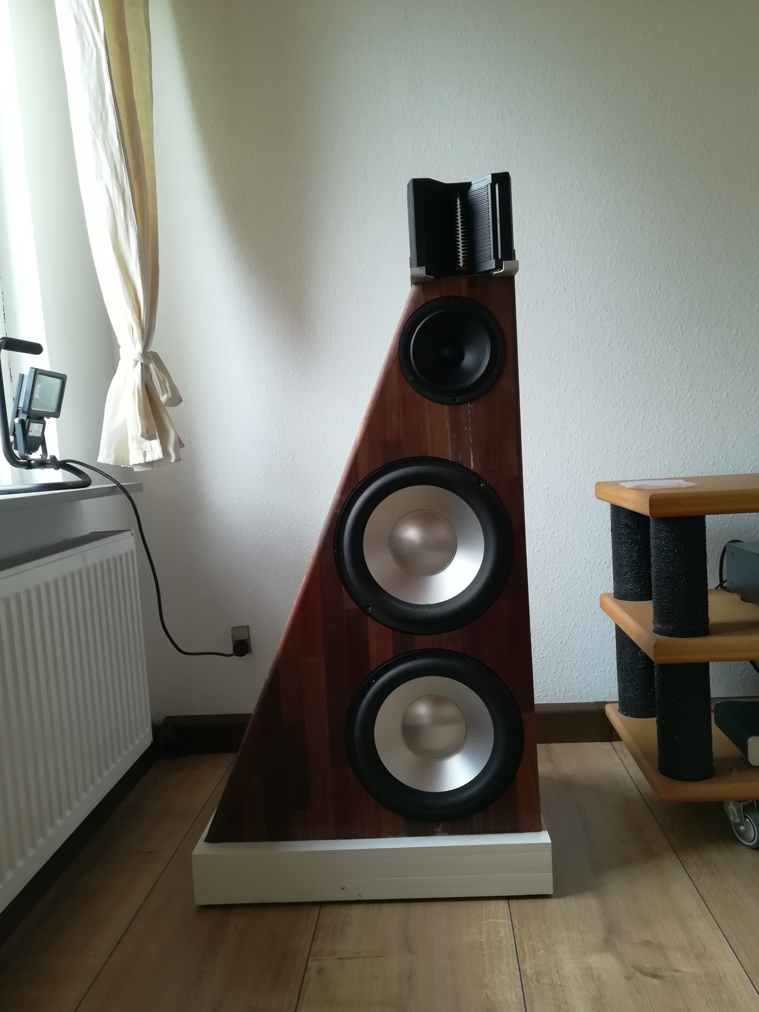

Interesting choice of woofers. I always liked the aluminum dust cones in my (ported) JBL woofers. I think it adds a little distortion and a little more detail than typical JBL 2225H.
Choice of woofer
Hi

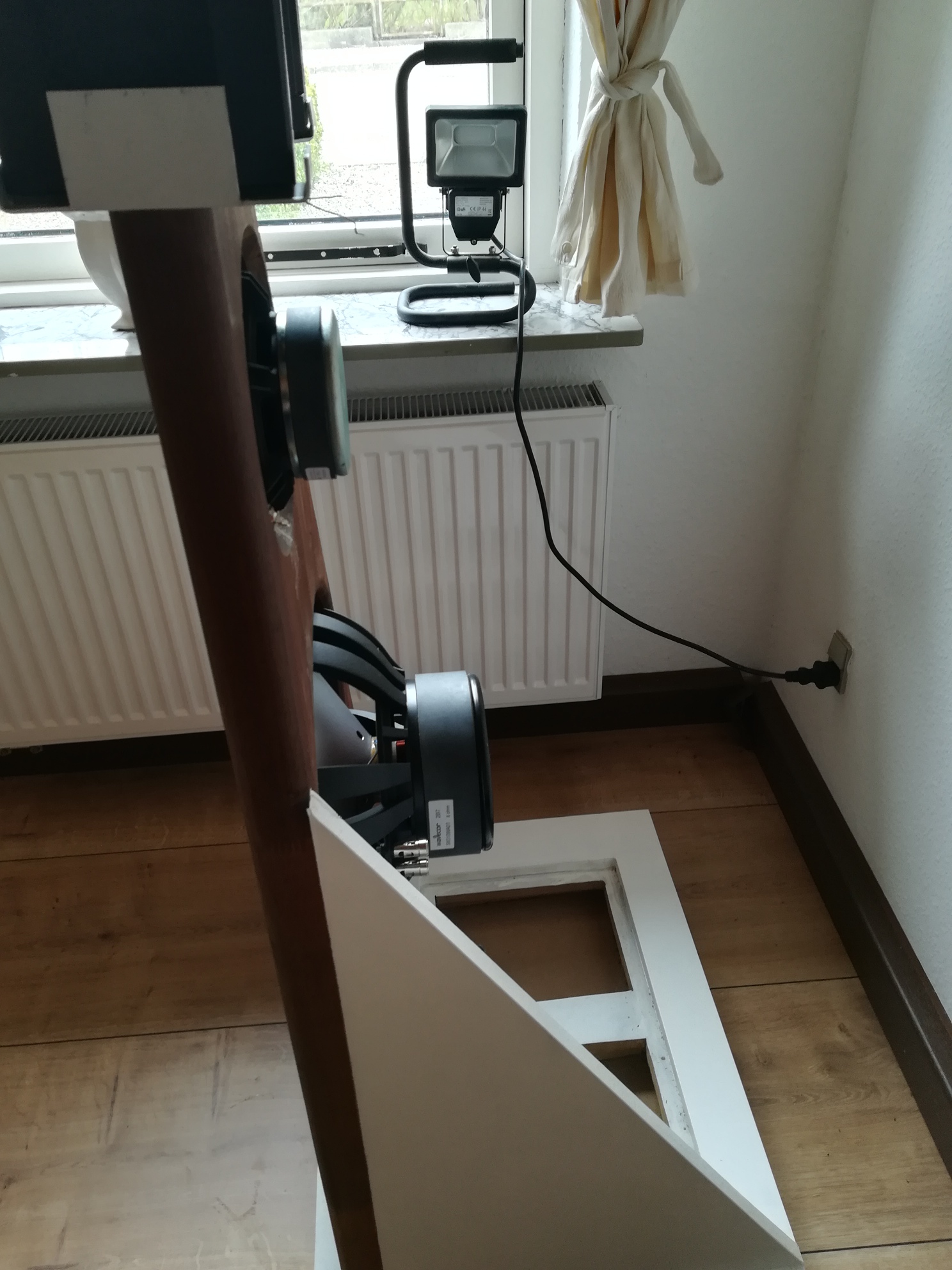

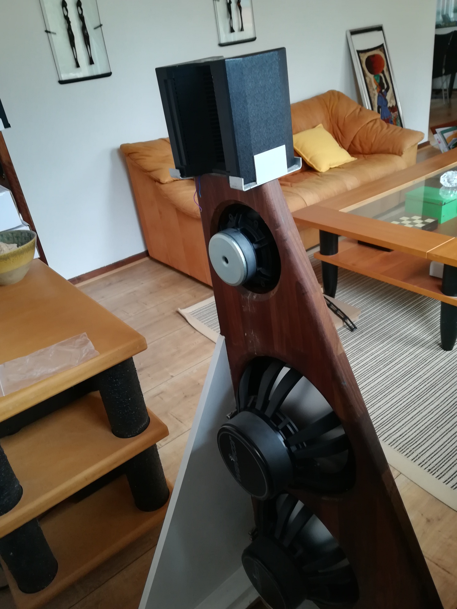

The reason for the choice of woofer is the specs.
Wavecor SW310WA01
High Xmax: +/- 11,5 mm
Low Fs: 28 Hz
OK Qts: 0,53
It can move a lot of air, and it can play down low.
It can actually play up til 1250 Hz with a steep low pass fiilter
