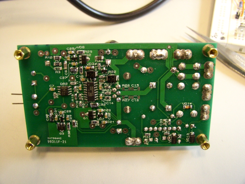

Hi everybody,
Here is the PCB file of the amp. Unfortunately i am far from home and do not have the etched PCB file with me. However while digging my new computer i found a folder wihich was including the backups of my PCB software. I do not have time to complete it again. Although it is not the complete, it is still can be usefull or even can be etched. Please pay attention to the power supply lines if you intend to etch this one. You must ensure a connection from top to bottom copper to get it working properly. Some end corrections may be necessary( a resistor between the ics etc.). If you are not experienced do not try to do it!
Best wishes,
Ferda

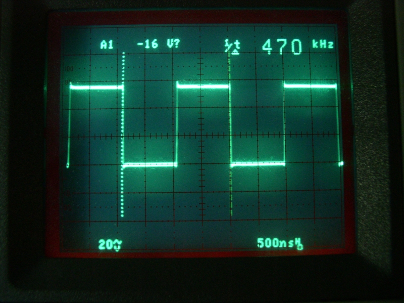

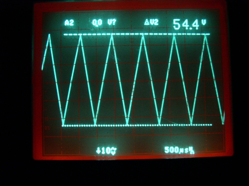

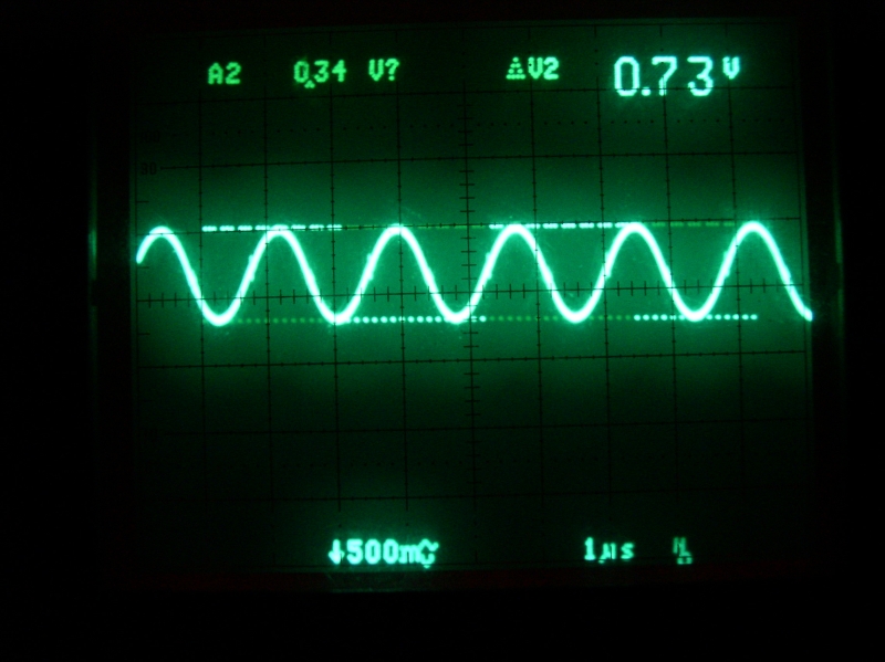

Yet another version of Cakeamp
Hello All,
I'm glad that I have made a version of Bender's Cakeamp by modifying the power supply to gate driver, preamp and a DC output protection added. Attached are the traces with no load attached and the amp.
I'm going to post more traces when I have the dummy load.
Hello All,

Nice PCB gogowatch,
Congratulations, i will be happily expecting you're measurments

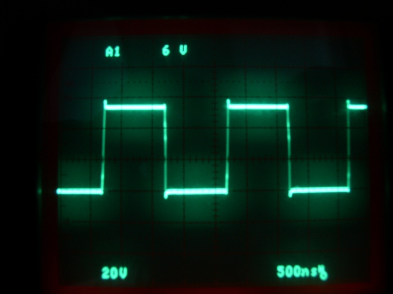

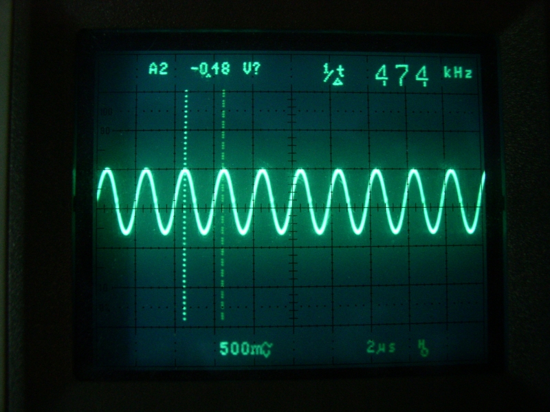

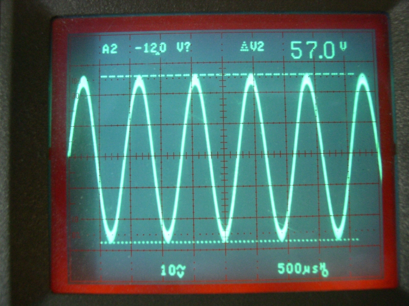

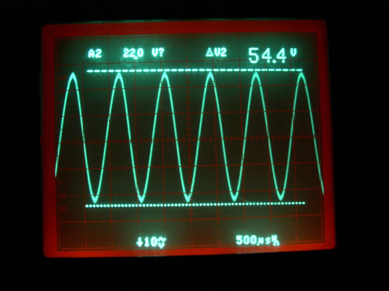

Thanks Workhorse and Savu.
Attached are traces with 4R resistive loading. Switching frequency changed from 470kHz to 510kHz.

Super nice work gogowatch. Like the PCB layout a lot
Seems you still have a little bit of ringing on the sqares.
Do you yse subbers on the fets? If so the walues might have to be changed a little to reduce the ringing. But then again, it dosen't seem to be a problem.
Really nice output waveform (55 Vpp is around 95 W in 4 ohm), not bad at all 🙂
BR Baldin
BR Baldin
I think that much ringing is normal, since the frequency is around 500k a little bit of snubber tweaking is needed as Baldin pointed out.🙂

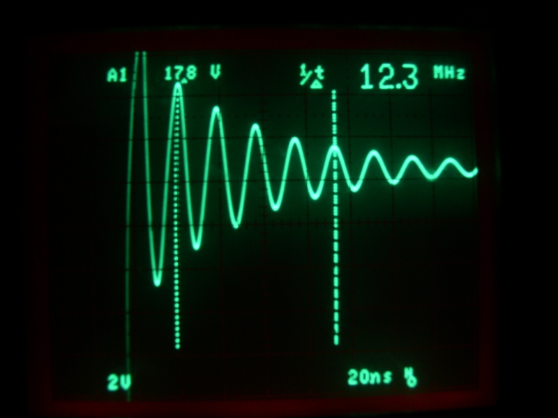

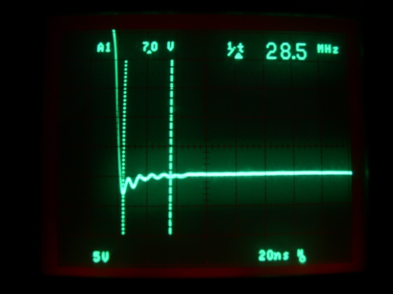

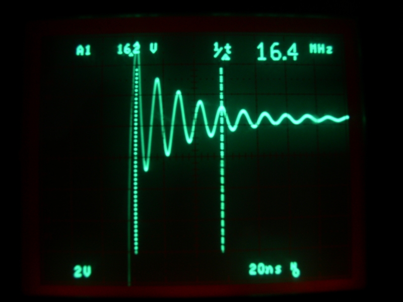

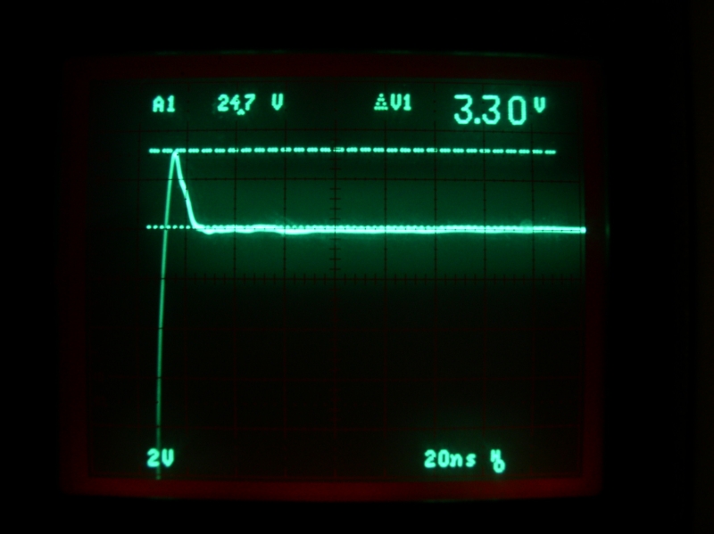

Adding snubber for lower mosfet
Thanks Whortless.
In order to add snubber, I've done some measurement by adding 100pF, 220pF and watch the changes of the ringing signal and then calculate the Resistance and Capacitance in the snubber.
I did it for the lower mosfet snubber first. Following are the traces,
1. Ringing at rising without snubber, 24.7*4 = 98.8MHz
2. Ringing at rising with 100pF, 16.4*4 = 65.6MHz
3. Ringing at rising with 218pF, 12.3*4 = 49.2MHz
4. Final rising edge waveform with 218pF+24R
Nice PCB! Congratulations Gogowatch!
Thanks Whortless.

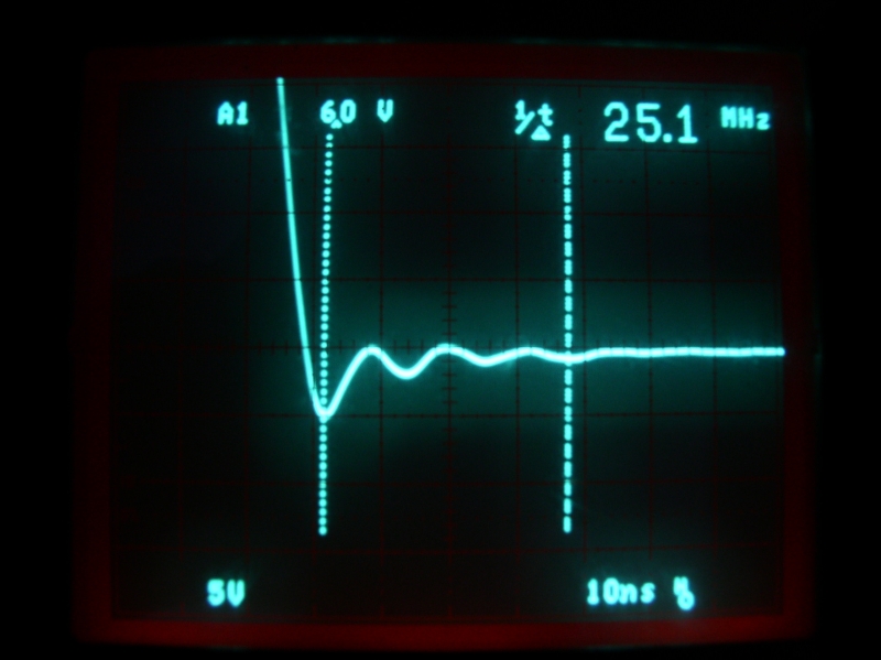

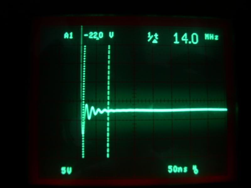

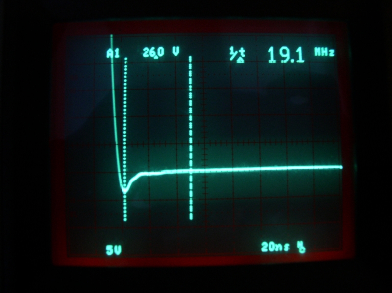

Adding snubber for upper mosfet
Following are for the upper mosfet,
1. Ringing at falling without upper mosfet snubber, 28.5*4 = 114MHz
2. Ringing at falling with 100pF, 25.1*3 = 75.3MHz
3. Ringing at falling with 218pF, 14*4 = 56MHz
4. Final falling edge waveform with 218pF+18R

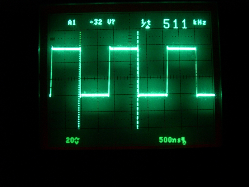

Snubber added
1. Before snubber added.
2. After snubber added.
The snubber killed the ringing but not the overshoot or undershoot. I don't want to change the Rgate at the moment. So I stop the tuning at this point.
Edit: reference http://focus.ti.com/lit/an/slup100/slup100.pdf
Thats what they do, they eliminate ringing only.😀
